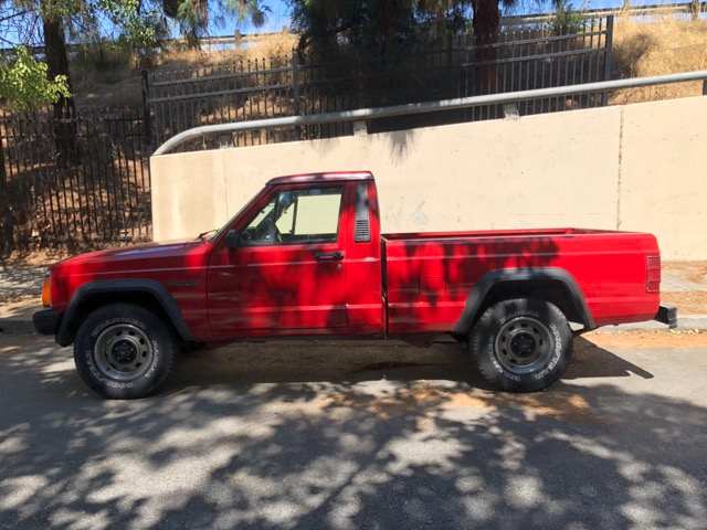

December 2025 - Old Red: A California Cruising and Camping Comanche
89 MJ
December 2025 - Old Red: The Story of a California MJ
Owned by @NickyV
Build Thread-
I just started a build thread -- took me way too long. I will be updating it soon, but in the meantime, here are some of my projects.

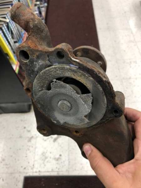

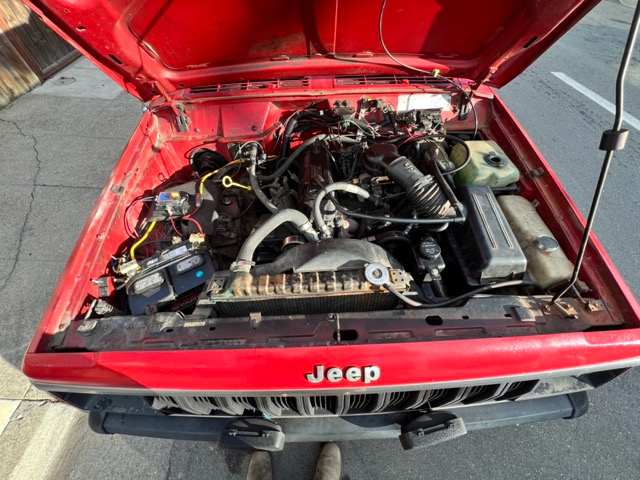

It might be the factory radiator. I'm not sure. But I have replaced two thermostats. And the very first under-the-hood project I tackled was replacing the thrashed water pump.
Electrical/Ignition-
Ignition is mostly stock, although I had to replace the starter back in 2021.

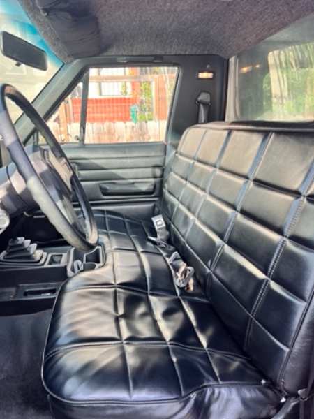

All black vinyl interior (including the floor... no carpet). Bench seat.
The interior of the cab is where I've done most of the work. And there was a LOT of work to be done. My truck didn't even have a cigar lighter when I bought it!

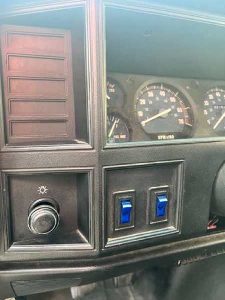

Switches (Fog Lights & Camper Shell)

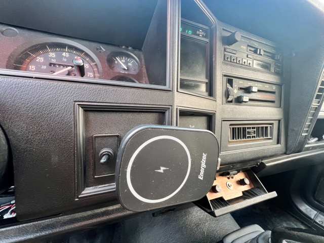

Tech: Audio Input Switch & Wireless Charging

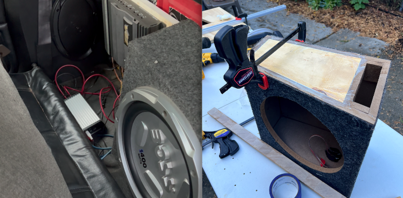

Here is a list of audio upgrades I've made since buying the truck:
  1. Door Speakers (cut holes in the door cards myself)
  2. New 6x9s in the pillars
  3. OEM style tweeters (Jensen Accusound pulled from a junkyard XJ)

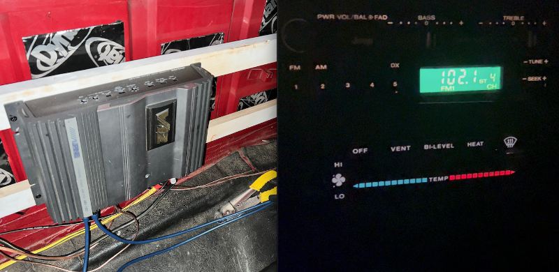

  4. Two amplifiers, both mounted on wooden rails that I attached to the trim studs behind the bench seat. One amp runs the 6x9s, door speakers, and tweeters (door and tweeters wired in parallel). The other amp runs a single sub, positioned behind the bench in the middle. It sounds pretty good in there, if I do say so myself.

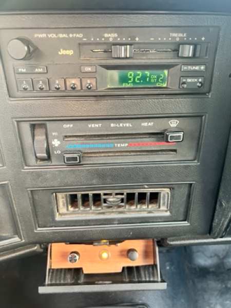

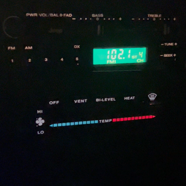

I've got a factory radio that I pulled from a junkyard Cherokee. It's an AR-7750, with no cassette deck and the bass/treble faders.

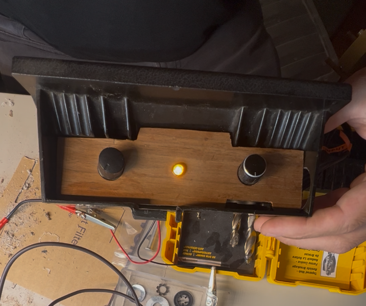

I have the radio and a Bluetooth receiver (hardwired) running through a two-channel RCA selector. Switch is in the dash. I'm still working on a video/writeup about that, which I will add to my build thread! But here's a little sneak peek... I used my ash tray to hide some of my stereo controls. I installed an in-line RCA volume pot to control the Bluetooth volume, and I put a remote bass controller in there as well -- along with an LED that lights up when the headlights are on.

And I recently replaced all my turn signals and running lights with LEDs (including the reverse lights). I'm planning to try halogen first before considering going LED on the headlights. I rarely drive the truck in the snow, but if I do get caught in snow storm, I want to be able to see.
I highly recommend converting your turn signals and backup lights to LED. Not only are they brighter... Switching out the two-prong turn signal relay for a three-prong LED relay greatly improved my blink rate. I think you could fix this by cleaning up certain grounds, but it was a nice bonus of the swap. Now my turn signals flash brightly and frequently and I'm a lot more confident that people know I'm planning to merge.

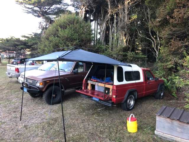

As you may have noticed, I have a camper shell. I still have a lot of work to do on that thing... I've got grand plans! All in due time.
But as of now, I have done two important upgrades.
First, I wired up the third brake light. I could have gotten a kit with a special relay, but I just decided to piggy-back a long wire onto my brake pedal. Ran it through the firewall and all the way back to the third light. Works like a charm!
Second, I installed a custom switch in the dash (probably where the cargo light switch would be) that allows me to turn the dome light of the camper on and off from the cab. I still need to figure out how to make it a three-way switch with a second switch in the camper. Still brainstorming the best way to do that with the least amount of wiring.
