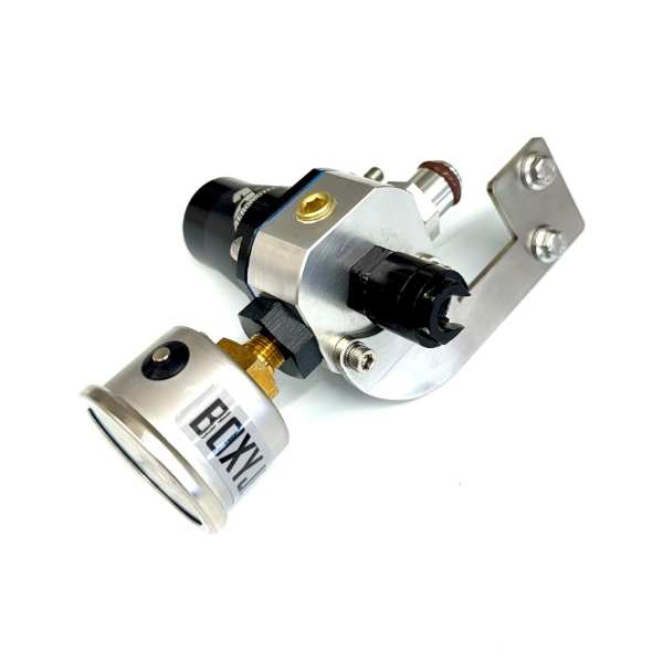

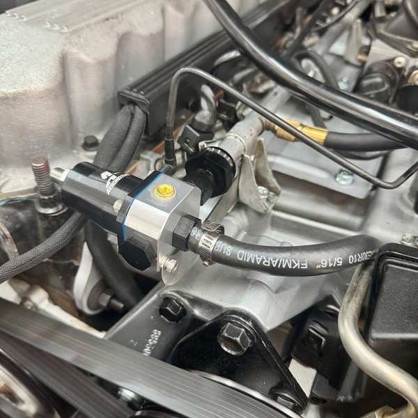

boxyjeep Posted November 1, 2025 Share Posted November 1, 2025 Thought you guys would appreciate a sneak peak of a kit we are working on for an adjustable fuel pressure regulator for Renix 4.0L. Inspired by this thread and the fact that the Hesco unit is trash, we came up with our own solution. Will have a video up soon with an overview of what's required, but this has resulted in my 4.6L Renix stroker running really well, without the need for an adjustable MAP sensor (which is actually a pretty poor solution). Overview video (please subscribe!): Link to comment Share on other sites More sharing options...

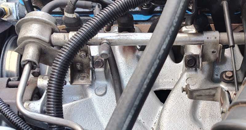

boxyjeep Posted November 1, 2025 Author Share Posted November 1, 2025 Just now, Eagle_SX4 said: That is really cool. I kept my Renix fuel rail when I swapped in a 98+ manifold. If I ever have fuel pressure issues. This will be the solution. How'd you pull that off? From my understanding the fuel rail bolt holes are in different locations from HO to Renix... Link to comment Share on other sites More sharing options...
Eagle_SX4 Posted November 1, 2025 Share Posted November 1, 2025 Just now, boxyjeep said: How'd you pull that off? From my understanding the fuel rail bolt holes are in different locations from HO to Renix... Yes the bolt holes don't line up so I cut the center 2 feet off and welded some 90 degree brackets on them and it works very well. Link to comment Share on other sites More sharing options...
boxyjeep Posted November 1, 2025 Author Share Posted November 1, 2025 Just now, Eagle_SX4 said: Yes the bolt holes don't line up so I cut the center 2 feet off and welded some 90 degree brackets on them and it works very well. Nice! I'm impressed. Link to comment Share on other sites More sharing options...
Eagle_SX4 Posted November 1, 2025 Share Posted November 1, 2025 I was going to use a '93 fuel rail but I didn't want to make new fuel lines. The Renix fuel rail also runs cooler due the full circulation of fuel and shouldn't vapor lock as easily. Link to comment Share on other sites More sharing options...
