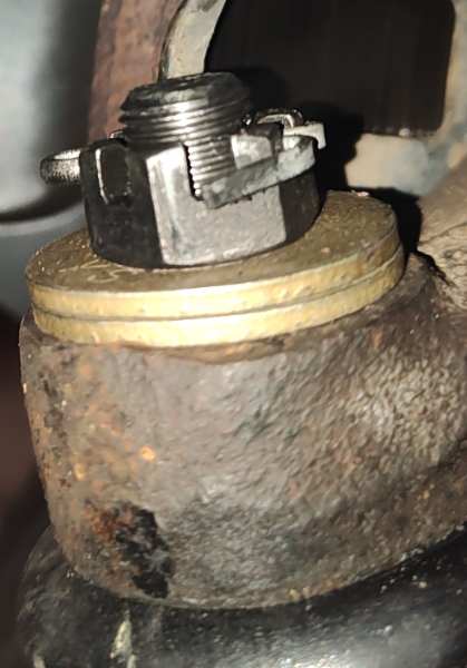

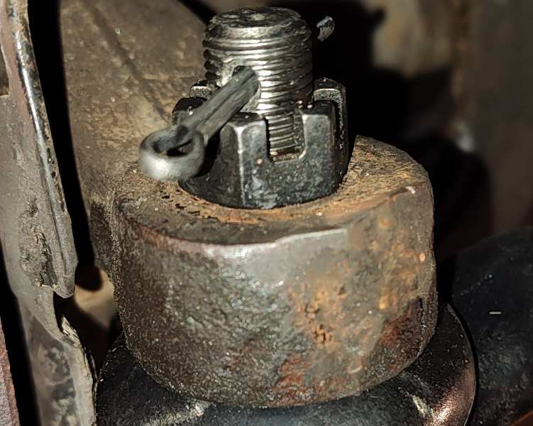

Eagle_SX4 Posted August 15 Share Posted August 15 I just replaced my drag link and tie rod ends on my truck and tightened everything up and went to put the cotter pins in place and the castle portion of the nut is below the cotter pin hole. How do I fix this? Maybe drill a new hole? Or are my the tapers in my spindle stretched somehow? Link to comment Share on other sites More sharing options...
eaglescout526 Posted August 15 Share Posted August 15 Could always put a washer or two in to get the castle nut where it needs to be. I have noticed this issue on new joint parts these days. Link to comment Share on other sites More sharing options...
derf Posted August 15 Share Posted August 15 Yep. They're substituting some parts with others that are close but not quite right. Stack a couple of washers to get the nut up where it needs to be. Grade 8 would be better. Less likely to deform. Link to comment Share on other sites More sharing options...
Eagle_SX4 Posted August 15 Author Share Posted August 15 Found some grade 8 washers to make up the difference thanks for the replies. Link to comment Share on other sites More sharing options...
coolwind57 Posted August 15 Share Posted August 15 We use washers all the time in Aviation to make up the difference. The use of varying Washer thicknesses can be quite the puzzle to solve when you're torque specs are tight and that damn hole just does not want to line up. Link to comment Share on other sites More sharing options...
75sv1 Posted August 15 Share Posted August 15 I've stacked washer too. I also found some castle nuts of different heights. Link to comment Share on other sites More sharing options...
JZLAJeep Posted August 15 Share Posted August 15 Lock nut instead? Link to comment Share on other sites More sharing options...
AZJeff Posted August 16 Share Posted August 16 Hardened washers are the way to go here. Or, as others mentioned, self-locking nuts. Newer vehicles have moved away from castellated nuts to self-lockers, to simplify production, so I would feel confident in that solution. Link to comment Share on other sites More sharing options...
