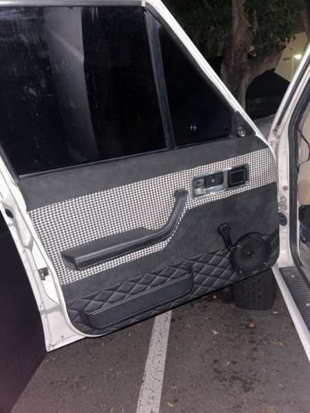

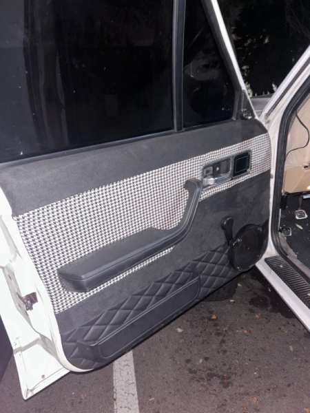

Aidenmoreno3 Posted August 10, 2025 Share Posted August 10, 2025 Good afternoon guys! wanted to share some progress I made with my custom interior I’m trying to build and this is kinda the first big step. I always hated the basic look of the Comanche interiors and wanted to make something of my own. After 2 weeks of gathering fabrics, glue, 8 long hours of work, and hand sewing the fabrics for one door card, I have made my drivers side not boring! I’ll be doing the same thing to the passenger side tomorrow and probably won’t have time to complete it but we’re making progress! I'm trying to figure out how to make the standard crank handle fit and I think I’m just gonna have to make a strait cut in it and shorten it about 1/2in, plastic welding it back into place. Link to comment Share on other sites More sharing options...

Aidenmoreno3 Posted August 10, 2025 Author Share Posted August 10, 2025 13 hours ago, ghetdjc320 said: Looking good. Did you use the replacement door card panels or your old ones? No I got some 1/4in hardboard from Home Depot and traced the one ones onto it for a more rigid and durable door panel Link to comment Share on other sites More sharing options...

JZLAJeep Posted August 11, 2025 Share Posted August 11, 2025 19 hours ago, Aidenmoreno3 said: No I got some 1/4in hardboard from Home Depot and traced the one ones onto it for a more rigid and durable door panel That's really cool. How did you do the curved part at the top of the door? Link to comment Share on other sites More sharing options...
Billy Darson Posted October 3, 2025 Share Posted October 3, 2025 On 8/11/2025 at 7:56 AM, JZLAJeep said: That's really cool. How did you do the curved part at the top of the door? On the backside of the door card, the original "board" material is stapled to a rounded piece of plastic (abs?) that seats into the top trim channel lip under the front corner of the window. Link to comment Share on other sites More sharing options...
