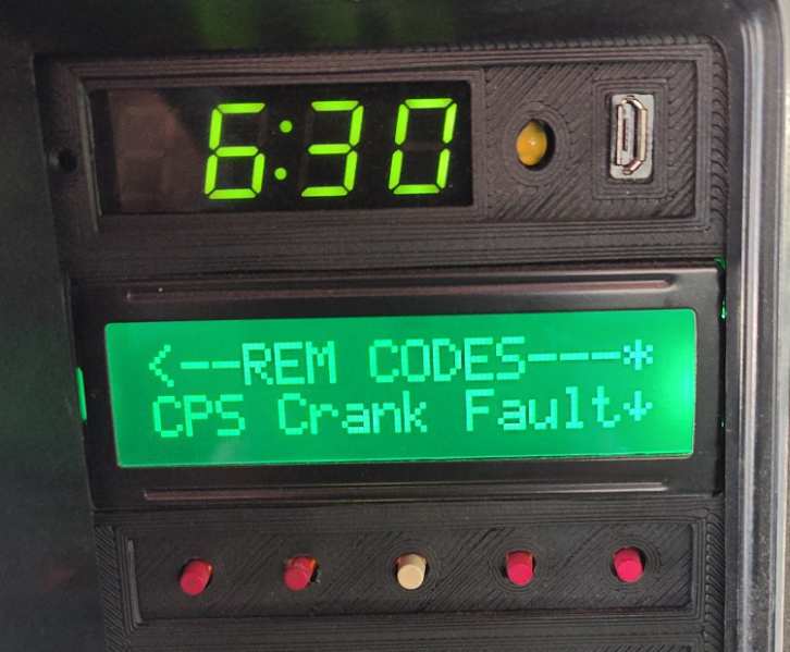

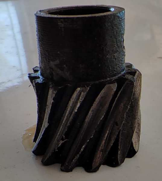

Eagle_SX4 Posted July 27, 2025 Author Share Posted July 27, 2025 I replaced the CPS today and it still didn't start. I tested the new CPS with my volt meter and was getting about .53 AC volts. So it tested good. The rem code "CPS Crank Fault" occurs because the computer doesn't see any rpm while cranking. Which in most cases is the CPS but in rare occasions like mine when the distributor is not turning it throws the same code. This is the description of that code from https://nickintimedesign.com/rem-codes-description/ CPS Crank Fault: No Engine RPM Detected after 3 seconds of starter engagement. Possibly faulty CPS, engine cranking speed too low. On a hunch I was watching the SYN readout on the REM and it was not spinning while cranking. About 5 months ago I replaced the cam gear on the distributor because it was being ground down by the cam. I pulled the distributor out and the cam gear I put on has been ground down worse than before and now there is no teeth on the cam gear for the cam shaft to grab. So this means I will need at minimum a distributor gear but that will probably get chewed up as well. An engine rebuild looks to be in my near future with all of that destroyed cam gear going through the oil. Link to comment Share on other sites More sharing options...
eaglescout526 Posted July 27, 2025 Share Posted July 27, 2025 How is the engine eating up the distributor gears? This would have to mean you’d be getting very little oil pressure too until it just stops like how it did on you. Link to comment Share on other sites More sharing options...
Eagle_SX4 Posted July 27, 2025 Author Share Posted July 27, 2025 8 hours ago, eaglescout526 said: How is the engine eating up the distributor gears? This would have to mean you’d be getting very little oil pressure too until it just stops like how it did on you. I don't know the cause of the issue. Based on how much oil is getting into my air filter I know my oil pump is functioning. However I haven't hooked up a mechanical oil pressure gauge to verify that the oil pressure gauge in my cluster is correct. The one in my cluster was showing about 45 psi cold and about 20 psi hot. But to test it I need to get another distributor. Link to comment Share on other sites More sharing options...
ratrapp Posted July 27, 2025 Share Posted July 27, 2025 is the cam gear chewing up as well?unfortunatly think about where the metal from the gear has went through the engine,twice now. Link to comment Share on other sites More sharing options...
Eagle_SX4 Posted July 28, 2025 Author Share Posted July 28, 2025 I swapped in a newly acquired junkyard distributor just to see if I could get it running and it still won't start. I did properly index it after finding TDC. After not starting I tried rotating the distributor 180 degrees to see if I had TDC on the wrong stroke but it still didn't help so I switched it back to how it was when I indexed it. The rem still shows CPS Crank Fault. I double checked the CPS with my voltmeter and it says I am getting .57 volts AC. And about 215 ohms between the 2 wires on the CPS. I then checked for continuity on the CPS wires to the computer and both wires have 0 resistance between the engine bay plug and the computer plug. I then swapped the computer with a known good computer and the problem is still present. The CPS Crank Fault rem code keeps coming back when cranking. The next step is to order another CPS and see if a different one fixes my issue. Link to comment Share on other sites More sharing options...

Eagle_SX4 Posted August 1, 2025 Author Share Posted August 1, 2025 Also if any one was wondering this is what the distributor gear looks like that got chewed up. I pulled it off and turned the old distributor into an oil pump primer. Link to comment Share on other sites More sharing options...
Eagle_SX4 Posted August 1, 2025 Author Share Posted August 1, 2025 I just tried the 3rd new CPS and it still won't start. Measures .54 volts AC while cranking. I really need some help with this. REM still shows CPS Crank fault. I checked the continuity of the wires for the CPS to the computer and they were 0. Ohms so those are good. What else can I check? Link to comment Share on other sites More sharing options...

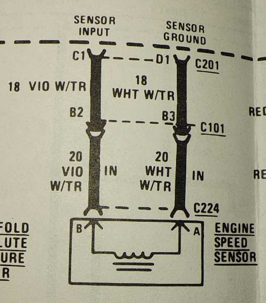

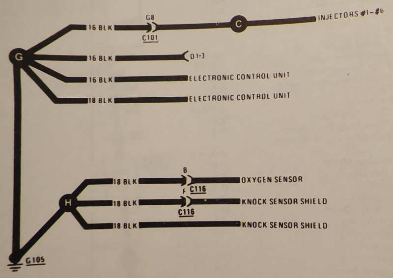

Eagle_SX4 Posted August 2, 2025 Author Share Posted August 2, 2025 33 minutes ago, Ωhm said: With both CPS and ECU disconnected, each wire has continuity, each wire is NOT STG, but could each wire be shorted together? I don't think so I didn't have my wire diagram with me so I just tested all the pins at the computer connector to find which ones were connected to the CPS. Only one pin connected with each wire. C1 and D1. I found my wire diagram and found out the sensor is actually called the Engine Speed Sensor not the Crank Position sensor which I find odd. I will test tomorrow to see if the computer is grounding the white wire when cranking. Does any one know where the ECU ground is at? I can't find mention of it anywhere. Edit: found it on the diagram the ECU is grounded at G105. Where is that? Link to comment Share on other sites More sharing options...
Eagle_SX4 Posted August 2, 2025 Author Share Posted August 2, 2025 Looks like the ECU shares the ground with the fuel injectors, oxygen sensor and knock sensor. According to Cruiser54's notes it grounds at the engine block near the dipstick. I will clean and refresh that ground and the ground strap that goes to the body up by the wiper motor and maybe I will have a running truck again. Link to comment Share on other sites More sharing options...

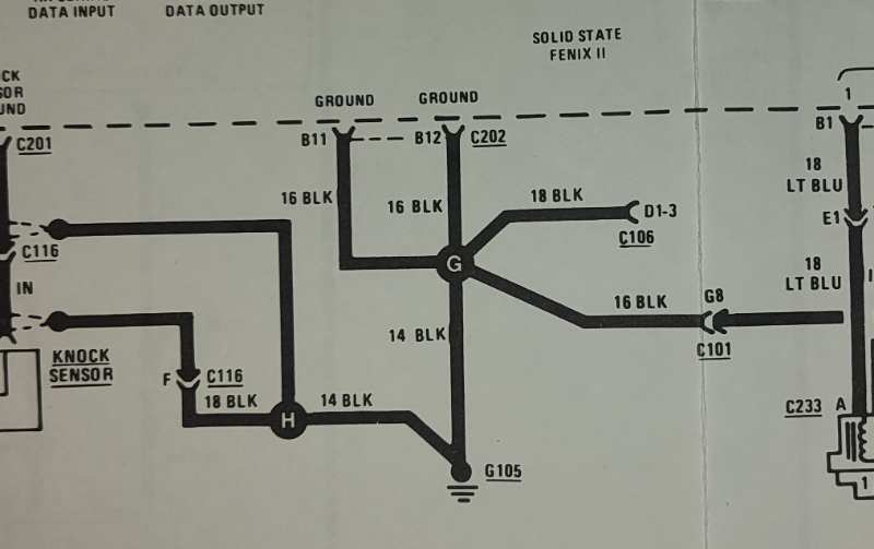

Ωhm Posted August 2, 2025 Share Posted August 2, 2025 88ElectricalManual still calls it a Engine Speed Sensor, but changed the ECU verbiage to ENGINE SPEED INPUT. C201_D1 at ECU is NOT sensor ground as shown in the 87ElectricalManual. Link to comment Share on other sites More sharing options...
Eagle_SX4 Posted August 2, 2025 Author Share Posted August 2, 2025 47 minutes ago, Ωhm said: 88ElectricalManual still calls it a Engine Speed Sensor, but changed the ECU verbiage to ENGINE SPEED INPUT. C201_D1 at ECU is NOT sensor ground as shown in the 87ElectricalManual. To verify if C201_D1 is ground as shown in the 87 diagram it should be connected to either C201_B11 or C201_B12 with the ECU unplugged. I will test that theory tomorrow. Link to comment Share on other sites More sharing options...
