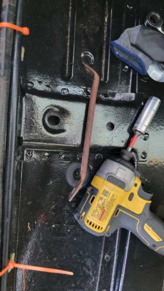

coheed Posted April 30, 2025 Share Posted April 30, 2025 Putting my interior back together and can't remember where this brace rod goes. I've got the 2 that go from the column to the left in, just don't know where this one goes. Link to comment Share on other sites More sharing options...

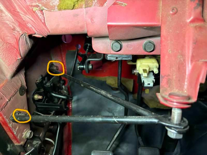

Gojira94 Posted May 1, 2025 Share Posted May 1, 2025 These are the only 2 I've ever seen on an XJ or MJ. Is that one possibly an extra from a donor? Link to comment Share on other sites More sharing options...
coheed Posted May 1, 2025 Author Share Posted May 1, 2025 It's a different length and angle than both of those. Really scratching my head on where I removed this thing from. Changed the title to describe it better Link to comment Share on other sites More sharing options...
Pete M Posted May 1, 2025 Share Posted May 1, 2025 kinda looks like a mirror bracket off a CJ or something. Link to comment Share on other sites More sharing options...
The86manche Posted May 1, 2025 Share Posted May 1, 2025 Its definitely a steering wheel brace. I think my 86 had 3 i just can't find a good photo of them mounted.. Link to comment Share on other sites More sharing options...
coheed Posted May 1, 2025 Author Share Posted May 1, 2025 I'll root around in my 86 parts manual to see if I can figure it out. I sorta remember removing it from the column, but that was a few months ago, and it was also in my pile of steering column parts Both of the inner fender braces are installed so I know it's not one of those Link to comment Share on other sites More sharing options...
coheed Posted May 2, 2025 Author Share Posted May 2, 2025 So I spent an hour combing through the parts manual and could figure out where it goes. I also spent about an hour or so looking at as many pictures I could find of 86 MJs to see if I could find a good one from under the steering column and couldn't. I distinctly remember removing the arm and thinking "why is it so much rustier than the other 2" so I'm fairly convinced it's a steering column brace. Could anyone with an 86 grab a shot under the dash to see if you have a 3rd brace installed? Link to comment Share on other sites More sharing options...

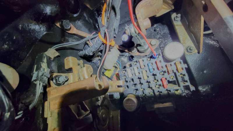

coheed Posted May 3, 2025 Author Share Posted May 3, 2025 Was under the dash today and figured out it's actually a brace for the clutch master cylinder. I assume these are only on 84-86 years since the later clutch cylinders have vertical mounting holes as opposed to horizontal ones. Although I can't find mention of it in my 84-86 parts manual . I'll leave this picture here to hopefully help someone in the future. Link to comment Share on other sites More sharing options...
