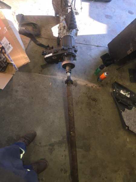

Muncher Posted November 21, 2025 Author Share Posted November 21, 2025 Transmission pulled never had one go so smooth! Snapchat-281922976.mp4 Link to comment Share on other sites More sharing options...

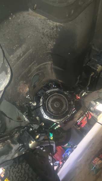

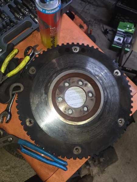

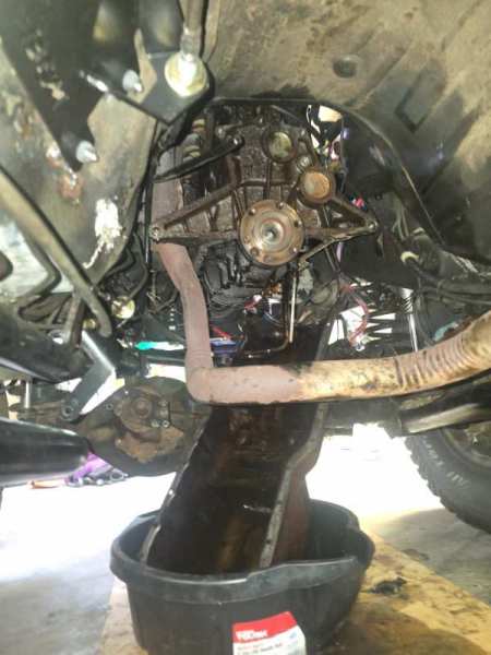

Muncher Posted November 24, 2025 Author Share Posted November 24, 2025 Oil pan gasket and rear main seal done. Next is getting the flywheel re surfaced and making the newer closed system slave master cylinder work with the renix pedals. Snapchat-818441204.mp4 Link to comment Share on other sites More sharing options...

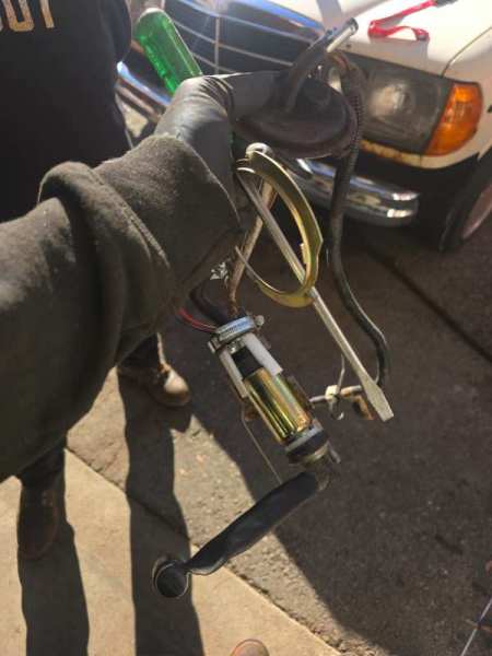

Muncher Posted November 27, 2025 Author Share Posted November 27, 2025 New fuel pump and clock ring in hopefully that fixes my power loss issue. Also got the t case and transmission all bolted together ready to go in of course I forgot a pilot bearing puller so itll have to wait till tommrow. Link to comment Share on other sites More sharing options...
neohic Posted November 27, 2025 Share Posted November 27, 2025 58 minutes ago, Muncher said: … of course I forgot a pilot bearing puller… Bread… grease… soap… all work well for getting pilot bearings and bushings out. Link to comment Share on other sites More sharing options...
Muncher Posted November 27, 2025 Author Share Posted November 27, 2025 5 minutes ago, neohic said: Bread… grease… soap… all work well for getting pilot bearings and bushings out. Yeah ive tried those all always just end up making a mess. Link to comment Share on other sites More sharing options...

hgeranium Posted December 2, 2025 Share Posted December 2, 2025 On 11/18/2025 at 7:45 PM, Muncher said: New Bosch fuel pump and lock ring/o ring which hopefully is the end to my stuttering issue basically everything electrical is new now besides the coil, ignition module and cps. Of course my slave cylinder decided to die before I could even make it run right so ordering parts for a ax15 swap tonight Have you checked fuel pressure before you replaced the pump? I recently started having a very similar issue and it turned out to be a bad fuel pump where the PO didn't put a strainer on. My fuel pressure at the rail was a few PSI low beforehand, and was exactly at 31psi at idle and 39psi with the FPR vac line removed. Link to comment Share on other sites More sharing options...
Muncher Posted December 2, 2025 Author Share Posted December 2, 2025 55 minutes ago, hgeranium said: Have you checked fuel pressure before you replaced the pump? I recently started having a very similar issue and it turned out to be a bad fuel pump where the PO didn't put a strainer on. My fuel pressure at the rail was a few PSI low beforehand, and was exactly at 31psi at idle and 39psi with the FPR vac line removed. My fuel pressure was good before hsnd but my power issue is only happening while driving so its impossible to check while driving without making some elaborate fuel pressure gauge Link to comment Share on other sites More sharing options...
hgeranium Posted December 2, 2025 Share Posted December 2, 2025 2 minutes ago, Muncher said: My fuel pressure was good before hsnd but my power issue is only happening while driving so its impossible to check while driving without making some elaborate fuel pressure gauge Mine was the same way. It idled great and only had driving issues when it warmed up. A bad pump will worsen with heat. Were you getting the correct aforementioned PSI? I was only 3PSI off at idle so God knows how low I was when it warmed up. Link to comment Share on other sites More sharing options...
Muncher Posted December 2, 2025 Author Share Posted December 2, 2025 6 hours ago, hgeranium said: Mine was the same way. It idled great and only had driving issues when it warmed up. A bad pump will worsen with heat. Were you getting the correct aforementioned PSI? I was only 3PSI off at idle so God knows how low I was when it warmed up. It was correct at idle completely i replaced the pump with a new bosch still have the same issue Link to comment Share on other sites More sharing options...

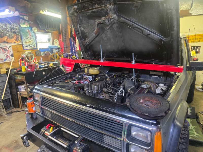

Muncher Posted December 14, 2025 Author Share Posted December 14, 2025 Quick engine swap new radiator and rad bushings. 2.5l overflow installed xj engine installed did a new decent muffler install super 40 sounds great. Seems to be running snd driving good now just have to put my interior back together Snapchat-88415080.mp4 Link to comment Share on other sites More sharing options...
89 MJ Posted December 14, 2025 Share Posted December 14, 2025 That 2.5L overflow is really good. I think it’s the best option for these trucks. Link to comment Share on other sites More sharing options...
Muncher Posted December 14, 2025 Author Share Posted December 14, 2025 11 minutes ago, 89 MJ said: That 2.5L overflow is really good. I think it’s the best option for these trucks. I like it ill like it more when I get rid of the factory air box. I like drivers side over flow better then passanger though too much going on over there for a over flow bottle as well. Link to comment Share on other sites More sharing options...

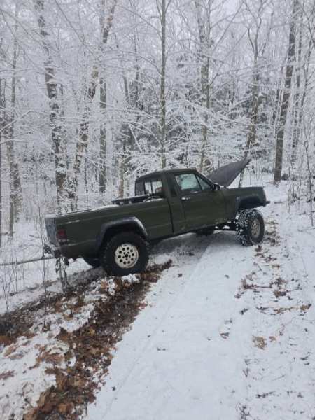

Muncher Posted December 16, 2025 Author Share Posted December 16, 2025 Driven too work two days now after the swap and took it down a trail seems to be doing pretty good. Link to comment Share on other sites More sharing options...
watchamakalit Posted December 16, 2025 Share Posted December 16, 2025 10 hours ago, Muncher said: 10 hours ago, Muncher said: Driven too work two days now after the swap and took it down a trail seems to be doing pretty good. Isn't hard to see where your going on the trail when the hood is open? Link to comment Share on other sites More sharing options...
Muncher Posted December 16, 2025 Author Share Posted December 16, 2025 Just now, watchamakalit said: Isn't hard to see where your going on the trail when the hood is open? Yes it is. Luckily I wasnt going anywhere hard to tell but I was half slid down about a 10 foot embankment Link to comment Share on other sites More sharing options...

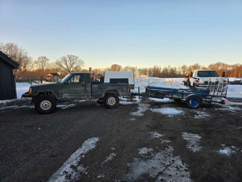

Muncher Posted February 5 Author Share Posted February 5 Little bit of a heavy haul. Yes the load is terrible but trying to stand a lift column the other way around would of been impossible Snapchat-1340904218.mp4 Link to comment Share on other sites More sharing options...
