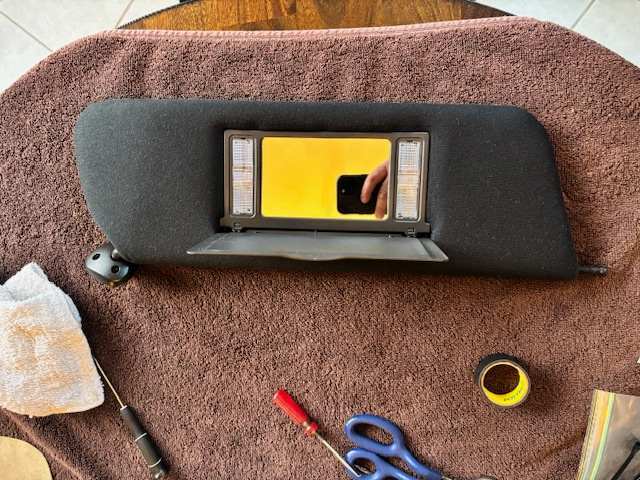

Gjeep Posted February 28, 2025 Author Share Posted February 28, 2025 Got the upholstery cleaned up yesterday and letting it dry in the sun over the next couple days. This near 40 year old upholstery was for the most part spotless. Link to comment Share on other sites More sharing options...
