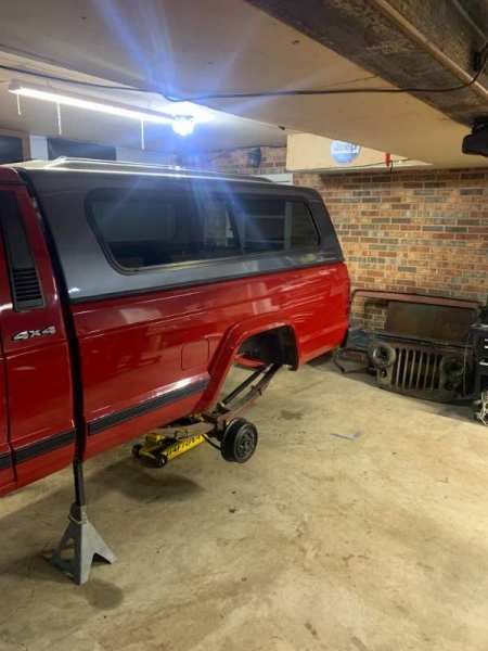

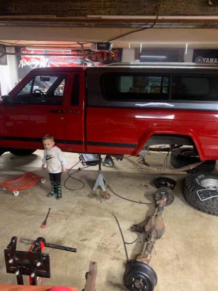

Brakes Update
Comanche rear brakes are coming along. The wheel cylinder bolts on both sides stripped immediately.... Tried using my PROTO extractors with no luck. First time I have seen this bolt extractor sockets not work. Ended up using a cut off wheel to remove the bolt head.
The brake lines on both side also twisted in half from the fitting being seized onto them. Made new brake lines for the rear with my tubing bender and flare tool.
Now I just need to put the shoes and springage on.
Rear Drums brakes have new shoes, springage, wheel cylinders, brake lines, and drums. I thought about not doing this job because I have plans to swap the dana 35 out for either a dana 44 or Ford 8.8, but I am not sure how long it will take for me to find a good swap candidate.
