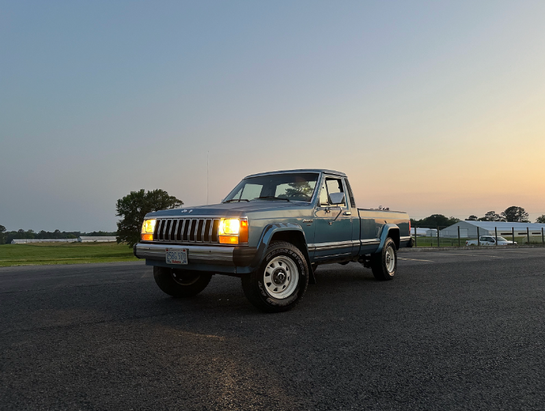

ThreeComanches Posted February 14 Author Share Posted February 14 Ladies and gentlemen, after almost 2 years of searching for parts, browsing forums far and wide, turning lots of wrenches, and lots of frustration... The Alabama Turbo Diesel rides again! The whole time on the first test drive, I was smiling like a dog. It's kinda hard to believe it really moves after sitting for 21 years per the last inspection sticker There are still some things left to do. Like interior, body work, exhaust. But I'm just over the moon that she finally drives again. Thanks to each and every one of ya'll that helped me out along the way. I wouldn't have made it this far without ya'll. Link to comment Share on other sites More sharing options...
Salvagedcircuit Posted February 14 Share Posted February 14 14 hours ago, ThreeComanches said: Ladies and gentlemen, after almost 2 years of searching for parts, browsing forums far and wide, turning lots of wrenches, and lots of frustration... The Alabama Turbo Diesel rides again! The whole time on the first test drive, I was smiling like a dog. It's kinda hard to believe it really moves after sitting for 21 years per the last inspection sticker There are still some things left to do. Like interior, body work, exhaust. But I'm just over the moon that she finally drives again. Thanks to each and every one of ya'll that helped me out along the way. I wouldn't have made it this far without ya'll. Boo yah! Excellent work! Now to get a little more road time! Link to comment Share on other sites More sharing options...
