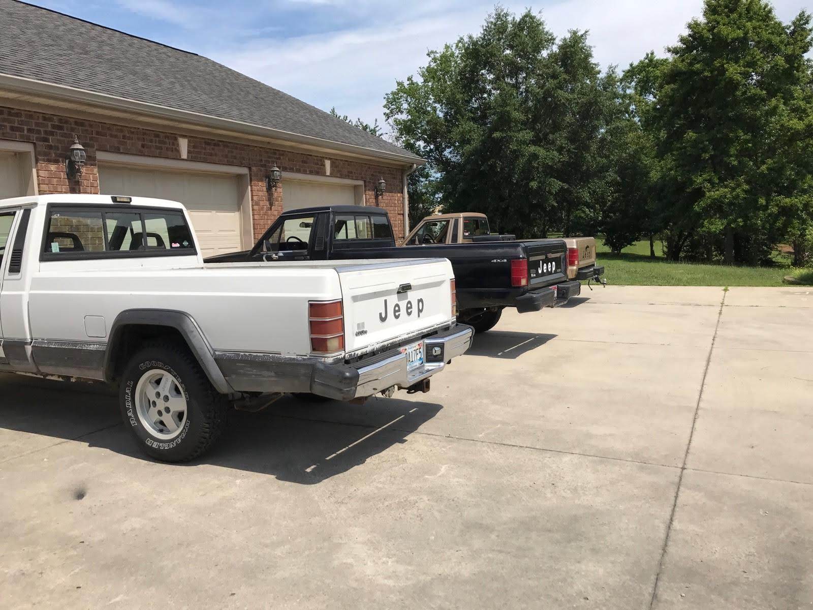

Ladies and gentlemen, for the first time since September of 1995... the Mississippi Turbo Diesel rides again! After looking in the registry, I also found out this is the latest built factory diesel Comanche. It might even potentially be the last one. This one took about a year and a half to get back on the road and I still got plenty more to do to it cosmetically. Even then. it's a thrill to have another one of these rarities back on the road. I also included a picture of the last inspection sticker. Funny enough, Mississippi doesn't have vehicle inspections anymore! Haha
So a lot of progress has been made... I finally installed the transmission, got the brakes working with a new master cylinder, installed new clutch master and slave cylinders, and bled the cooling system. However, the water pump had a huge leak so that needed attention asap. I was lucky enough to get the last one available off of rock auto. Once I got it in and installed it, the leak finally went away.
