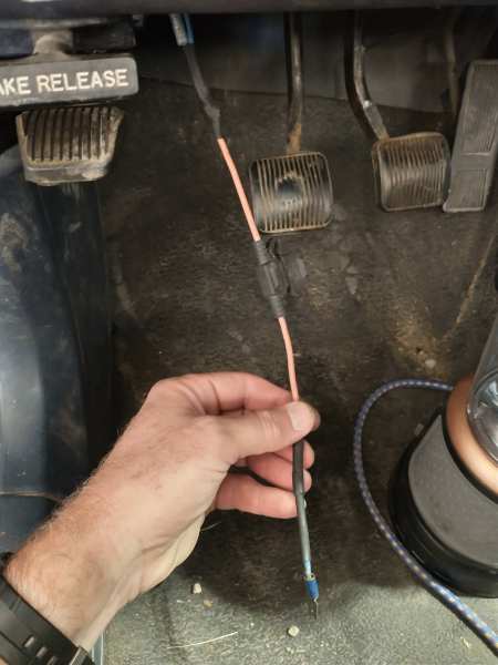

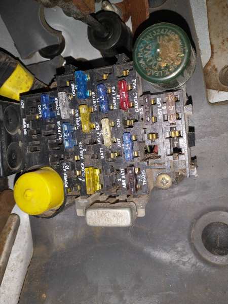

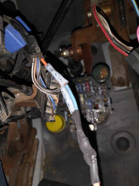

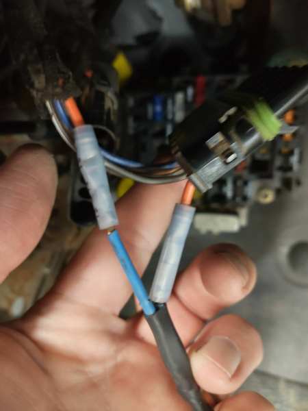

JZLAJeep Posted August 17 Author Share Posted August 17 Dusting off this oldie. Last week I was driving the MJ and my boot hooked on a wire and pulled it out cutting off the fuel supply. When I rolled to a stop I found the wire in the first picture dangling at my feet. Immediately figuring this was a jury rigged I jammed this blade into the fuse panel in the "BATT" slot which got me home. Had to pull it again once I got home of course to keep it from draining the battery. Haven't been driving it since, but today I got under the dash and 1) tried to get it back to usable and 2) figure out what was going on. This may be our problem dating all the way back to the start of this post. Digging around, I found that this orange wire from the first photo is jumpered from a harness above the fuse panel (see the second photo - sorry it's blurry) For today I just fixed it well enough to work and stuck the spade connector at the end of the orange wire into the rear wiper slot. So the fuel pump runs continuously when the key is in the on position, which is how it was before my boot toe snagged the wire. Seems that this is a hack fix that was maybe meant to bypass the emergency fuel shut off? Will appreciate some suggestions on how to fix this properly. Link to comment Share on other sites More sharing options...

JZLAJeep Posted August 17 Author Share Posted August 17 6 minutes ago, eaglescout526 said: So the fuel sending unit wire for the pump got hooked and ripped? Yes, the orangeish jumper wire in the first photo snagged and was pulled out. That wire comes from the cut orange wire in the second photo. That "Y" leads to the spade connector in the first photo. The crimp connectors and shrink tube connectors make it appear to be a hack job. You are saying the spade connector should plug in under the kick-plate on the side wall by the hood release latch? Link to comment Share on other sites More sharing options...
eaglescout526 Posted August 17 Share Posted August 17 Yes it should. Either the grey or black connector. There are two that look the same except in color. You probably will find your broken wire in a connector there….I hope. Link to comment Share on other sites More sharing options...
