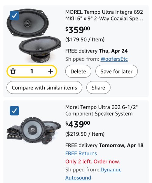

KYŌT Posted April 17, 2025 Share Posted April 17, 2025 32 minutes ago, ghetdjc320 said: I don’t want to speak for Jeremy but he hasn’t been active for some time now. I believe Jeremy was running Tempo’s. If you’re wanting separate tweeters, get a component set vs adding tweeters to a coax setup. I ran morel Maximo components in my last MJ. Sound quality was very good. Having compared the current morel lineup in person, the Tempo’s would be my go to for sound quality for the price point. Focal ISU 130 is another fantastic set if you’re running a smaller sub along with the system. I can tell you that spending the time doing acoustic treatment to the doors and cab has paid off massive dividends in my system. A good class A/B amp for the woofers and tweeters also really improves things along with some good tuning. Once the cab is tuned, then you can really start to tell the difference with your speaker selection. Thanks for the response! So is this the setup you’re talking about? I am redoing it all and have all the sound deadening layers I’ll be putting in after I get the floors done. Link to comment Share on other sites More sharing options...
ghetdjc320 Posted April 17, 2025 Share Posted April 17, 2025 The front speaker size is 5.25 and the rears are 4x6. The rear speakers do very little for sound, but can help reinforce things somewhat. You could run just a pair of the front components in 6.5” size so long as you’re ok with enlarging the speaker opening slightly. Get a class a/b amp and nix the rear. Spend the extra on dynamat Xtreme and some dynaliner. Do the inside of the doors with dynamat and add dynaliner on top of that behind the speaker opening. Also get some aftermarket speaker grills to open up the door panel opening so they aren’t shrouding. The stock knee panel tweeter location images nicely with the woofer even though the placement isn’t ideal. Link to comment Share on other sites More sharing options...
