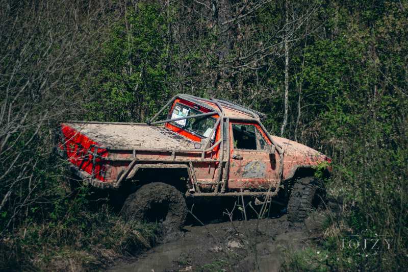

I found this comanche that's been sitting in a barn for 20 years before it was left there it was used as a work truck and have some scars from that. I sold my XJ and decided to build this one instead as I already have way to many projects going on.
Spoiler
BMW 3.0liter M57n enigne with jeep AW4 transmission sequentially shifted with arduino and niftyshifter.
Dana 30, trussed, non CAD, OTA track bar mount, WJ knuckles and brakes Chromoly U-Joints, 4.88 Gearing.
Dana 40 from ZJ, trussed, E-Locker, ZJ disc brakes, 4.88 Gearing.

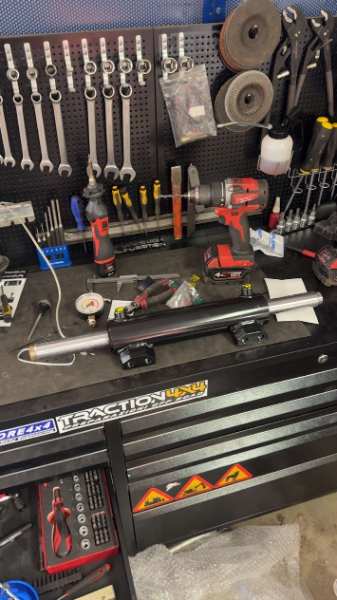

Heim joint steering with hydroassist.
External rollcage

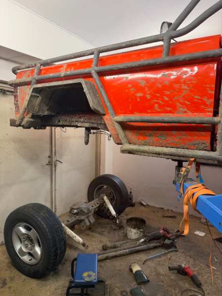

Bed shortend 40cm.
37 inch nankang FT-9 with DIY beedlocks.
Longarms from ironrock offroad in the front.
homemade longarms in the rear, with coilsprings.
Orange because it matches my other car
Spoiler
Not going to change the axles untill I find c303 portals for a decent price.
This is how it looks right now:

Also removing the bed to prepare for the shortening of it, It has a really long overhang!

I've been toying with the idea of dropping a BMW M57 diesel into my Comanche for a while. But after crunching some numbers, I decided it's smarter to use what I've got. So, I'm pulling the turbo M52B28 out of my BMW 2002 and putting it in the Comanche instead.
The 2002 will get a replacement M52B28, but without the turbo this time. It seems like a good way to save some cash and still get the fun of working on a project.
Was really pumped about the diesel, but the M52B28 is already mine, and it's built and ready to go. Plus, it's going to be pretty cool to see how it performs in the Comanche.

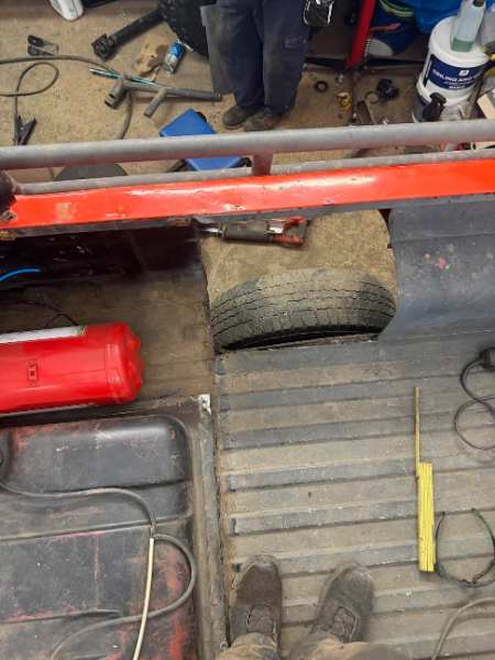

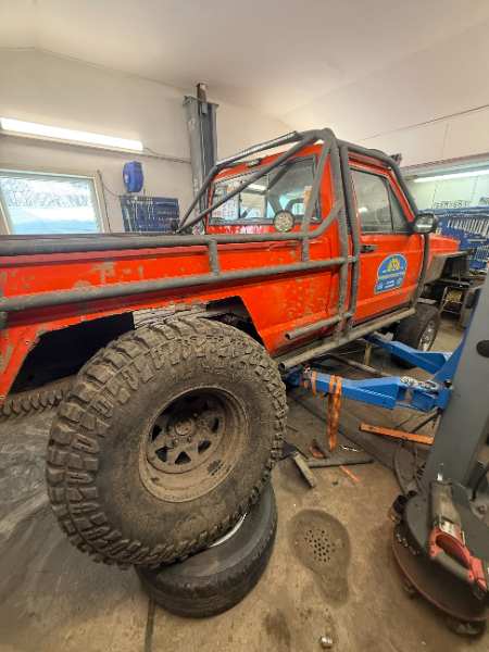

Trying to tac the rest of the cage in place to see if it will look alright, the original roll bar will be removed once I am done with the cage.
The swedish forrests are very very tight for a comanche :fistshake2:
