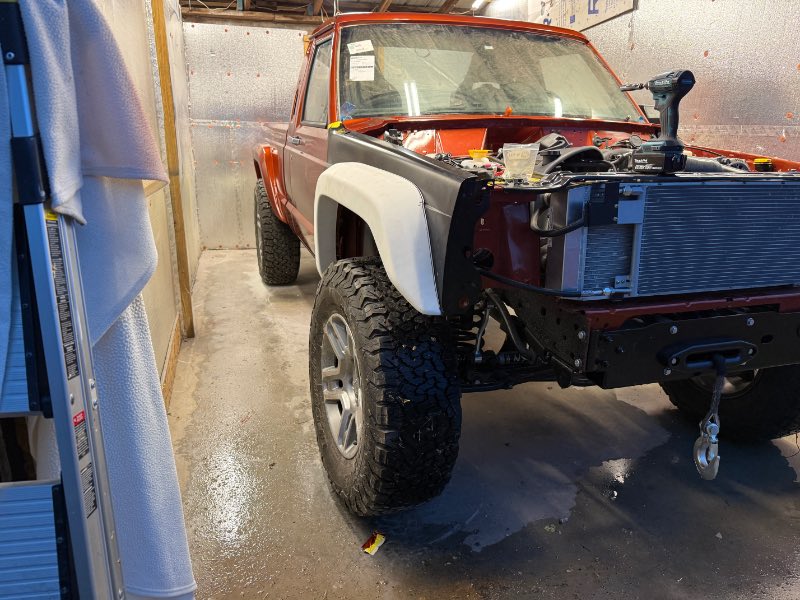

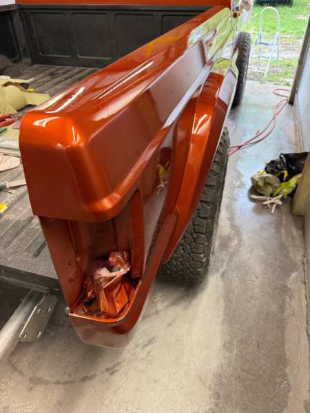

Front fenders are getting trimmed for the notch flares. Honestly, the fitting from the Notch flares is utter crap. Lots of work to get them to fit correctly. Grill, fenders and hood all getting prepped for final fit up and paint.

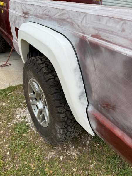

These notch flares take an epic amount of body work to fit properly and look good. Rear flared are installed. The wheel opening gain is mostly in front and behind the wheel which is nice. Once all the bolts are tightened down, I added some fiberglass filler and shaped the flares to fit the body correctly. Then I skim coated the whole bedside and block sanded it. Finished with a coat of glaze. Will do one more coat of glaze followed by sealer then paint and clear. Marathon run to finish this project up in a few days.
Everything I've heard about those Notch flares seems to agree with your statement that they take a ton of work to fit right. I feel like for a piece as expensive as they are, they shouldn't require much, if any, work to get them to fit. That said, they sure do look great. I wish I would've run them on my truck.
The fit is truly horrible and inconsistent. But once they’re fitted, they are nice.
I used some permanently flexible seam sealer for the flares to body seam. Epoxy coated everything and glazed a couple of times. Block sanded it all by hand which is a ton of work. But the end product is epic. The flares have become part of the body now. I’m treating them more like a body kit than a true custom made flare.

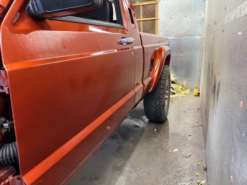

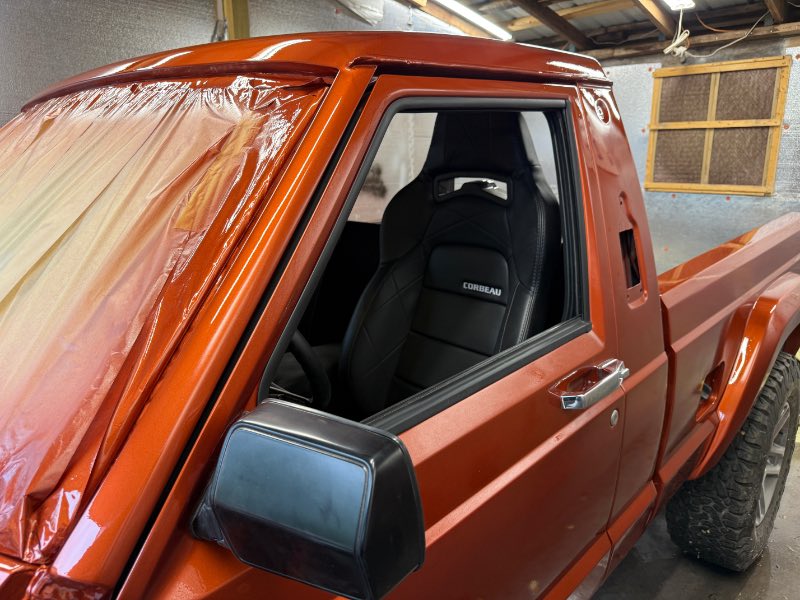

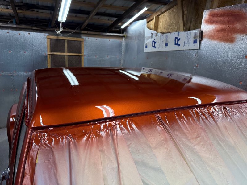

3 coats of base and 4 coats of clear. Will cut and polish it then ceramic coat in about 90 days. Tons of work on the flares contouring them to the body and getting them to look factory.
This door configuration is definitely my favorite. Keeps the classic door styling while having a full size window.

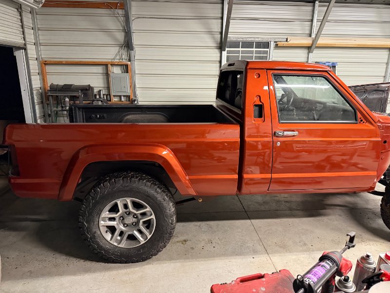

Looking good! What’s left before the trip and when does it start?
Have to finish the hood, fenders, tailgate, cowl panel and grill then align and assemble. That should all happen tomorrow. Wire in the front light harness. Install interior plastics and just go through a bit of a punch list. Have to take off in 6 days :holdwrench:
