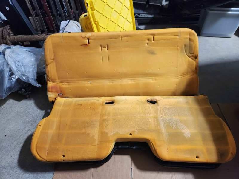

Salvagedcircuit Posted April 25, 2025 Share Posted April 25, 2025 Does anyone have photos of a bench seat with integrated headrest? I am curious how the seat was modified by chrysler. It looks like the bottom seat foam was formed around the top of the springs, but I don't know how the back was designed. It would be nice if the back foam can be removed without severe destruction. The best case would be removable foam front and the springs on the back side. I'd be happy as a clam if I just need to weld on a bracket and the headrest mechanism from a bucket seat. Link to comment Share on other sites More sharing options...
Pete M Posted April 25, 2025 Share Posted April 25, 2025 seat foam is removable. back foam is not (at least not by design). I just recently converted an 88 to having headrests by swapping out the back portion. Link to comment Share on other sites More sharing options...
Eagle_SX4 Posted April 25, 2025 Share Posted April 25, 2025 The foam on the seat back can be removed you just need to cut a single line along the frame and springs from the back side. The foam will be able to be reused and I never had any issues with it afterward. I had to remove mine in order to weld it back together. Link to comment Share on other sites More sharing options...
Salvagedcircuit Posted April 25, 2025 Share Posted April 25, 2025 Woah, Thanks for all the photos guys! Now I'm curious how the headrests come out. Is there a simple button adjuster and the headrest pulls out like a fork? I'm wondering if I could reuse my seat cover and just make two holes and a plastic trim washer. Interesting... Link to comment Share on other sites More sharing options...

AnotherOldJeepGuy Posted May 3, 2025 Share Posted May 3, 2025 So what are the basic steps to removing the seat back, getting to the skeleton, and then putting it back together since mine seems to have recently broken something inside in this general area (from @Eagle_SX4 pic earlier in this thread). Knowing nothing about it, it seems like a lot of upholstery sewing skills and equipment might be needed to put it back together, assuming you know how to get it apart in a condition that allows it to be usefully put back together. Something appears to be broken in the area indicated, I know because pushing down in that area is met with a very noticeable clunk, however the seat back currently looks perfect so apparently the foam is holding the shape with at rest. Link to comment Share on other sites More sharing options...
pizzaman09 Posted May 4, 2025 Share Posted May 4, 2025 2 hours ago, AnotherOldJeepGuy said: So what are the basic steps to removing the seat back, getting to the skeleton, and then putting it back together since mine seems to have recently broken something inside in this general area (from @Eagle_SX4 pic earlier in this thread). Knowing nothing about it, it seems like a lot of upholstery sewing skills and equipment might be needed to put it back together, assuming you know how to get it apart in a condition that allows it to be usefully put back together. Something appears to be broken in the area indicated, I know because pushing down in that area is met with a very noticeable clunk, however the seat back currently looks perfect so apparently the foam is holding the shape with at rest. Shouldn't need any sewing skills, the seat covers come on and off in simple ways. Link to comment Share on other sites More sharing options...
