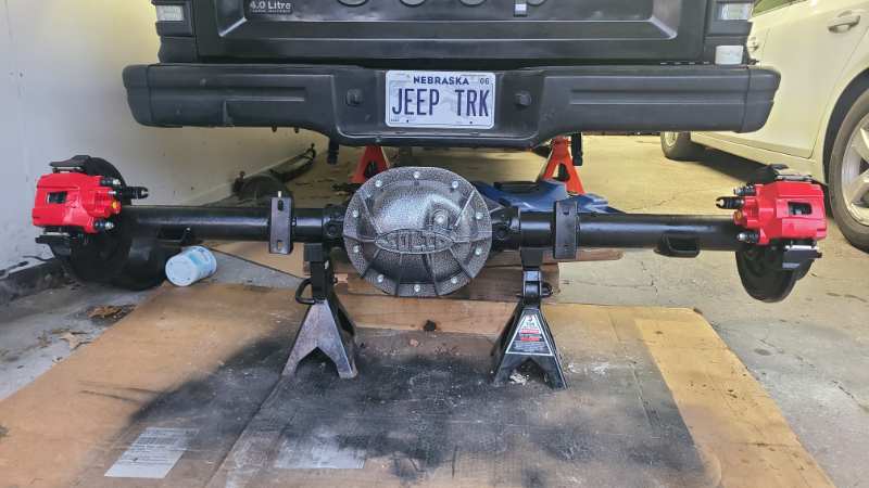

So last fall I was able to score a late model, 29 spline 8.25 from a guy locally that was parting out a manual Cherokee. I'd gone back and forth on swapping in a 3.07 axle as with the smaller tires, 3.55's and the AX15 first gear was all but useless. The donor had seen better days, but everything here has got that "patina"
487928068_9378816612237270_8819605982174022221_n.jpg.9efd85c66ee9ae57c943aec942867a6f.jpg
First step was to get the old perches cut off, as I'm staying SUA. With some careful grinder work, I was able to salvage the factory perches. I also pulled the drums and backing plates to prepare for a disc brake swap as well.
487799598_614820591714946_1530395065363015131_n.jpg.fe1d0ae3282d0f2ed0a35a5ea9b76663.jpg
Next I took the axle over to my Dad's place, as he's got 220V and a fancy new miller in his garage/shop. First we cleaned up the small gouges I'd made cutting the old perches out to give us a clean canvas. I also took this time to really get acquainted with a grinder and wire wheel, cleaning up the housing and tubes.
487432508_4110011199241145_6712803873486832540_n.jpg.42f027dd387b588ba18c50544a7eaa6f.jpg487463407_787021983680649_7939045524062514675_n.jpg.c8116c036939b637cf16d68314ec4e34.jpg
After getting those ground flush, it was time to locate the perches. I'd taken measurements from my old D35, so I knew how far apart the perches should be (42") for the stock Comanche locations. Measured the overall width of the axle, found center and then subtracted the width of the perches Center to Center to get them setup on the axle. I'd also wanted to shift the axle rearward 3/4" to center the wheel and tire in the wheelwell and to also help give me some more clearance for the larger pinion snout of the 8.25" axle. Hopefully I won't have to get a new driveshaft, but it's gonna be close. Drilled a new 9/16" hole 3/4" rearward from center, and then rosette welded the center and rear holes shut for more strength.
487955943_672804982001462_6025258584095328581_n.jpg.7aea61de43a4fdffdfbd3bb51f0b9cef.jpg
488787121_996670659104489_4274304565802771844_n.jpg.3ace3bece28993741618ba21f2708abc.jpg487939618_1407986493895130_8036661198553602450_n.jpg.c6e8f16793e4d9487e499b5e06fb90d2.jpg
Used a pair of angle finders to set the perches and pinion to match the dana 35 that was in there. Not sure if that's the correct way to setup a new axle, but I didn't have any driveline vibration before, so I should have any now if I matched everything up correctly, or that was my thinking at least" Worked out to be with the perched set at 0 degrees, the pinion was point up towards the transmission around 10 degrees. It's backwards in that photo since we'd turned it upside down to weld it them on. Once that was done, it was a simple process of welding my swaybar mounts to the axle matching the previous setup as well and everything should be getting close!487356474_1695579844721110_6089389105246292290_n.jpg.83254b6732131d5e3f7f4f4f0c01e4d1.jpg
Once I've got a coat or two of paint on it, I'm going to start ordering parts for the disc swap. I've already made a a trip to the junkyard to get the backing plates off a Liberty, but I don't see the use in putting gnarly, rusted out junk in for everything else so I'm just going to buy mostly new.
I also want to ditch the load sensing valve and go to a Wilwood adjustable for the whole braking system ran through nicop lines, but I'm still exploring those options.

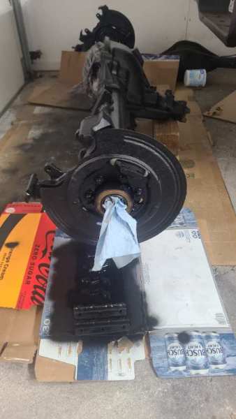

Update: Started working on getting the axle painted with some Rustoleum implement paint in low gloss black. Then it was time to turn my attention to the backing plates.

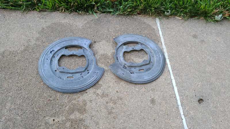

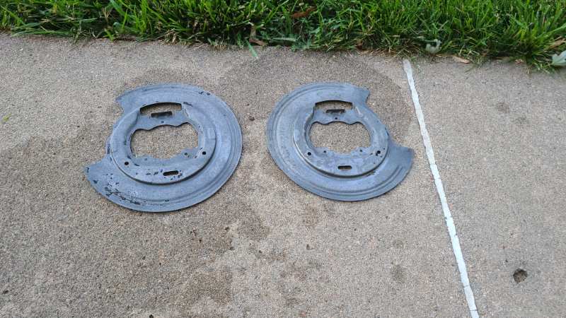

Grabbed some off a Liberty in a local yard. These had obviously seen better days, but all the parts were there. After searching, I found a video from backyard ballistics about a DIY "evaporust" concoction so decided to try that before attacking it with a grinder. The recipe is 100 grams of citric acid, 40 grams of sodium carbonate(washing soda) and an "appropriate amount" of dish soap per each liter of water (I used the hose). Mixed up a few gallons worth in some buckets and left it to sit for a week and do it's thing.
I was not prepared for how well this worked, as it literally removed all the rust like it had never been there and left me with clean, bare metal! After scrubbing them down with a wire brush and more dish soap, I had to battle the bare metal flash rusting!
That photo is after a light brushing to remove anything loose and letting them dry in the ambient air, at which point it promptly flash rusted to what you see. I hit it again with the wire brush, blasted with carb cleaner and dried quickly then hit them with a coat of paint.
The backing plates themselves and assorted nuts and bolts were the same. After pulling them out and lightly scrubbing, clean and bare metal!
20250621_072343.jpg.878bff3d254bdeaf92687b499fc9fe2c.jpg20250621_072357.jpg.df231d34079dbf2f86e02afa1ea8f65b.jpg
I quickly got a coat of paint on these, and submerged the assorted nuts and bolts in a container of oil for now, but wow! I'm BLOWN AWAY with how well this worked for very minimal effort!
I also installed the new bearing and seals in the axle, and pounded out the old axle-shaft studs to replace them with some front Dana 30 studs, which are about a 1/4" longer and should work great with the disc's and aluminum wheels. Once the paint on everything dries, I should be about ready to put it all back together!
