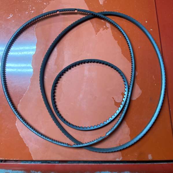

Yeahhhh....it was time to change them. Took my wife to say that the squealing of the belts for me to change them out. I am glad I did too cause the WP, AC and crank belt is missing teeth! Yikes. PS, WP and crank looks fine and the small one is cracking. Typical with age. I wish I knew how old these belts are. I am guessing maybe 20 years cause I know I didnt change them when I first got Chunk.
Interesting enough, he sounds like he runs better and sounds better with the new belts. I will have to observe that.

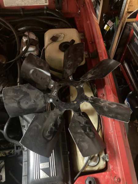

Hey guess what! I am back at it today.
So many years ago I pulled this fan from a 2.8L Wagoneer XJ
I pulled it thinking I could use it on Little Red. Well I couldnt and still cant due to the blades orientation...I was gonna get rid of it today till I started looking at it some more and dug into the 86-87 parts book to see what it is. Well the book kinda helped.
So I said what the hell lets put it on anyways. I got the old fan off and started comparing the two. Blades are oriented the same exact way. Hell yeah! This is now an upgrade for the cooling!
Installed. Tested. Approved! Love a good free upgrade that is now gonna pay for itself from buying it years ago.
