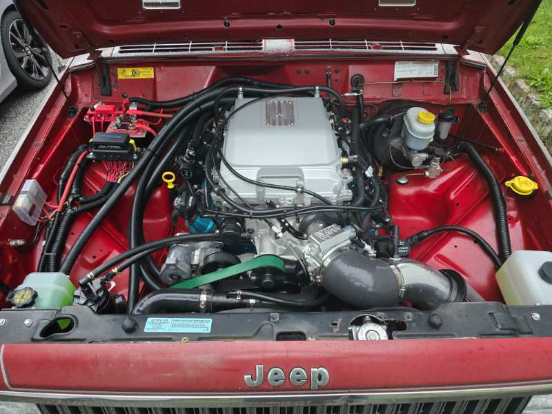

70barracuda Posted March 24, 2025 Author Share Posted March 24, 2025 More progress. Alternator wouldn't fit with the factory steering box so went with a borgeson unit from a full size chevy car. It's super tight but it'll work, and it's a quick ratio box so it should be nicer. Swapped out the camaro supercharger lid for a cadillac one. Hood is so close to making it shut with no cutting. Gonna try some hood spacers and hope it works. Got the front end finished from accident repair. I was worried about the integrity of the front crossmember with it being all bent so I skinned it with some 3/16 plate. Should be way stronger now. Also upgraded to a really nice relay and fuse box so once again redoing all the wiring in the engine bay. Link to comment Share on other sites More sharing options...

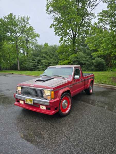

70barracuda Posted May 13, 2025 Author Share Posted May 13, 2025 Shes running and driving again! Link to comment Share on other sites More sharing options...
eaglescout526 Posted May 13, 2025 Share Posted May 13, 2025 When did you get those vintage looking rims? And what’s on the covers? Link to comment Share on other sites More sharing options...
89 MJ Posted May 14, 2025 Share Posted May 14, 2025 Heck yeah! 60s SJ center caps? Link to comment Share on other sites More sharing options...
70barracuda Posted May 14, 2025 Author Share Posted May 14, 2025 2 hours ago, eaglescout526 said: When did you get those vintage looking rims? And what’s on the covers? Actually picked them up last year and just have been waiting to get them on. And its a red and tan "jeep". They are off the full-size from the 60s wagoneers and j series. Link to comment Share on other sites More sharing options...
