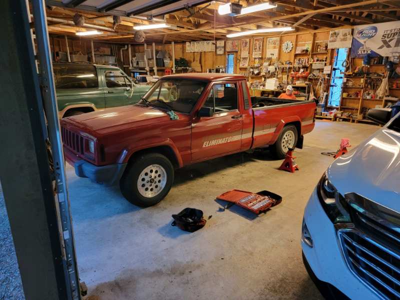

trick34 Posted June 9, 2019 Author Posted June 9, 2019 Made a little progress on the truck today. I pulled the bed to prep for paint.
trick34 Posted June 19, 2019 Author Posted June 19, 2019 Painted the truck today. I’m really happy with how it turned out.
