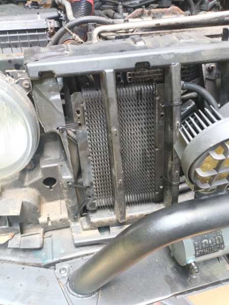

random mods:
MAP disconnected (they all work better without it)
upgraded intercooler hoses
back seat windows held up with duct tape and coat hanger (a common fail with a macgyver fix :D )
abs and trac control died and I've got no plans for fixing them :D   makes it a blast to drive in the winter!
the benefits of a 4banger turbo diesel with a v6-sized gas tank.  :D
and yes, I've gotten close to it before.
and my pride and joy, an early 90s Jeep radio updated with an AUX port by Minuit  :jammin:
also in view are the single din adapter that gives me a place to stash my phone, the plug for AUX, and my bracket for the trailer brake controller.
added a 20" light bar and factory tow hooks
