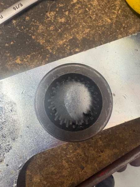

cord367 Posted May 1 Posted May 1 been a sec but the jeep been at a trans shop tying to find a noise, turns out that the input bearing in the transfer case is destroyed but with that we also found where a leak was coming from. so basically when your swap a 231 in place of a 249 on a 46rh your need the swap input shafts to engage the seal which Neohic did when he swapped them. I think somewhere down the line of different owners someone swapped the transfer case and instead of swapping input shafts they made a spacer to engage the seal with in return leaks though the splines. but now that everything if figured out i got the jeep back in the garage and the transfer case is getting fixed. now the next step is getting the rear 44 in. and I've been getting side tracked with painting diff covers
neohic Posted May 1 Author Posted May 1 I lost track of how many times the truck changed hands between you and me. Maybe three? Four? Interesting way of “extending” that input shaft though.
