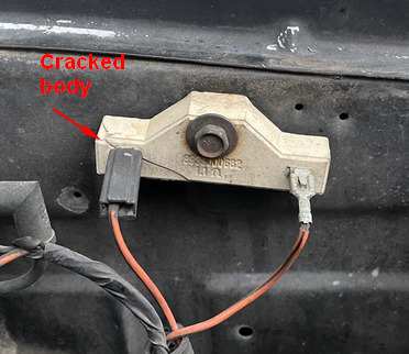

Keyav8r Posted October 29, 2014 Share Posted October 29, 2014 Does anyone have a resistance value for this? And/or a source for a new one? Mine is split in half, but both connectors are still attached to the lower half. Tried to find one on several parts store sites with no luck. May just make a pilgrimage to P&P and see if there's a whole one on a XJ. Link to comment Share on other sites More sharing options...
dunnc1991 Posted October 29, 2014 Share Posted October 29, 2014 You can jump it with a wire. I think I picked up a new one a few years ago from rock auto. I know it is measured in ohms, but can't remember for sure that value. Link to comment Share on other sites More sharing options...
Keyav8r Posted October 29, 2014 Author Share Posted October 29, 2014 Didn't try Rock Auto, thanks. Link to comment Share on other sites More sharing options...
dasbulliwagen Posted October 29, 2014 Share Posted October 29, 2014 I agree.... Just connect the two wires together and drive. Link to comment Share on other sites More sharing options...
HOrnbrod Posted October 29, 2014 Share Posted October 29, 2014 Here's what I did Fred: Image Not Found http://comancheclub.com/topic/36705-fuel-pump-ballast-resistor-upgrade/?hl=ballast Link to comment Share on other sites More sharing options...
Keyav8r Posted October 29, 2014 Author Share Posted October 29, 2014 Thanks, Don. I saw ignition resistors on several sites but didn't know the resistance value. I believe tha 1.2 resistor I saw had threaded terminals. I like the relocation. Link to comment Share on other sites More sharing options...
TORC811 Posted October 31, 2014 Share Posted October 31, 2014 The RU29T that Don mentioned is also available through SummitRacing. Ordering mine shortly! Link to comment Share on other sites More sharing options...
Rockfrog Posted November 8, 2014 Share Posted November 8, 2014 Why not just eliminate it? It was only added in 88 because old ladies were complaining about the fuel pump being loud. Doubt you would even hear it in an MJ. I can't ... Removed my ballast resistor 2 weeks ago, haven't blown up yet. Link to comment Share on other sites More sharing options...
GrizzzzBear Posted November 8, 2014 Share Posted November 8, 2014 From Advanced Auto Parts http://shop.advanceautoparts.com/p/bwd-ballast-resistor-ru17/20100598-P?searchTerm=ballast+resistor Link to comment Share on other sites More sharing options...
