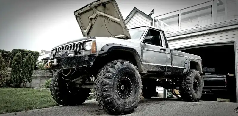

here is a picture of what I am working on now.
