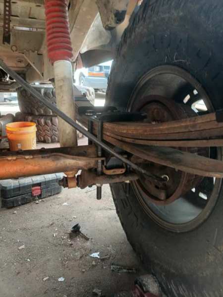

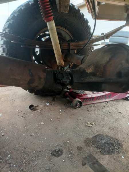

Mr Shy Posted August 4, 2025 Posted August 4, 2025 My soa gave about 8" of lift but my pinion angle is flat now and my drive shaft is 3" short now should I drop my transfer case and shim the leaf springs well my 37s fit but I don't think the dana 35 axle will like it at all

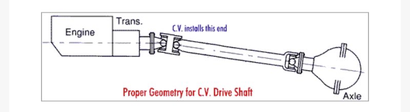

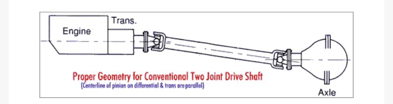

ghetdjc320 Posted August 4, 2025 Posted August 4, 2025 1 hour ago, Mr Shy said: My soa gave about 8" of lift but my pinion angle is flat now and my drive shaft is 3" short now should I drop my transfer case and shim the leaf springs well my 37s fit but I don't think the dana 35 axle will like it at all Looks like you may have an add a leaf in the pack from the pictures. Driveshaft angles are important here if you don’t want it to vibrate like crazy on the road. If you’re not running a slip yoke eliminator in the transfer case, then both the pinion and transfer case should be very close to parallel to the ground. In this scenario you’ll just need to lengthen your driveshaft at a local shop to fit. If you’re going to install a slip yoke eliminator, then the pinion will need to point up to the transfer case output. see this article for the tech info you need: https://4xshaft.com/blogs/general-tech-info-articles/driveshaft-angles Hope this helps
