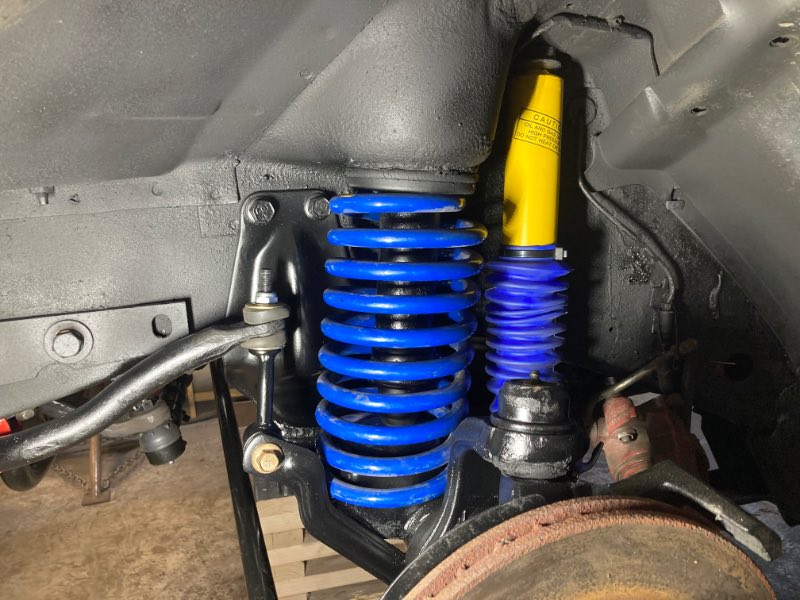

Chasing more low might not be worth it. This morning I went out to put a second coat of Eastwood Rust Encapsulator Plus on the floor and I played around with some coil options.
I took the rear ZJ coils and cut one full coil off the big end. With everything back in I gained another 1/2” of drop when compared to the SCCA coils. I also took out the factory bump stops to see what was going to be the next thing to crash into something else. There’s another 3/4”  between the top of the differential and the frame/engine mount. Worth it?… probably not. Who am I to question the suspension tuning of the Archers anyhow?
With the bump stops out I put the SCCA coils back in to see if they’d settle at all. In the past, I’ve tried rear ZJ coils and they’ll net about a 3” drop. With cutting a full coil off they’ll get you about 3 3/4” drop. The SCCA coils drop about 3 1/4” or so. Good to know, but I’m sure I’ll just leave well enough alone when things get finalized.

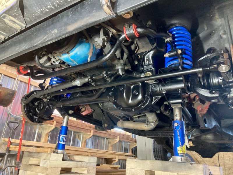

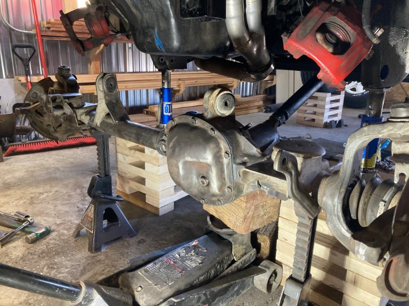

With all the parts here, I finally pulled the 4.10 Dana 30.

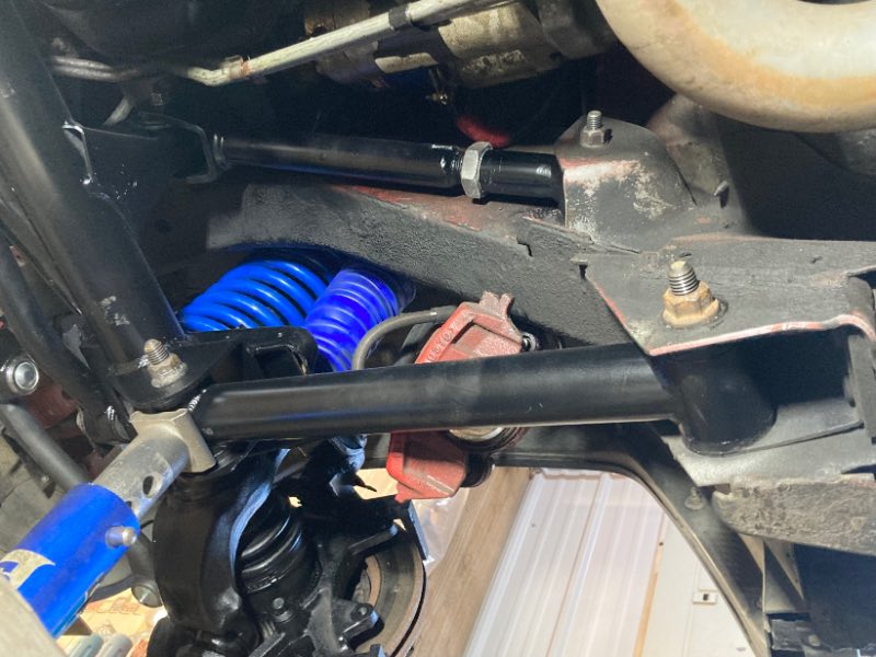

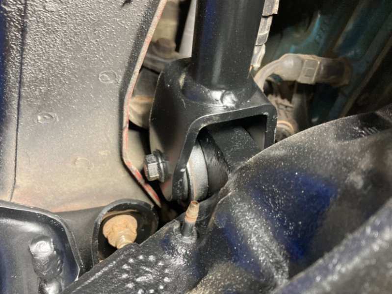

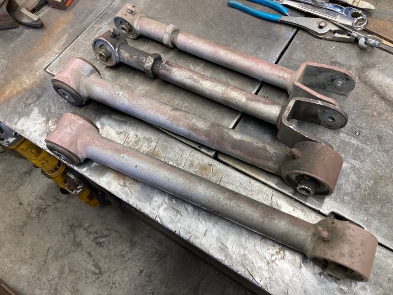

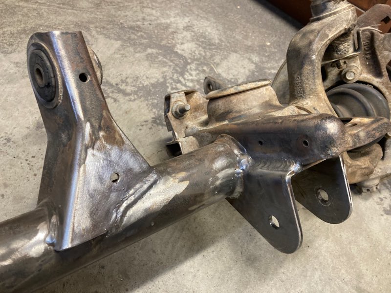

The control arms needed to get reworked, however after pulling them I found that the lower bushings were completely wasted. I think these were Rubicon Express arms and they had a flex joint at the frame side that were noisy since the day they went in the truck.
Being these had a goofy axle side bushing, I decided to just start from scratch. The uppers were fine to just cut the flex joint off. They got replaced with 2”x.250” tube so I could run a standard poly bushing.
The new lowers also use 2”x.250” but I used a scrap of some fancy 1.75”x.120” DOM to connect the dots. They’re overkill for what they need to be.

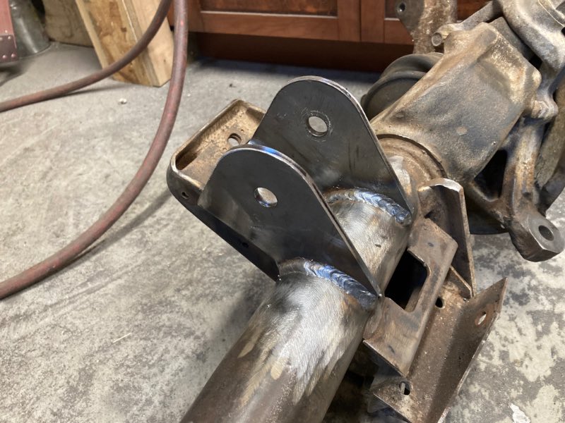

As for the 3.73 Dana 30 going in, the lower control arms got cut off because they were well on their way to falling off. I replaced them with Ruff Stuff 3/16” brackets and put it under the truck on jack stands.
Everything needs paint then it should all just fall back into place.
Kind of a big day for the Eliminator! The axle and parts got painted and installed for the last time. Black… everything black this time. Last time the truck got a birthday the control arms got painted hammered silver and the axles were hammered gray but the diff covers were also silver… IT WAS TOO MUCH!! Younger me clearly wasn’t thinking about tasteful choices that older me might not like.
Looks like 1/4” is the magic number. There’s 1/4” of clearance between the bump stops, upper control arm hardware to the frame, and from the driveshaft to the exhaust. The floor patch got painted and undercoated also. I touched up the undercoating around the rest of the truck too. All that’s left is to swap over the brake calipers, nut and bolt everything again, and double check the alignment once it’s back on the road.

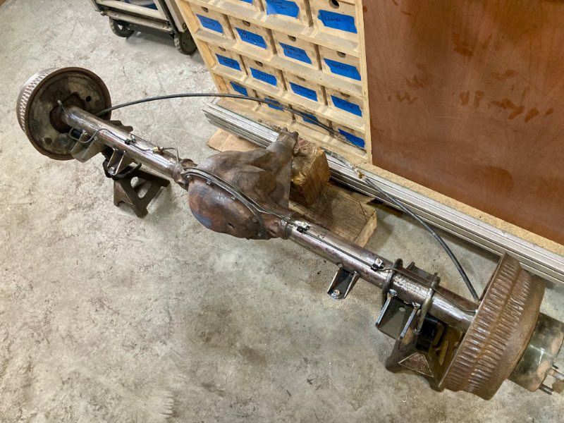

4.10 axles out. I’ll probably hold on to these for at least a year… we’ll see.

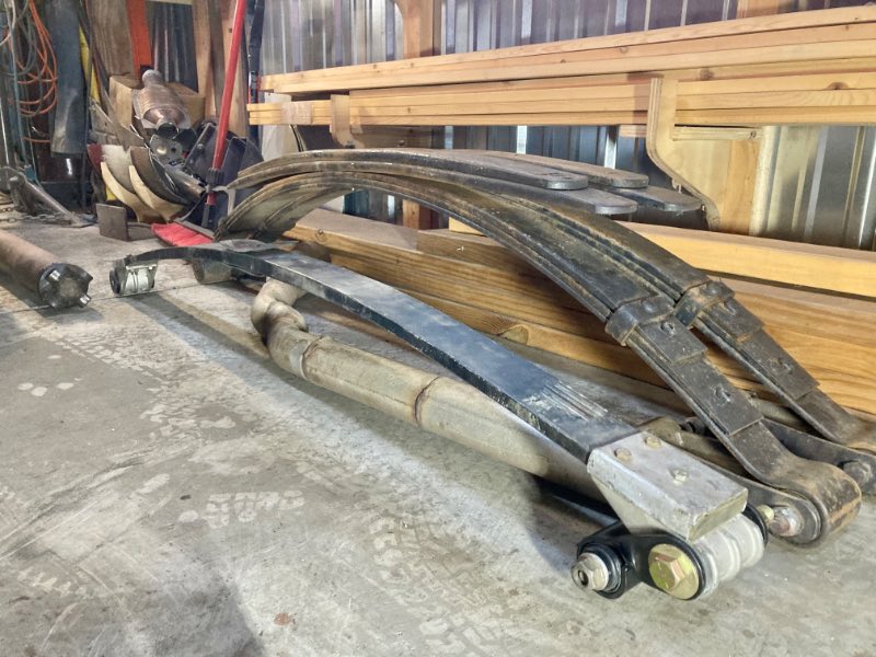

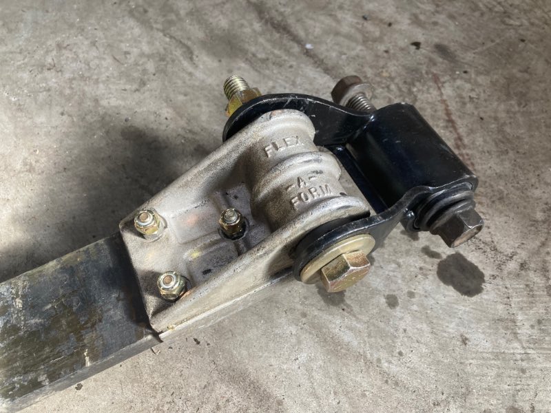

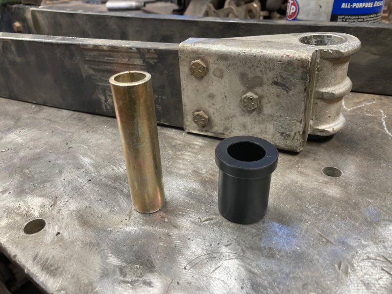

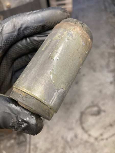

On to those nifty fiberglass leaf springs. The bushings that were at the frame side were just glued in and fell out with a little wiggle. Keep in mind that these were never mounted on anything from the late ‘80s until I briefly mocked them up in an ‘89 I used to have and then taken back out. I’m sure the glue was just fine in their prime but I didn’t trust it after this long.
Luckily the I.D. was 1.5” so a standard poly bushing went in the old bushing’s place. I never had a shackle side bushing as long as I’ve had the springs. A while back I had some bronze sleeves made up but I was never crazy about how they turned out. A friend of mine purchased a lathe and was itchy to use it. He spun some delrin for me.
Little bit of a difference between these and the metric ton springs coming out.

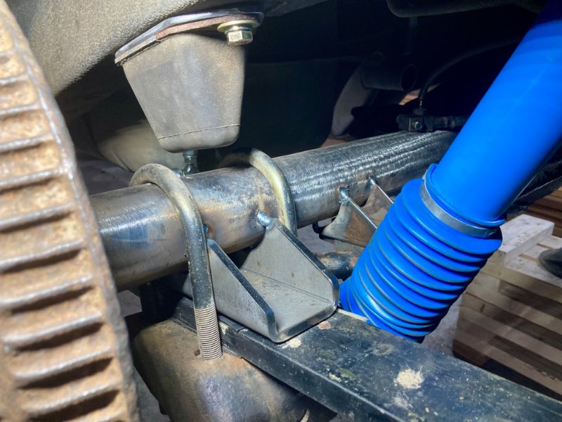

Made for a good landing spot. I need to get the bar where I want it to live and then I’ll figure out end links. The axle pinion angle got measured up and some good tacks got put on the spring perches. Of course I had to throw the wheels on to see where we’re at now.

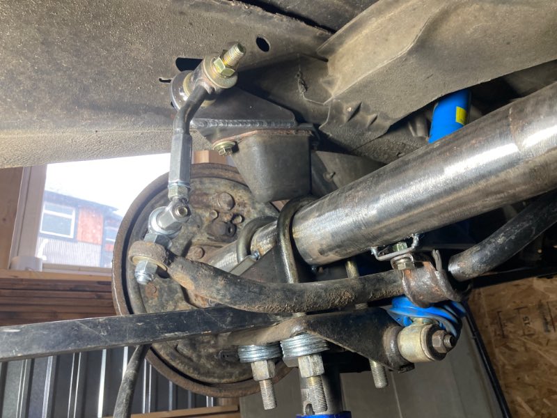

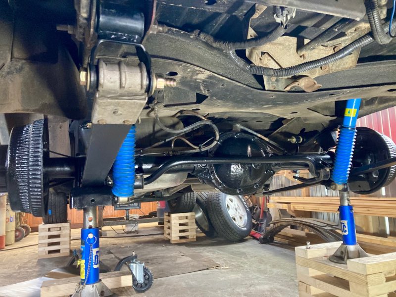

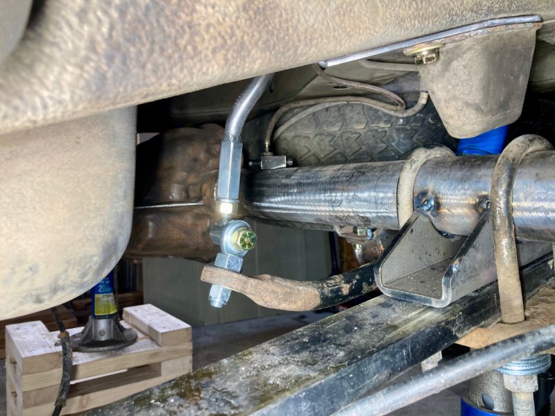

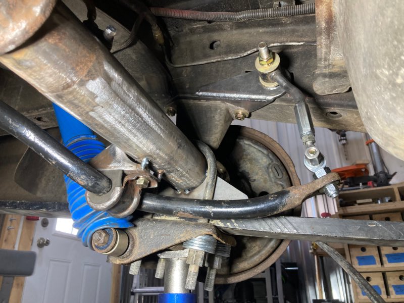

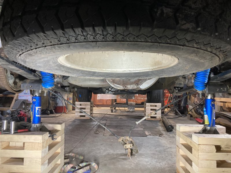

The rear (old front) sway bar was next. With the brackets I made to sandwich to the frame with the bump stops, the next step was to add the axle side brackets and connect the dots.

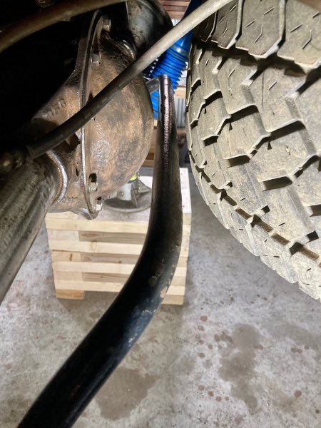

A keen eye will notice that the bar was flipped upside down. Everything was initially mocked up with the bar mounted as it was up front (however flipped with the arms facing forward) but I didn’t like how the arms swung downwards. The bend in the end links made sense when the bar was mounted that way. What I mainly didn’t like was the length of the links so the bar was turned upside down. I might straighten the links… I might not. I don’t think there’s any benefit one way or the other. I did see a benefit to having them adjustable though. Should the truck ever change ride height in the future (because of my track record with this truck) I’ve got room to work with it and keep the sway bar.
There’s plenty of space between the sway bar and the differential cover and spare tire. Granted, that’s a 30” tire stuffed under there too. I might clearance the cover once I’ve got the axle out for final welding to be on the safe side. Otherwise, I like how everything tucks up there!

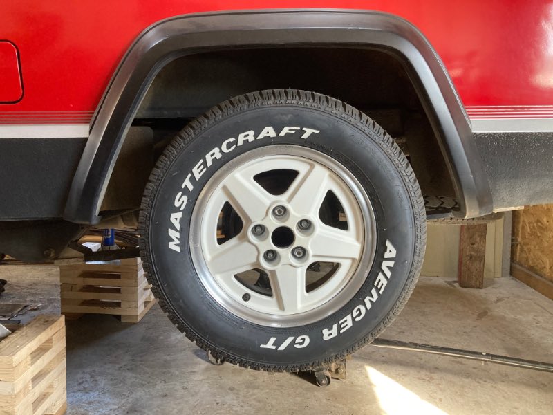

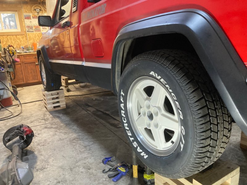

Just for kicks, I also put on a 2” spacer to see if I could flush out the rear tire to match the front.
Nice. I noticed that the wheel isn’t quite where I want it in the wheel well though. This will get addressed once the axle is out also. The rear driveshaft length is fine, but moving the axle back couldn’t hurt that either.
Should be able to pull it all part again for welding and paint.

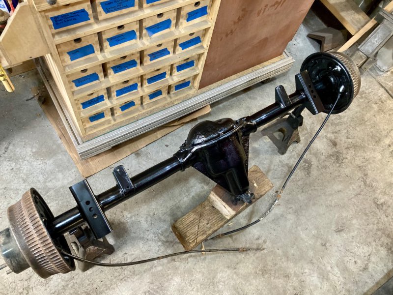

Lots of painting little parts today. I pulled the axle to make up the brake lines but moved it back one hole in the spring perches before completely removing it.
It’s maybe a shade too far towards the rear of the truck, but I’m going to run it. Unfortunately, the sway bar wants to now live in a shared space as the spare tire. Really, I should replace it with an appropriate sized tire instead of the very old 30” that’s been living there since 2005… and it was an old, used tire then.
Otherwise I’m happy with the brake line routing although I should’ve gotten an 18” instead of a 20” for the left side. I added a small woopdie-doo around the u bolts to make up for the added length.

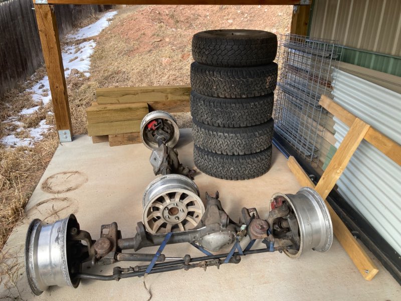

Big day in the shop! The old axles made their way outside. Jury is still out on what to do with those.

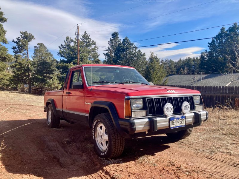

For the past week I’ve been so sick of my dirty shop but the truck needed to get out before I could take a clean up cut. First time on the ground!
With giving the shop a quick sweep, the truck also got a quick trip to the car wash… and of course it started to snow!
There was another guy there that had a super nice fox body Mustang. We were looking at each other and shaking our heads like, “why bother!” :laugh:

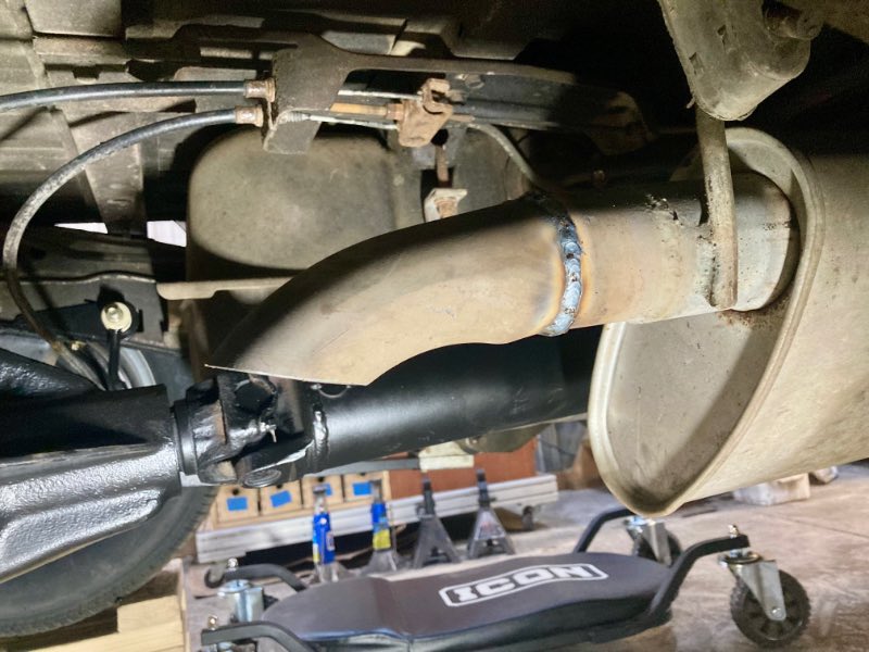

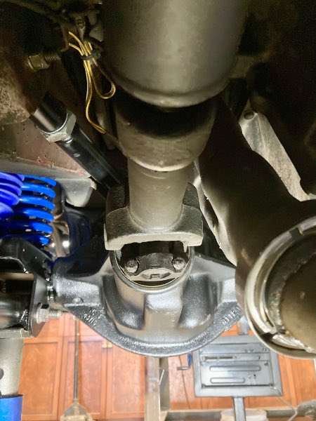

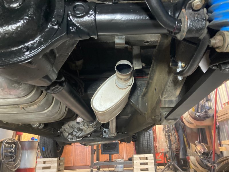

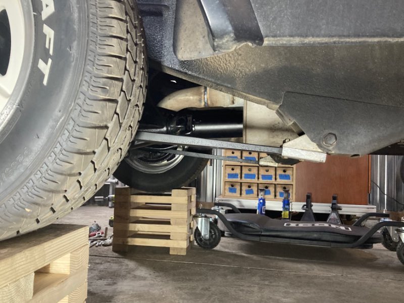

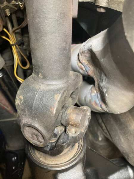

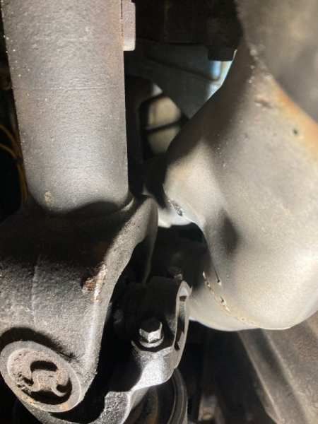

Unfortunately, but not very surprising, I’ve got some issues to sort out. First off is the front driveshaft and exhaust header trying to share the same space. Turns out I didn’t have enough clearance.
:crazy: Can’t say I’m super happy with that, but I’ll also put that on the “I’ll return to this in the future” list. A quick heat and beat made for what I think is enough space. I need to droop the front axle out to get in and do a nicer job. In the meantime it’ll stay as-is until I know that it’s for sure fine.

… I dig it!
Question for everyone: what are your thoughts on a silver front bumper?
20 hours ago, watchamakalit said:
I think it looks good. Not sure the fog lights fir my taste, but not my truck either. Lol. I was never a lowered truck fan but they are growing on me.  This is probably the best version ive seen, except maybe a street manche......
They definitely aren’t for everyone! :L:

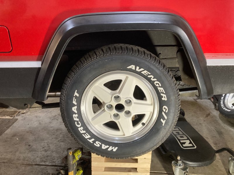

I drove the truck some today. It’s awesome! Can’t believe the difference in suspension feel. I’d say that it’s stiff, but it’s not jarring. The steering wheel can get sawed around and the hood line stays completely flat. I still have a to-do list but I couldn’t resist mocking another part on it.
I’m leaning towards painting the valance black and the bumper silver. Open to opinions though.
17 minutes ago, Smokeyyank said:
With red? Absolutely!
Your truck was one that got me leaning back to silver. When I first got my truck it had a silver bumper.
Kind of leaning towards a silver bumper and maybe a graphite gray on the valance? I’m concerned that having it black might make it disappear.

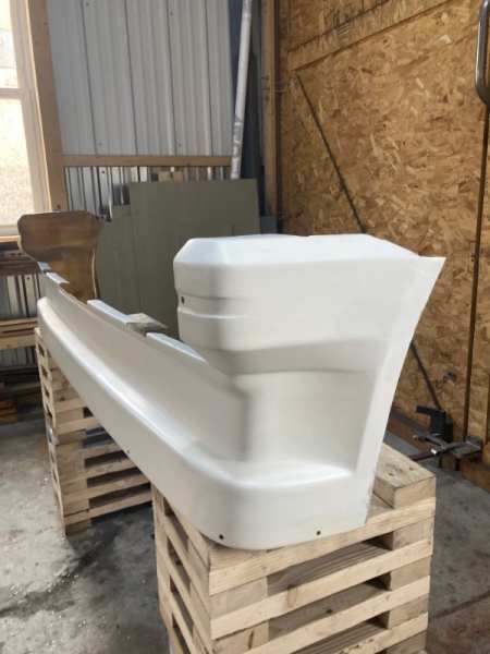

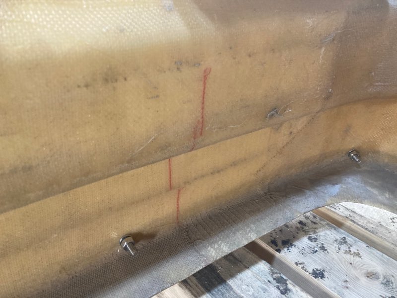

Final fit up on the front valance, scrubbing, and paint today.
It’s strange to me how long I’ve had these parts and finally trimming and cutting and drilling holes in this thing. The valance is admittedly a little rough. Keep in mind that these were not sacred. These were made by the Archers as a throw away piece after getting beat up and bump-drafted on. The fiberglass used is fairly thin and the gel coat had a number of runs. I cleaned up most of the ugly but I didn’t want to really body work it.
