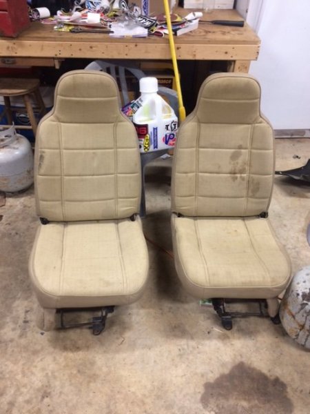

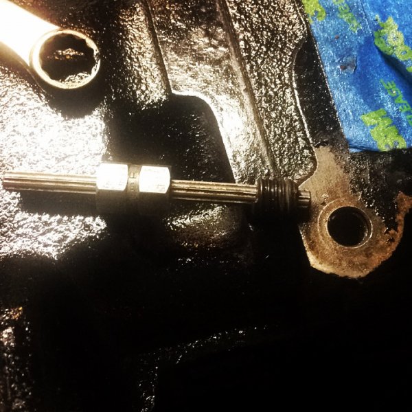

when i got the engine and head back from the builder, The builder missed a broken manifold bolt so i got the try my hand at extracting one for the first time. Pretty proud of that little trophy. I picked up a set of 2 door xj seats from a guy on CL for $30!! (don't mind the wet spots on it from the dog thinking they are for her) -

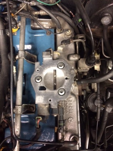

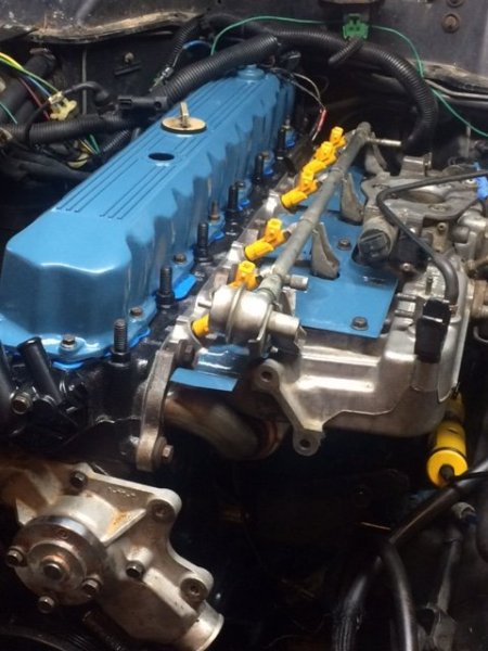

Also finally got the motor back from the builder. Only took 8 months and a lot of harassment to get him on it. But lesson learned..the hard way. Had to have it bored .04 over because some one had ridge honed it at some point and had it all out of wack. I put it back together with most of the original stuff that came off of The motor 8 moths before and had trouble getting it to start. It wasn't getting spark from the coil. I then went back and took loose everything that was butt connected and soldered it back together. Pulled number 5 plug out to see if i was getting any spark to the plug. Turned it over and VROOOOOOOMMMMM!! scared the $#!& outta me when it started. While breaking in the cam it was running super rich causing the ebay specail header i had just got and welded my o2 bung (pictured below) in to turn bright glowing red, it was just open header no exhaust. I then swapped out the stock injectors for the 4 port Bosch injectors. Then emailed Jeff at stroked jeeps and got a 60mm throttle body. Now to tiddy all the wiring up cause its a hectic mess under the hood at the moment and its driving me insane -

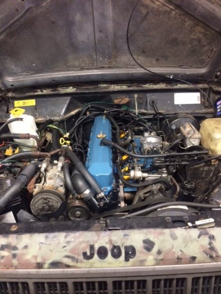

The engine is from another Comanche i bought same year and model. Sorry for the confusion. I just stripped the old block with the JB weld on it and put all that stuff onto the rebuilt motor since the old motor was actually running good just busted. The cps is new. it is not a high altitude one, nether was the old one. I haven't tried reinstalling the old cps yet. Could the cps be bad from the factory? I cannot find any loose connectors or grounds but i possibly could be looking in the wrong places. I'm sure its something simple i am missing but i am udderly stumped The only things i replaced are the injectors to the four port, knock sensor, o2 sensor and the cps. everything else is what came off of the old motor straight to the rebuilt -
The truck was running fine but the block had JB weld on the block. After the install I am not getting spark from the coil to the distributor. We switched out the coil as well as what i am suspecting is the module underneath it, from my current daily which i know is good. Still nothing. We used a test light and went from my daily (which is the exact same engine) and tested the same wires on both trucks. They were both similar in responses. I marked the picture so it was easier to explain what we have tested so far to make sure. we have power to the red, ground to the purple, nothing on the brown, ground on the blue, and nothing on the green. the red had power on both trucks. the purple had ground on both trucks. both had nothing on brown The brown has a connector where it goes from two to one under the shrinkwrap on one truck.. i didnt even check that on the other. the blue on my daily pulsed while the truck was running and one the other it stayed solid while the key was turning over. we used a spark detector on the wire from the coil to the distrib. and from the distrib to the 1 cylinder. nothing on each Any advice guys? I am stumped. Thanks in advance for any help Edit: we also checked the fuses and made sure the alternator was hooked up correctly.
