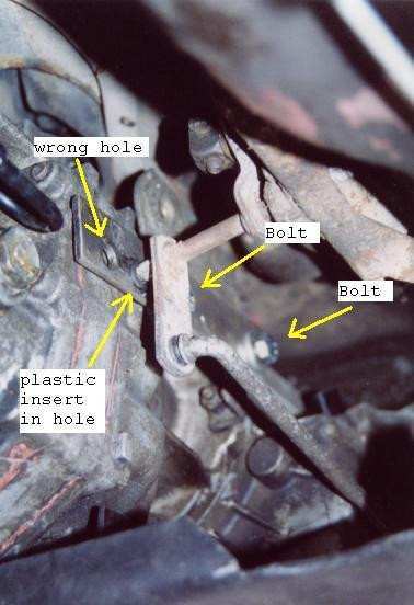

Johnboy Posted Monday at 08:13 PM Posted Monday at 08:13 PM The Peuget BA 10/5 transmission had a bolt for the transfer case shifter linkage. The AX15 does not have a place to bolt transfer case linkage. Does anyone have a solution?
