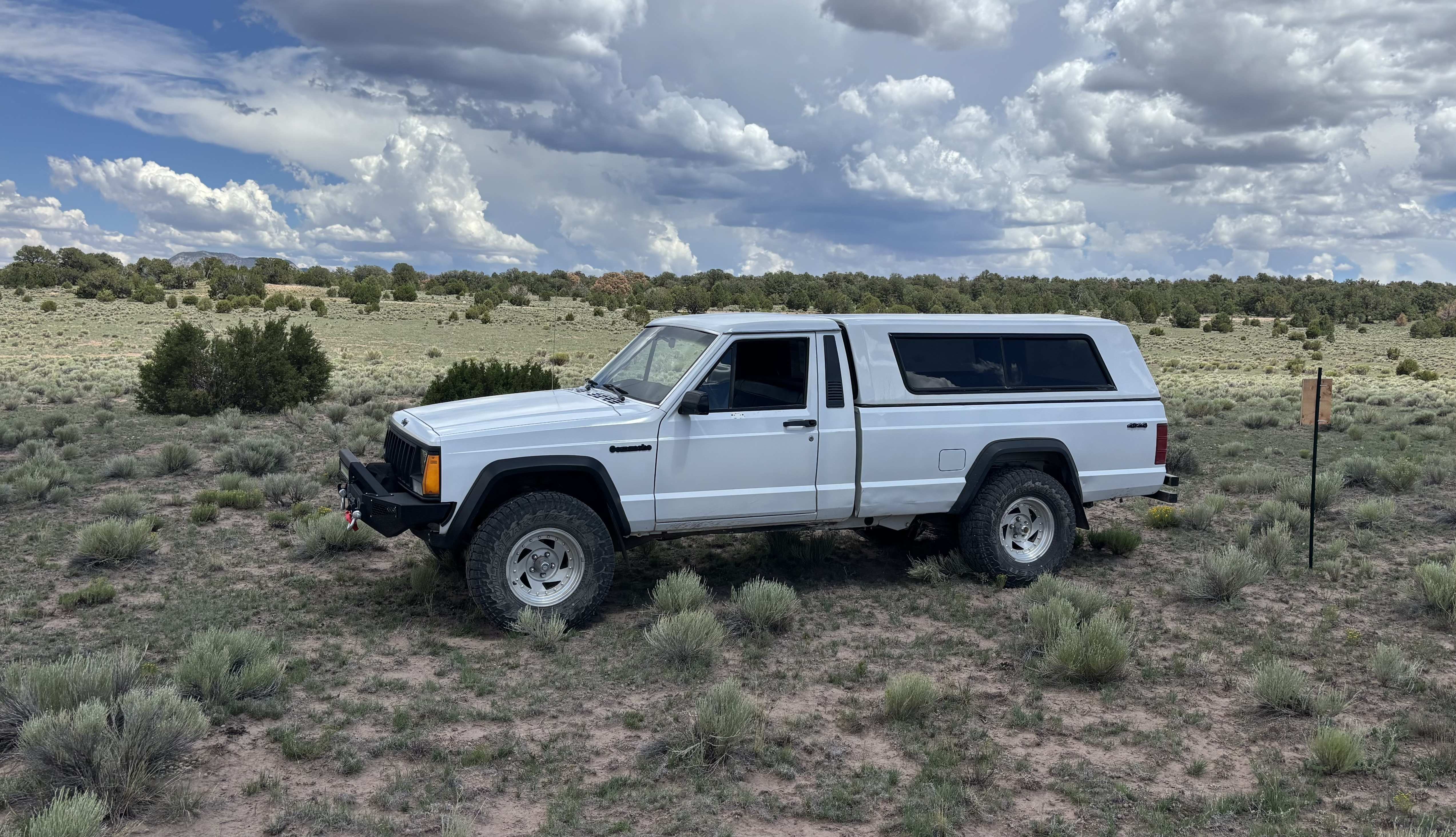

  2. The Dana 35 in my 1988 long bed gave up so I replaced it with a ford explorer 8.8 limited slip. Fit up went well, disc breaks work great but I’m having a hard time finding E break cables. Anybody know where I can get them?
  3. My current Dana 30 has 3.07 ratio high pinion reverse cut. I had no idea that not all Dana 30s are configured the same. I was able to find 3.54 ring and pinion through East Coast Gear supply. Derf was right, they are a great company to work with. Doing a little research with a 3.55 rear and 3.54 front there should be no problem as the difference is about 3%. Thank you all for the help.
