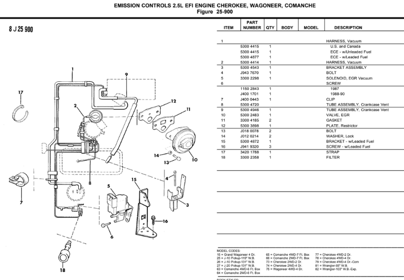

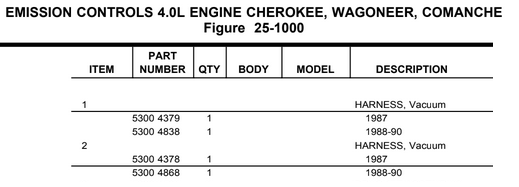

AnotherOldJeepGuy Posted May 26 Posted May 26 Here are the OEM part numbers, maybe searching for the 87 ones.

AnotherOldJeepGuy Posted May 27 Posted May 27 FWIW, Here's the parts catalog page for the 2.5. (Half the time I can't find what I am looking for in these, but might have gotten lucky this time ) Of course having a part number doesn't mean the part is actually available and you may still have to be creative like @eaglescout526!
