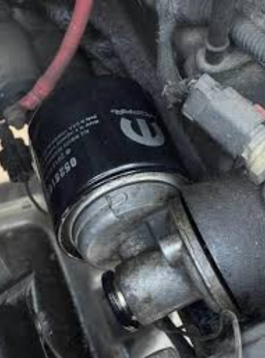

knever3 Posted April 7 Author Posted April 7 Hmm.... My filter housing looks like this: See how close the battery terminal is to the end of the filter? I always thought I had put my Renix one back on when I built it, but the block is from the H.O. era. I always seem to have problems finding a filter to fit, well, one that is any good. I always have to order one in, they always have the junk $6 filters, but no good brands. I will look at my filter, it's an Ams Oil filter currently. I didn't know they would rotate, but if I am going that route, I better replace the O-Rings since they are going to leak once I break it loose. What would you do? 1.) Replace the filter housing with the old style Renix? 2.) Rotate the current filter housing? Pro's Cons?
neohic Posted April 7 Posted April 7 Option 2… should be able to rotate it away from the started. Be sure to inspect the o rings in there when you have it apart too.
Eagle_SX4 Posted April 7 Posted April 7 I agree, rotate the adapter. I have looked at some pics of the adapter and it can be clocked in that position or with the filter pointing up with out taking the locating pin out. Just change the o-rings when you pull it off and rotate it. What is the part number of the filter you are currently using?
knever3 Posted April 7 Author Posted April 7 It should be an AMSOIL EA042 or a Wix 51381. I will snap a pic later today, If I look up those two filters one is metric, the other standard.

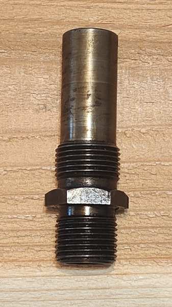

fiatslug87 Posted April 11 Posted April 11 Are you sure it’s an HO mount? I think HO ones have a hex bolt holding it on and the RENIX uses a torx head. Either way as Eagle_SX4 said you can rotate it. If you want to change the internal tube for an HO so you don’t have to use metric filters i have a couple extras, just message me if interested.
Eagle_SX4 Posted April 11 Posted April 11 If you have a Renix filter adapter it will have a long tube beyond the threads. Both the ones I have replaced looked like this. The after market H.O. ones I replaced them with don't have the extended tube on them
fiatslug87 Posted April 11 Posted April 11 The OEM HO ones are also short. Cruiser’s swap write-up shows the two sided-by-side.
