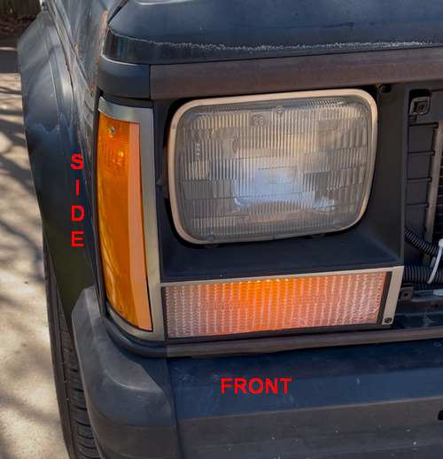

AnotherOldJeepGuy Posted 1 hour ago Author Share Posted 1 hour ago OK I went back out to the Jeep to investigate the lights and the mostly work. When I said "mostly work", what I meant by that was 1 time out of many, the FR Bottom did not blink, it remained constant on instead. But all times but once all the expected to blink lights did blink. And I don't have the stuck light on my dash right now. So technically I don't really have anything to fix, so I won't! This seems like a good time to add in this bizarre operation just to see if what I see is "normal". I don't know that it is new, seems like I noticed it before, but still while I have a light conversation going.... If the headlights are on, the turn signals alternate SIDE-FRONT-SIDE-FRONT. But with the headlights off the SIDE AND FRONT bulbs blink on/off at the same time. So bizarre! BTW this same bizarre operation of simultaneous or alternating on/off depending on if the headlights are on/off is the same at both sides, and it is also the same if I engage the hazard switch instead. Since blink is blink, I don't really have anything to fix here, but it sure makes me scratch my head! Anyone else have this same scenario, or do I just have a haunted Jeep? Link to comment Share on other sites More sharing options...
