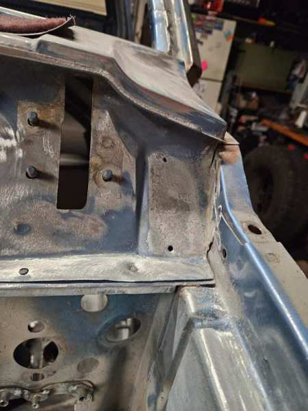

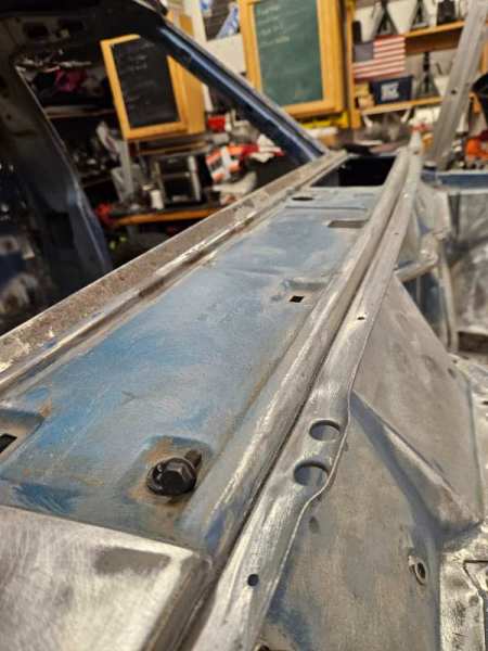

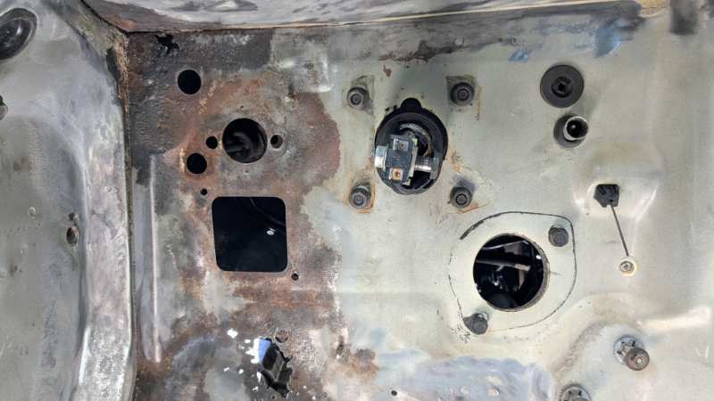

Where did the factory put seam sealer in the engine bay, exterior, and interior? I'm 75% confident in what "makes sense" when looking over everything, but I'm not interested in missing some weird path for water to find its way in.
I’d put it on every seam you can see. Even the factory didn’t get them sealed up perfectly :dunno:

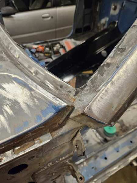

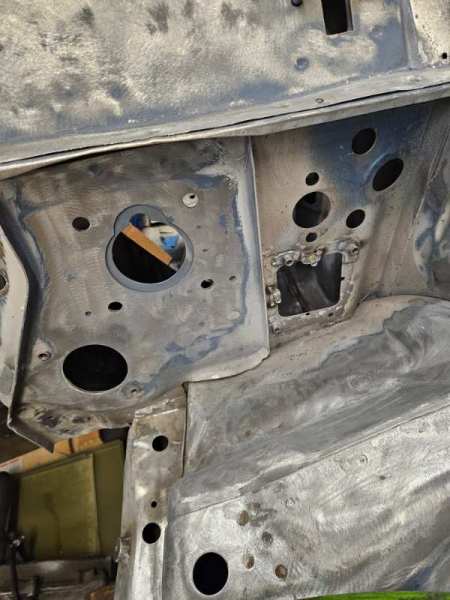

No problem. As the others have said, seam seal everything. Only one other thing to add, and from your pics looks like you may have already done this - remove all the factory seam sealer you can. When I had my truck cleaned up, most of the spots that needed attention were under the factory seal sealer.
I also discovered rust under the factory sealer.  Spooky.
It seems there are different schools of thought regarding seam sealer, and I think the "seal one side" approach makes the most sense.
As appealing as "seal everything" sounds, you have to ensure that moisture isn't trapped.  I won't pretend that you can actually prevent moisture from getting in.  Even condensation from hot/cold cycles is enough to cause problems.

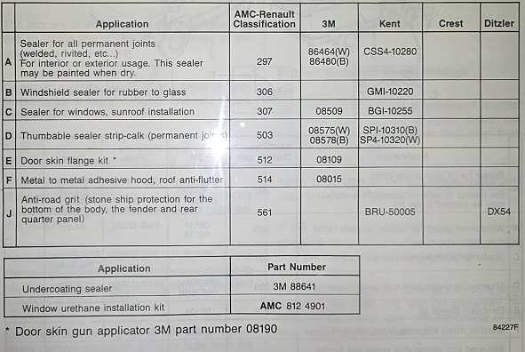

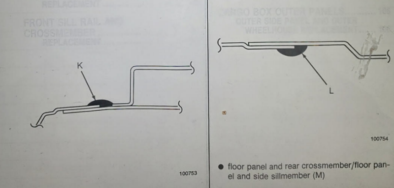

It looks like Jeep thought the same way:

I do plan on being very liberal on the "one side"

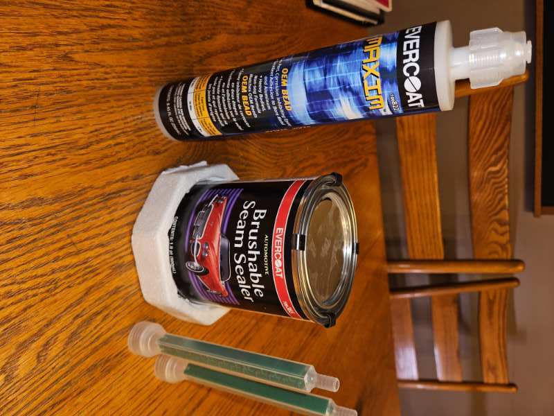

I'm going with a combo of brushable 1K and some 2K.  Not sure exactly where each will be applied.

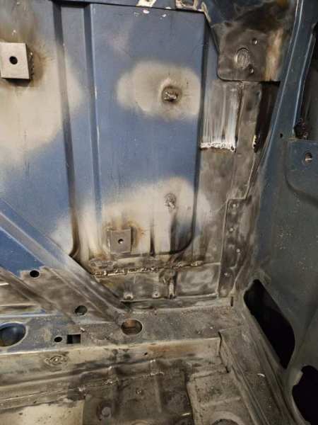

The factory tended to seam seal the back side of joints (the non exposed side). I really have mixed feelings about that. You can’t leave places for moisture to accumulate without proper drainage. At times, seam sealer can actually trap moisture or prevent drainage. That’s why I like POR15 inside metal seams such as pinch welds followed by seam sealing the back side. The por15 loves to seal up cracks and crevices in metal. The process I used was to mask off the back side of a seam then allow some POR15 to wick its way down int the joint. I’d the seam sealer the back side of the joint then hit both side with raptor liner. Did most of my truck that way. Strategically adding drain holes in certain areas before this process helped a lot as well. And one quick tech tip for removing old seam sealer, use an oscilating tool with a caulk cutting blade. They work very well at getting the old single stage seam sealer off. The factory application was horrendous on my 90’.
I'd also recommend getting every bit of factory sealer off. I had rust under mine all the way up to the cowl on the drivers side. I also did what @ghetdjc320 suggests with POR15, even going so far as thinning some slightly and applying multiple coats to overlapping areas until I saw a little seeping through. I would use 2K anywhere the gap I was sealing was larger than the shrink ratio of the 1K sealer. I only used a 1K, but in areas with larger gaps I made sure to keep the beads fairly flat and overlapping the seam by half the width of the gap-ish, and it still seems fine almost a year later.

I can't speak for anyone else, but I'm not an expert either. Nor do I think POR15 is a do-all product. I only used it because I had about a half gallon sitting around. It also wasn't the only thing I used. I only used POR15 inside the truck on the top surface of the floor and braces. The thinned out POR15 I used in areas of overlap like where the brace goes in between the floor and the brace at the bottom of the back wall, and some vertical welds on the firewall and trans tunnel. Any cavity I couldn't get a brush into got Eastwood internal frame coating applied. Any seam or butt joint outside the truck got a liberal coat of Mastercoat (I would've done everything with Mastercoat but at the time you could only buy a quart at a time, and it was out of stock more often than not), then seam sealer applied over it. And any surface within 3/8-1/2" of a weld got 2 coats of self-etching weld-through primer. The only areas where I thought moisture could get trapped got Mastercoat over the weld-through primer, and I put it on with a small brush and really tried to jam it in there. Time will tell if that was the right approach I guess.

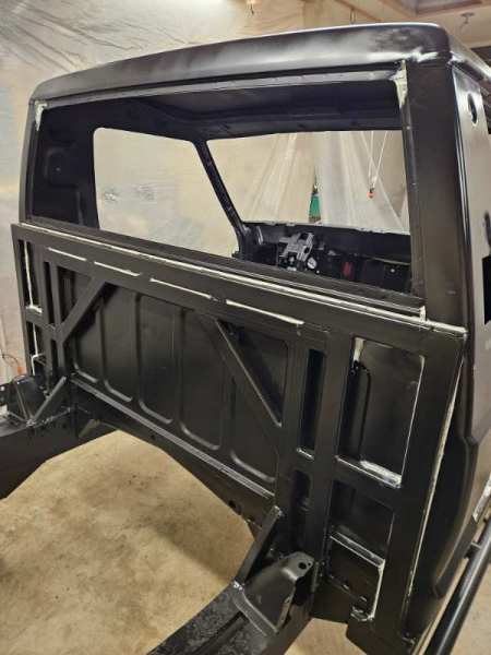

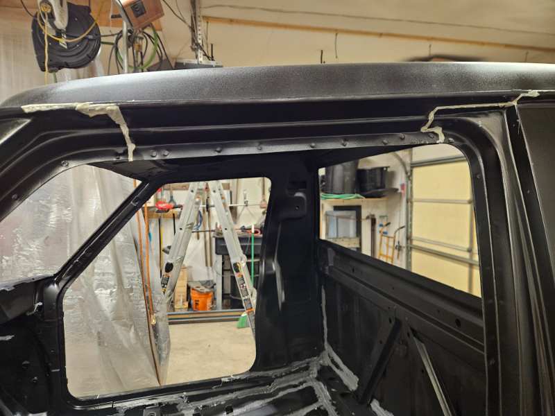

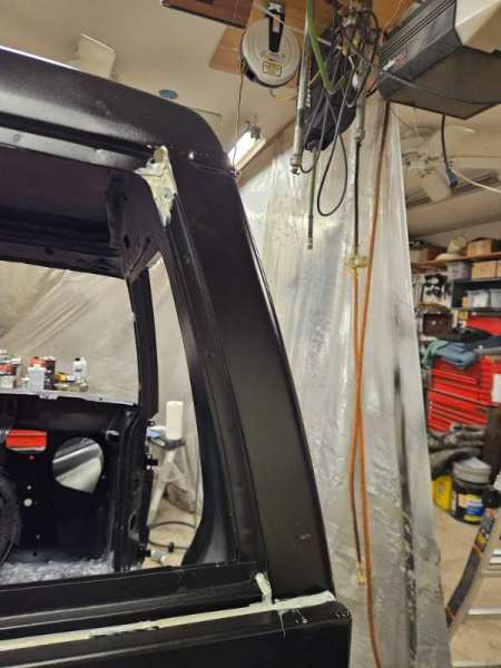

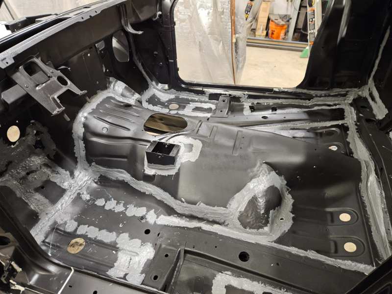

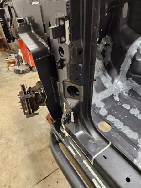

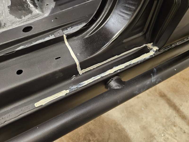

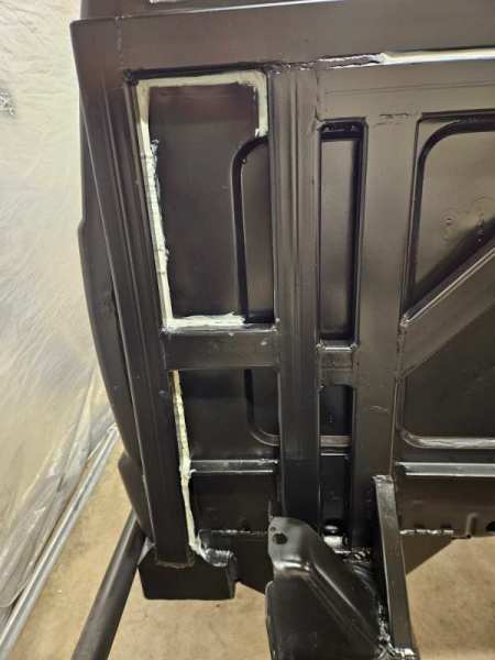

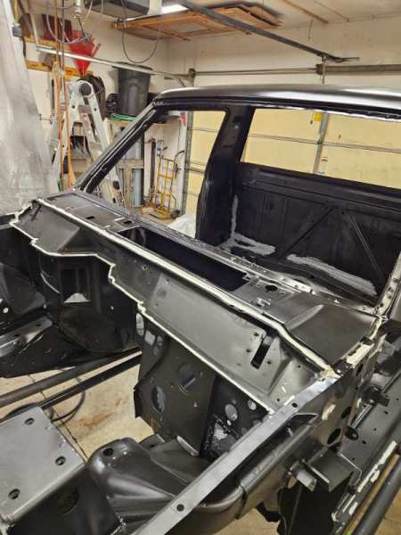

Well, the 2K tubes went a lot farther than I anticipated. Lots of lessons learned when applying them - most of which I'm sure I'll forget by the next time I do this on something :laugh:
