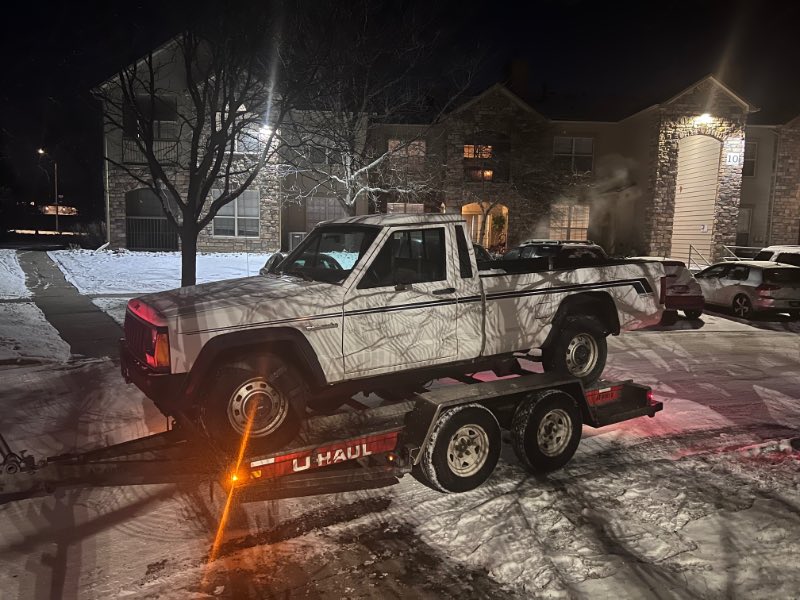

Doc Payne Posted February 19 Share Posted February 19 Here’s the start of the blog that I’ll be using to track everything that happens to this little truck. I picked it up in Fort Collins, CO on January 24, 2026. It was not running and the PO told me it was likely the fuel pump. Loaded it up, headed back towards home. About an hour away from home the snow picked up, making for a sketchy drive, but made it safely. Link to comment Share on other sites More sharing options...

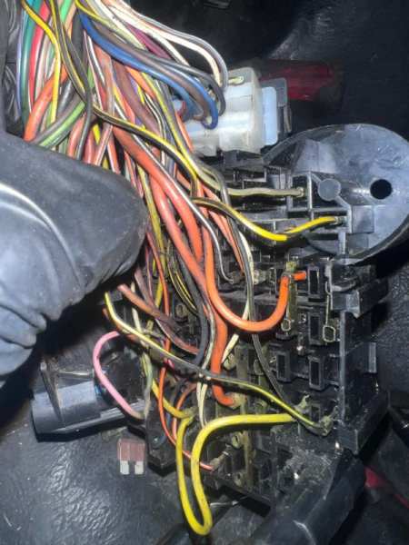

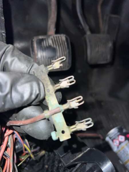

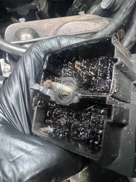

Doc Payne Posted February 25 Author Share Posted February 25 I was having some electrical gremlins inside the cab and went searching. Found a leaking clutch master and very corroded fuse panel. Replaced the clutch master to solve the leak. For the fuse panel, I pulled a replacement from an 88 Cherokee from the junkyard. I ordered a bunch of bus bars and single connectors from connectorkits.com and went to work refreshing every single wire. I found a broken wire going into the dome fuse and repaired that while I was there. I also had the C100 connector apart, thoroughly cleaned out all the black tar stuff and replaced the firewall gasket with one from Casper Electronics here in CO. These repairs fixed my brake light and turn signal issues, as well as my dash lights. The headlight switch still needs replaced as it has to be turned all the way counter clockwise for the dash lights to work. My interior courtesy lights are still not working, and neither is the radio. So I’ve still got more work to do. Link to comment Share on other sites More sharing options...

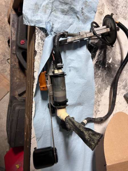

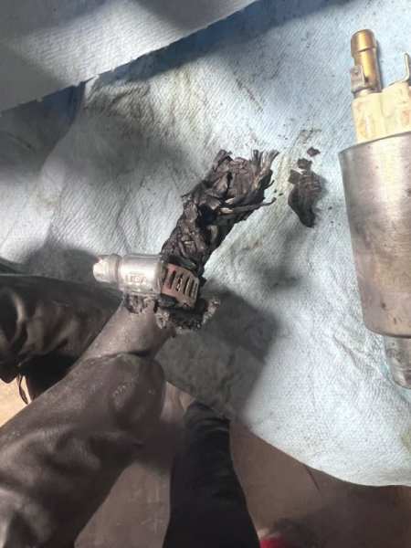

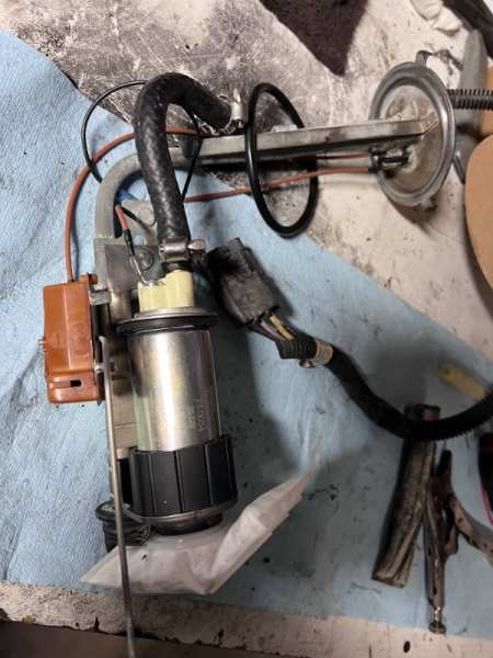

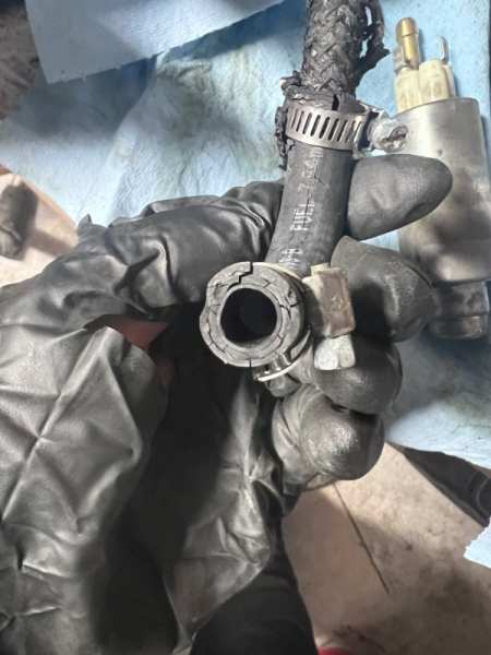

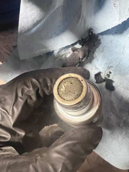

Doc Payne Posted February 25 Author Share Posted February 25 When I purchased this truck it was a non-runner. The previous owner had claimed that fuel pressure before the filter was 3-4psi. So as soon as I got it home I pulled the pump and found this disaster. Replaced the pump with a Delphi FE0054 from Amazon which came with the hose, O-rings, and new wires as well. Installed it and the truck fired right up! Link to comment Share on other sites More sharing options...

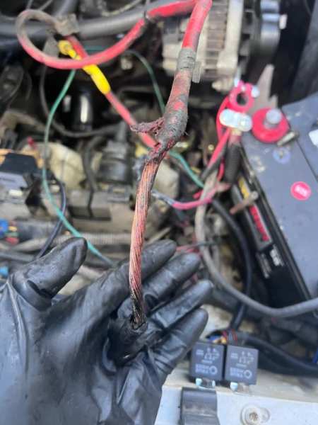

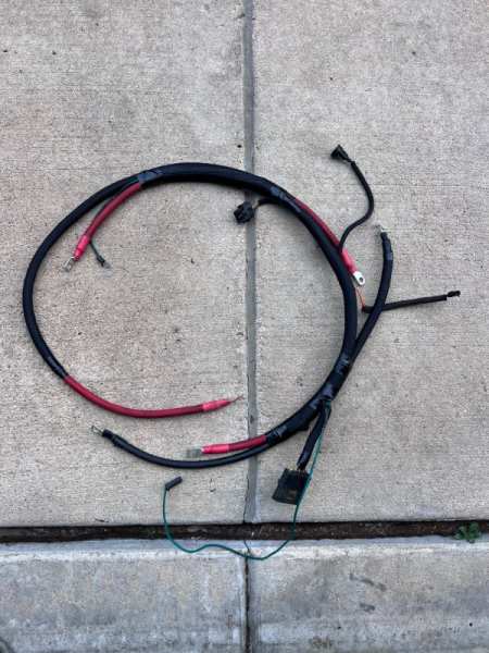

Doc Payne Posted March 14 Author Share Posted March 14 Mitigated some fire hazards this week with the battery cables. Since I plan to keep this truck stock, I just went with 4AWG welding cable. Added in a mega fuse off the alternator cable. Before: After: Link to comment Share on other sites More sharing options...

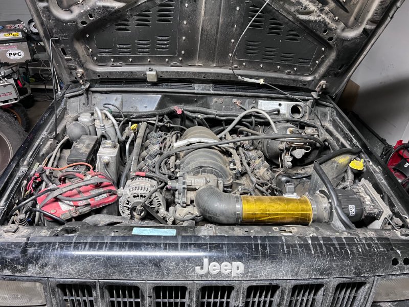

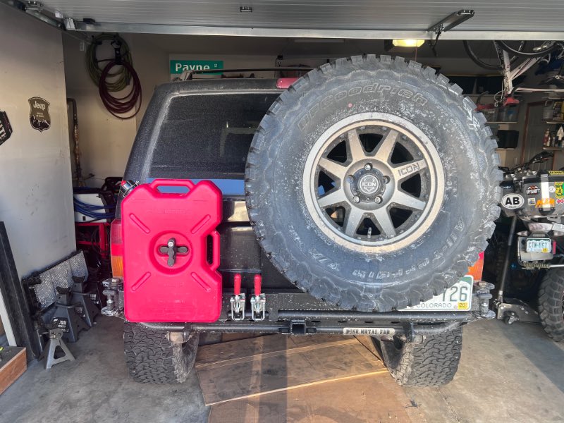

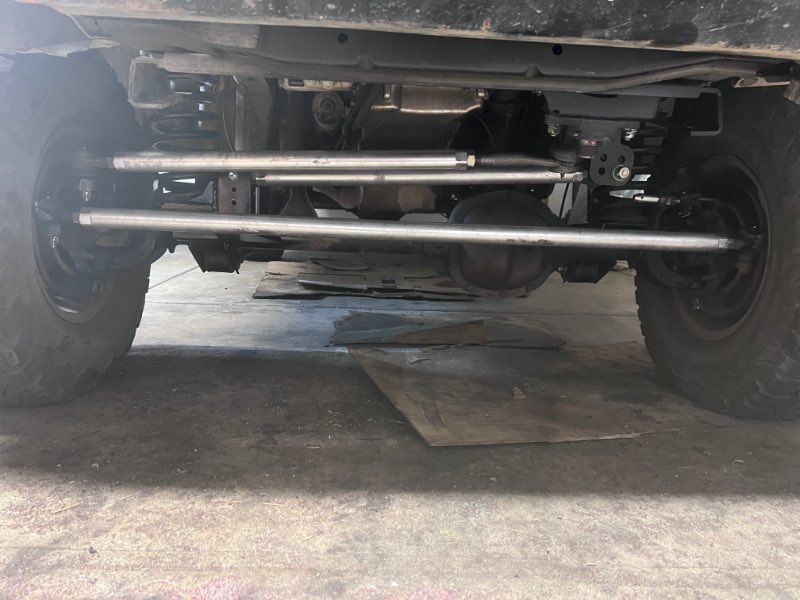

Doc Payne Posted March 14 Author Share Posted March 14 If anyone cares to see my other rig, the LS XJ, here it is. It’s a 2001 with an LQ4 6.0, 4L80 trans, NP241C t-case, ford 8.8 rear factory LSD, Dana 30 front with spartan helical LSD & WJ knuckle swap with Stinky Fab Aluminum steering, 4.10 gears, ~5.5” lift, frame stiffeners, icon rebound pro beadlocks, 35” BFG KO2s. Link to comment Share on other sites More sharing options...
neohic Posted March 15 Share Posted March 15 3 hours ago, Doc Payne said: If anyone cares to see my other rig, the LS XJ, here it is. It’s a 2001 with an LQ4 6.0, 4L80 trans, NP241C t-case, ford 8.8 rear factory LSD, Dana 30 front with spartan helical LSD & WJ knuckle swap with Stinky Fab Aluminum steering, 4.10 gears, ~5.5” lift, frame stiffeners, icon rebound pro beadlocks, 35” BFG KO2s. Heck yeah!… I know your rig! You just had it at my buddy Ian’s shop where I got to see it first hand. Very nice! Link to comment Share on other sites More sharing options...
Doc Payne Posted yesterday at 06:33 PM Author Share Posted yesterday at 06:33 PM On 3/14/2026 at 8:21 PM, neohic said: Heck yeah!… I know your rig! You just had it at my buddy Ian’s shop where I got to see it first hand. Very nice! Oh no way! That’s awesome. Yeah Ian is a cool dude and did a killer job with the bumper. Need to get it back into him once I get the rear stiffeners done so we can add a couple more supports. Link to comment Share on other sites More sharing options...

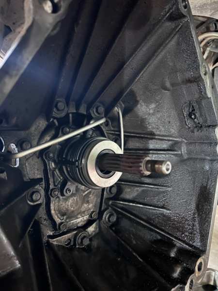

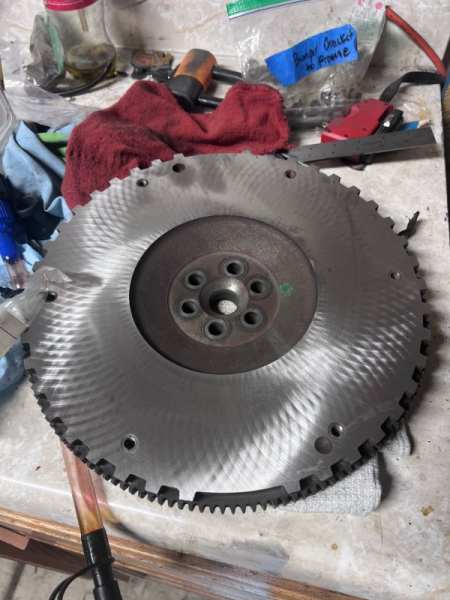

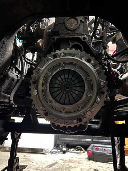

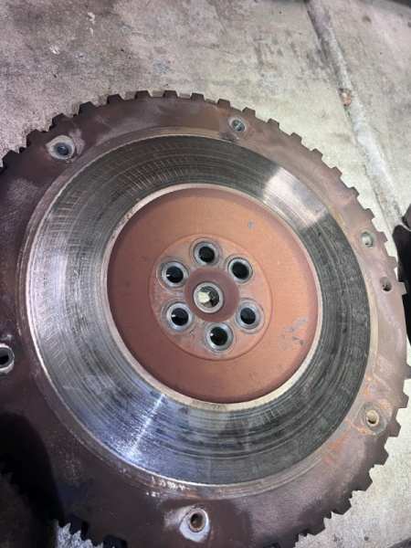

Doc Payne Posted 4 hours ago Author Share Posted 4 hours ago This week’s Comanche update: clutch pedal went flat coming off the interstate on the way to work. Clutch master is empty so I’m guessing the slave cylinder gave up. The master is new and lines are dry going to the bell housing. I’ve ordered a new LUK clutch kit and slave cylinder. I’ll have a local shop resurface the flywheel. Link to comment Share on other sites More sharing options...
Eagle_SX4 Posted 2 hours ago Share Posted 2 hours ago I have had bad luck with new master cylinders. Check to make sure there is no brake fluid on the fuse block and in the footwell. Link to comment Share on other sites More sharing options...
eaglescout526 Posted 12 minutes ago Share Posted 12 minutes ago The internal slave on the 87-90 2.5Ls is what prompted me to hunt down an 84-86 external slave set up so I don’t have to keep messing with shoddy quality internal slaves. Link to comment Share on other sites More sharing options...
