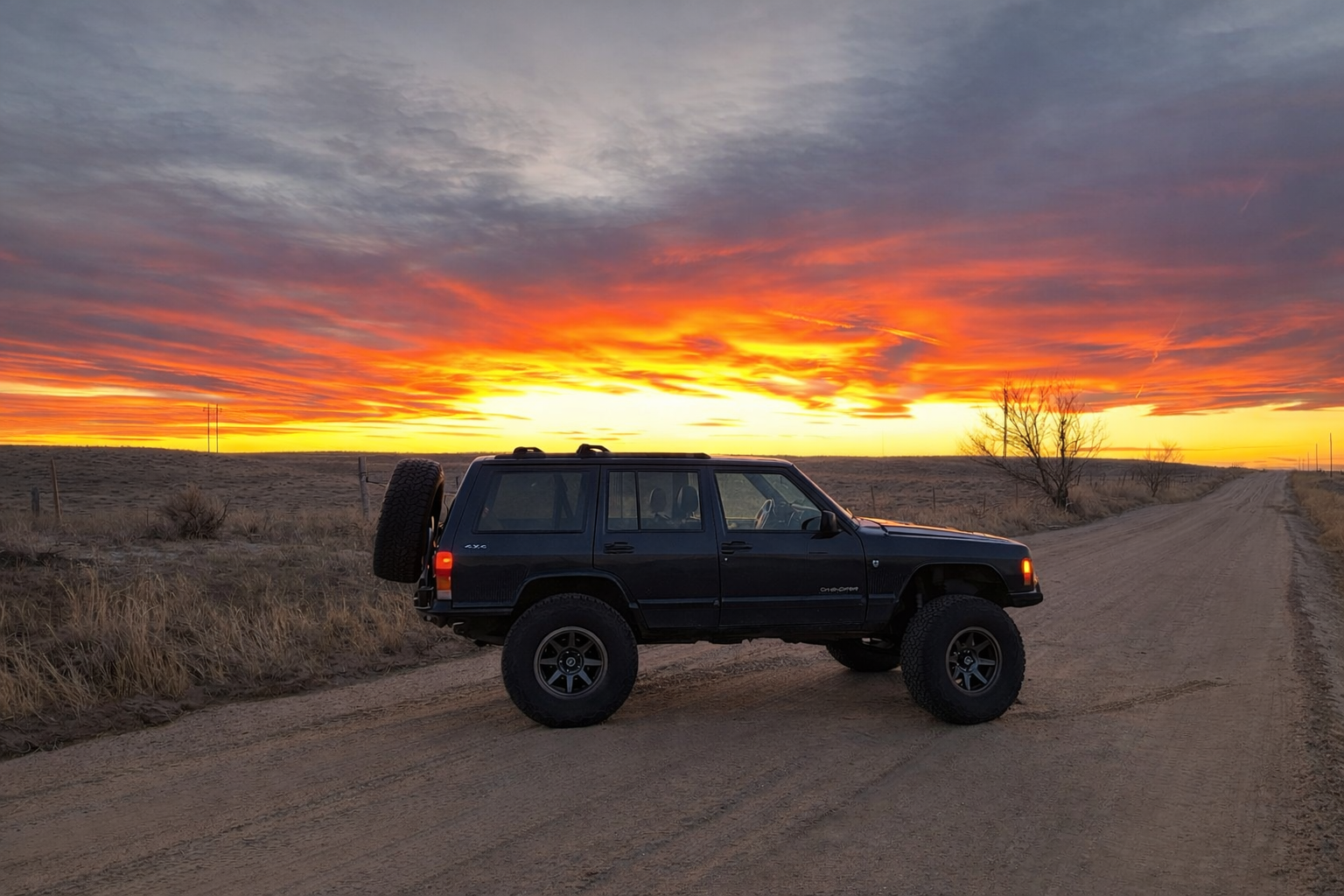

If anyone cares to see my other rig, the LS XJ, here it is. It’s a 2001 with an LQ4 6.0, 4L80 trans, NP241C t-case, ford 8.8 rear factory LSD, Dana 30 front with spartan helical LSD & WJ knuckle swap with Stinky Fab Aluminum steering, 4.10 gears, ~5.5” lift, frame stiffeners, icon rebound pro beadlocks, 35” BFG KO2s. -
