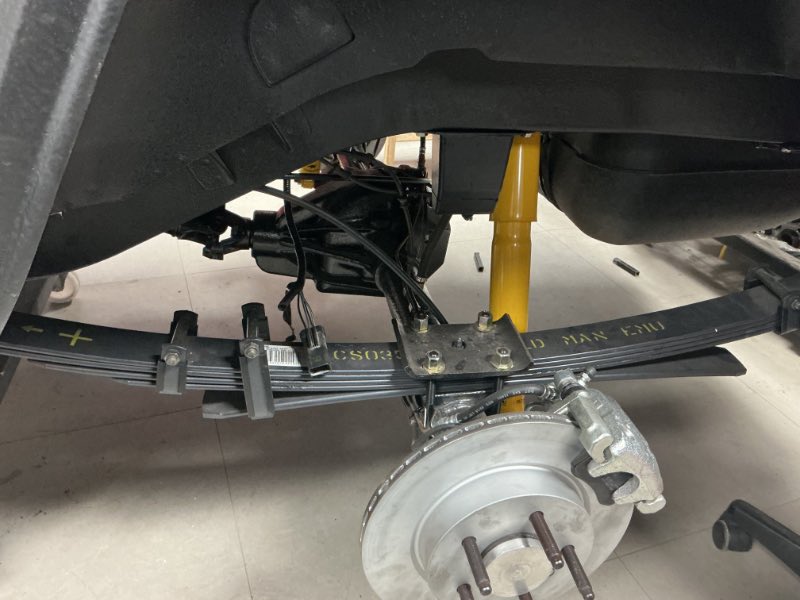

Caspar Posted Sunday at 06:46 PM Share Posted Sunday at 06:46 PM What kind of rear axle is this? 89 short bed 4x4 4.0 automatic Link to comment Share on other sites More sharing options...

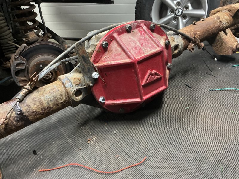

neohic Posted Sunday at 07:02 PM Share Posted Sunday at 07:02 PM Are there any common swapped rear axles for Cherokees in Norway? What does the differential cover look like? Link to comment Share on other sites More sharing options...
Caspar Posted Sunday at 08:02 PM Author Share Posted Sunday at 08:02 PM I think the cover is some custom parts. The axle look bigger than the 44 I have on my XJ Link to comment Share on other sites More sharing options...
neohic Posted Sunday at 11:55 PM Share Posted Sunday at 11:55 PM Looks to me like a Chrysler 8.25 diff cover from RT Offroad. https://www.rtoffroad.com/825-hd-differential-cover-rear.html I’d bet the axle is from a Liberty/KJ with the four little additional castings around the pinion yoke. Can you measure the axle tube diameter and overall width from outside of hub to hub? Link to comment Share on other sites More sharing options...
ThatJeepGuy Posted Monday at 11:11 AM Share Posted Monday at 11:11 AM That's a Chrysler 8.25 axle. Those 4 dimples are a simple enough give away. Its not from a liberty though. They have disc brakes and the casted nubs we pointed out would be drilled and tapped for the upper Ylink they have. The only dispelling XJ argument is even though those perches and shock mounts look correct for the xj application, it should have opposed shock mounts and not both mounts on the rear of the tube. The XJ application would be driver side rear of tube and passenger side front of tube (US driver/passenger) Unless someone customized the setup, cut and re-welded or replaced and welded the passenger side to the rear for the MJ setup? Unless its kind of an optical illusion the spring perches also look like they are just a tad crooked? Like they did in fact have an XJ axle put in the rear of an MJ but didn't move the leaf spring mounts and ran them as is with a bind. Link to comment Share on other sites More sharing options...
