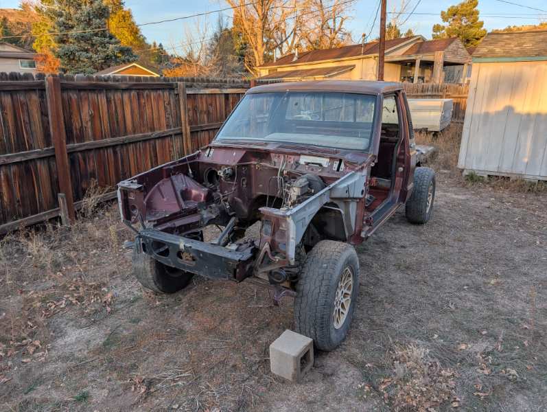

derf Posted November 12, 2025 Share Posted November 12, 2025 There really isn't much left of this one. It was at one point a 4wd 4 cyl short bed truck. Most of it is gone. But the chassis is solid and there's not much rust. So I'll be taking parts off my mostly complete but rusted out parts donor truck. It's going to get a Renix 4.0, and I have an AX15 to go behind it. I have both an NP242 and an NP231. I'm leaning towards the 242 but haven't made up my mind. A non CAD D30 will replace the 2wd beam it's sitting on now. And I have a factory MJ Dana 44. Most likely a 3.5" lift with some 31x10.50/15 tires. And 3.55s with TrueTracs front and rear. It's going to get a full paint job since the donor parts won't match. And the paint on it is pretty well shot. Likely something close to navy blue, with the burgundy interior. As it sits now: Link to comment Share on other sites More sharing options...
jdog Posted November 13, 2025 Share Posted November 13, 2025 BODY: JH61 BUILD: 09/26/86 SELLING DEALER: FOSTER AMC-JEEP MEMPHIS, TN *X8 CLOTH LOW-BACK BUCKET SEATS -H9 DESCRIPTION NOT AVAILABLE ADL SKID PLATE GROUP AGI DESCRIPTION NOT AVAILABLE APA MONOTONE PAINT AWE BCQ MAINTENANCE FREE BATTERY CAC LOW BACK BUCKET SEATS CGW CKA CARPET DGQ 4-SPD AUTOMATIC TRANSMISSION DMR 3.55 REAR AXLE RATIO EPD 2.5L I4 ENGINE GAC TINTED GLASS WINDOWS GFD REAR SLIDING WINDOW HAA AIR CONDITIONING HCC JAY DO NOT USE - SEE JP, KA CLASSES JGB JHA VAR INTERMITTENT WINDSHIELD WIPERS JJA CIGAR LIGHTER LMA HALOGEN HEADLAMPS MBJ BLACK BUMPER MD8 DELETE FRONT LICENSE PLATE BRACKET MWB TAILGATE NAA FEDERAL EMISSIONS NMB STANDARD DUTY ENGINE COOLING PYC QYC RAC OPEN SBA POWER STEERING SCE STEERING WHEEL SUA TILT STEERING COLUMN WJN ALUMINUM WHEELS XEA TOW HOOKS Link to comment Share on other sites More sharing options...
fiatslug87 Posted November 14, 2025 Share Posted November 14, 2025 It was a Chief. Link to comment Share on other sites More sharing options...
89 MJ Posted November 14, 2025 Share Posted November 14, 2025 12 minutes ago, fiatslug87 said: It was a Chief. Couldn’t have been a 4cyl then, correct? Link to comment Share on other sites More sharing options...
eaglescout526 Posted November 14, 2025 Share Posted November 14, 2025 1 hour ago, 89 MJ said: Couldn’t have been a 4cyl then, correct? I’ve heard and seen a lot of chiefs with 4cyls. Link to comment Share on other sites More sharing options...
fiatslug87 Posted November 14, 2025 Share Posted November 14, 2025 1 hour ago, 89 MJ said: Couldn’t have been a 4cyl then, correct? There are 5 Chiefs with 2.5L in the Registry, all '87. The H in position 4 indicates a 2.5L The S in position 8 indicates a Chief Link to comment Share on other sites More sharing options...
