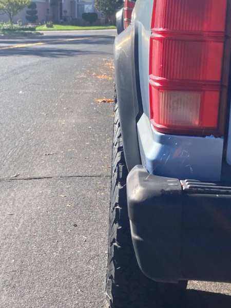

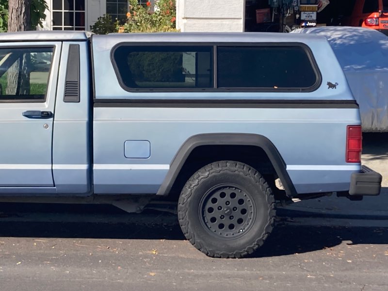

fiatslug87 Posted October 16 Share Posted October 16 On my 90 2WD with 2” spacers, no lift and BFG ATs 235/75/15. Tire not even with top of flare. Link to comment Share on other sites More sharing options...

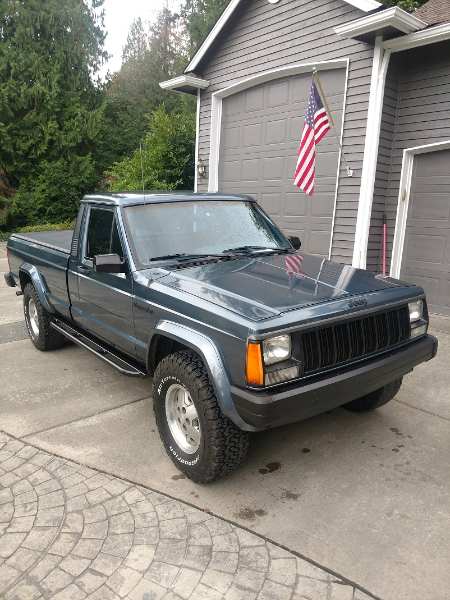

88towmanche Posted October 17 Share Posted October 17 Got spacers on mine - think maybe 1-1/2...have to look it up. Technically there is a puck n shackle 2" lift with but the old saggy leafs & springs it's probably just a bit above factory height. Link to comment Share on other sites More sharing options...

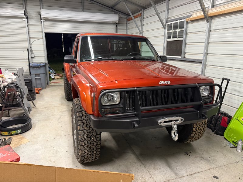

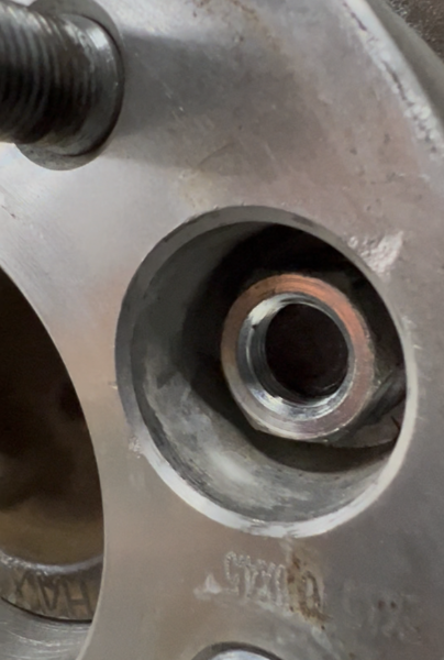

ghetdjc320 Posted October 17 Share Posted October 17 Here is a 1.25” front andapter along with a KJ liberty rear axle which is 2.5” wider in the rear plus a 3/4 wheel adapter. So basically rear is 2” further out in each side and front is 1.25. I have zero issues with this setup and a great turning radius. Link to comment Share on other sites More sharing options...
