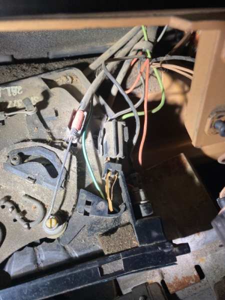

eaglescout526 Posted May 30 Author Posted May 30 We have AC!!! I hate the rudimentary system AMC used. Especially the micro switch. Smart but dumb. Relay would’ve been better. But I jammed a piece of wire in between the brass that lost tension and the plastic and it operates like it should.
eaglescout526 Posted May 30 Author Posted May 30 Im not proud of this fix but here’s the wire. I tested it and had to pull it back apart and taped the wire down to prevent it from moving out of the spot and jammed the terminal under the door cable. But it works and should for a while.

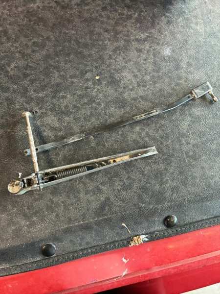

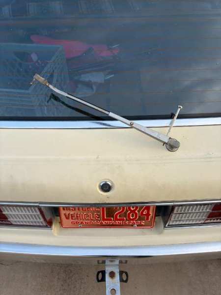

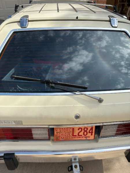

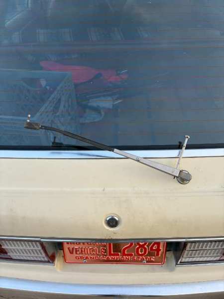

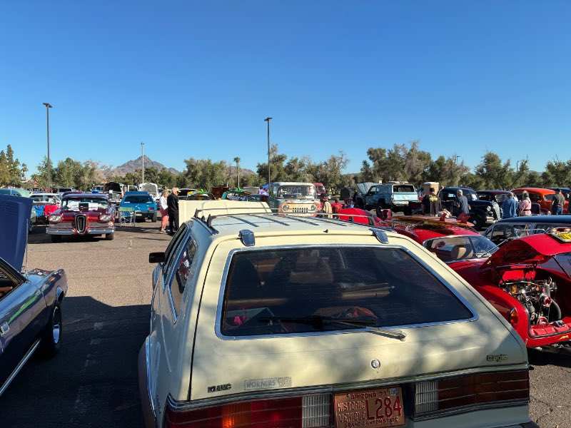

eaglescout526 Posted August 15 Author Posted August 15 The Eagle now has a rear wiper arm from an XJ!! So Carter and I went back and forth on this on what feels like forever. Debating on if an XJ rear arm will work. It does. Not the correct spline count but clean up the splines and throw some lube on it and it will go. Oh hey thats wrong. Its not going to wipe or sit right. So I drilled out the rivet, separated the fold Hammered out the bend and bent it to the other way, reassembled, with a self tapping screw of the small size to fit the holes. Clamped the fold back over. Voila!! It will now wipe the correct way. Hopefully other Eagle owners see this.
