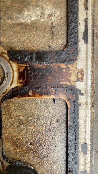

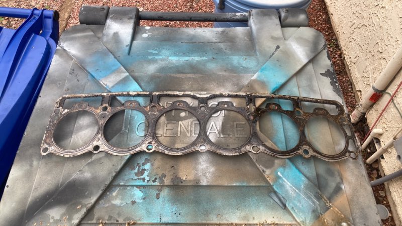

I didn’t think I was gonna be fixing a lot of mistakes and lack of maintenance on this car. However! I found something that eases my mind on the head gasket situation.
Thats a Chrysler/AMC part number. Now the J in the front tells me the head gasket has been done once.
Otherwise the gasket is blown at the coolant passages and was able to mix in with the oil.

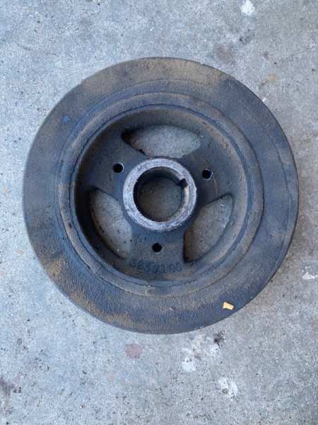

Here’s the original AMC balancer
Not in bad shape. It will need replaced in maybe about 60k. But right now it’s in good shape to put it back on.

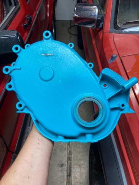

And here’s the timing cover
Decided to paint it closer to AMC blue vs black for the later years. Sanded the paint off the numbers and logo and it looks pretty good. Now im ready to start getting it back together.
Sand the paint off the timing marks as well it will make it much easier to see when you get it back in the car.
Wayyyy ahead of ya! Haha. I actually thought the same thing while I did the number and logo. That and the look of the numbers standing out looked pretty cool, two birds with one stone.
