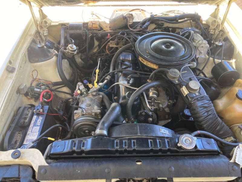

More I’m digging into emissions stuff, the more I’m finding that’s either weird from the factory that contradicts the diagram on the firewall and finding stuff that the POs removed to just get the car running and driving.
Luckily the stuff I’m missing, the PO of Chunk kept all of it when he simplified the emissions, those parts will be used here in this build/resto. So now I’ve gotta dig out the big ole box of carb stuff to start throwing parts at the Eagle and get the emissions stuff right so we can get it registered. Hoping it passes emissions.

Ok I’m getting there. Almost done with the vacuum lines. As it stands the previous owners deleted the emissions from the exhaust. Ok no big deal I’ll just work around that. I doubt they will look for what’s missing. They looked for what was an open port when I took chunk through with the TBI.
so I’ve got two open lines left. One for the sole vac which I need to get new and the other will probably go to an open port on the manifold. Is it correct? Maybe? Some of it still doesn’t make much sense. It all mostly looks factory and like it has accumulated 40 years of dust and grime but it could also be recent too. I need a good stock 86 to look at.
But I’m getting there! Hopefully a drive will tell me it’s all good to go.
I have some good news!
I got all the lines routed. Except one. Its for the Sole-vac. Once I get that the Eagle will be ready to fly. I took it for a drive, runs and drives better. Fixed the stalling issue it would have when turning or backing out, I knew that was gonna be vac related when the seller told me about that issue.

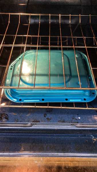

Ok so the TF727 decided it hated the RTV job the mechanics did when the PO had all the oil leaks "taken" care of. So decided to do a little googling, recalled somewhere that the TF could take the 42RE oil pan gasket. Picked one up from work, got the pan down, fluid was new and clean, might look into saving that and putting it to use in the engines. Painted it AMC blue cause I had some paint and I had to have it cure for a couple days and in the oven, wife wasnt too happy haha.
Got it installed tonight and no leaks!! Just the valve cover and steering remain as leaks.
Lol is that the kitchen oven? I wonder how safe that is:smokin:
Well failed emissions, running rich based on the numbers. Gonna try to lean it out and try again with the Carter carb before committing to a carb swap.

Hooked up one of the tachs I have laying around and got the idle and stuff dialed in.
Now to address its cooling issues as the coolant has turned brown. Probably some build up inside.

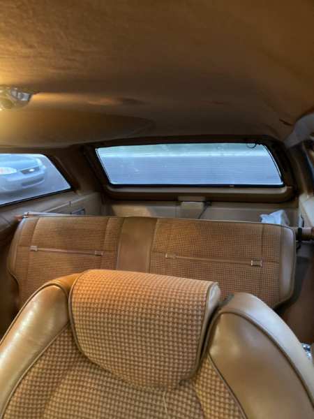

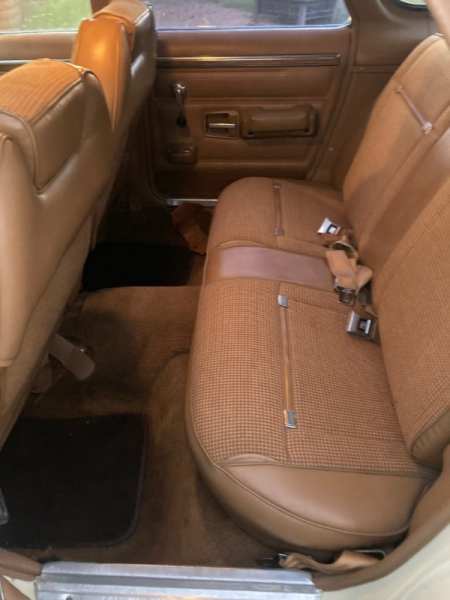

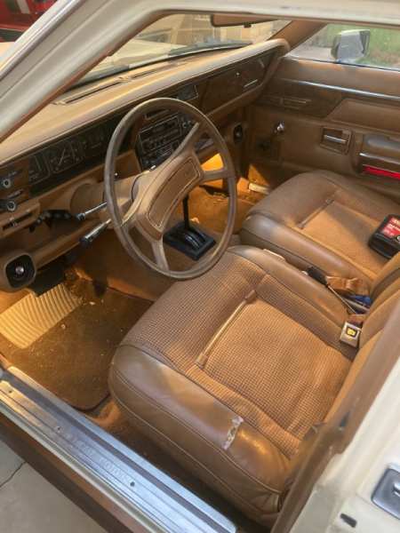

And for your viewing pleasure, the really pristine 140k interior.
The jets are probably worn out. The metering rods go through the jets and move every time the pedal is pressed down. That is the most likely cause you are running rich. You can move the metering rods down to help compensate for them wearing out but it only helps so much. The jets are usually numbered so just replace them with what is in there.
You can change the jets without removing the carb. Just remove the upper half of the carb and you will see the jets in the bottom of the float bowl. Unscrew them with a flat blade screwdriver then use a toothpick pressed into the middle of the jet to remove it.
I can see such but I am not entirely sure thats the case. One thing I did notice is that the PO replaced the carb for whatever reason with a rebuilt one from holley and I have what I can assume is the second carb for this car and the third is installed and running. As to what happened to the first one is unknown.
But both being rebuilt could be anything. There could be substandard parts in the carb and already have worn out. Carb couldve been sold as "rebuilt" but just had gaskets replaced. One thing I do not like about the carb thats in the Eagle is that it looks like the protective housings for the mixture screws are broken off.
