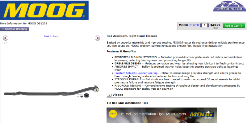

PIKE Posted August 26 Share Posted August 26 MOOG DS1238 Drag Link $ 43.99 at Rock Auto Link to comment Share on other sites More sharing options...

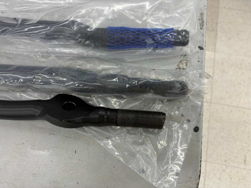

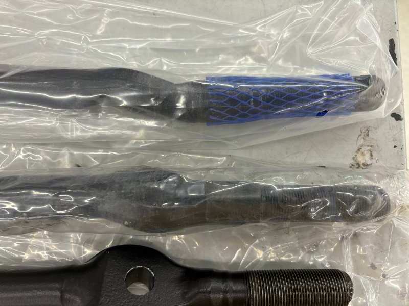

Gojira94 Posted September 7 Share Posted September 7 From bottom to top - Drag links DS1238, DS1311, DS1310: The most conspicuous difference is the steering stabilizer stud boss orientation. 1311 is rolled rearward a hair more than our 1238. The 1310 is rolled back even further. I can't see a way that this would matter at all, function or fitment. Tie rod stud boss is identical on all 3- .553" small side, .625" large side. Sleeve threading orientation to centerline of the drag link is straight on the 1238 and 1311. It's slightly canted to the rear on the 1310. The 1310 is .65" longer at the threaded sleeve end than the 1238, and the 1311 is .88" longer than the 1238. Link to comment Share on other sites More sharing options...
PIKE Posted September 7 Share Posted September 7 Nice, thanks for doing that. I can definitely see how the 1238 is beefier. It allows you to use the larger tie rod ends. The DS 1312 which is the tire rod for a V8 ZJ allows you to use the larger tie rod ends also. Link to comment Share on other sites More sharing options...
