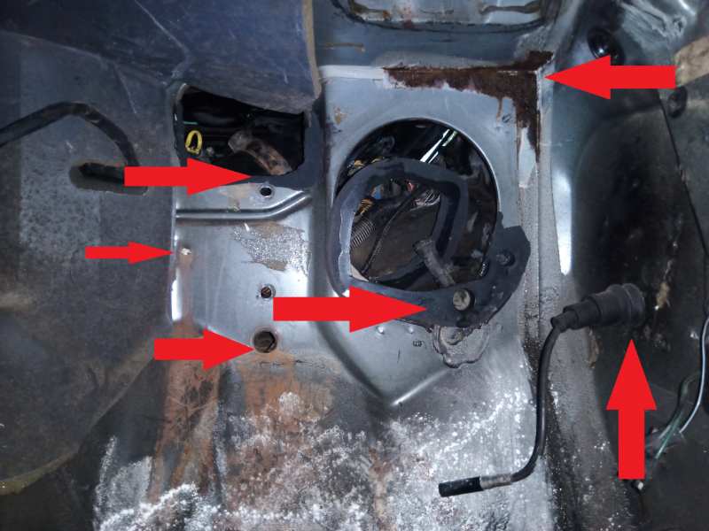

Pete M Posted August 6 Share Posted August 6 could be anything. bad door seal, failed windshield seal, failed antenna grommet, or any of the plethora of holes and gaps in the firewall. here are some I found in a recent truck repair: Link to comment Share on other sites More sharing options...
