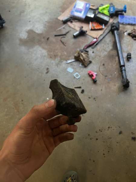

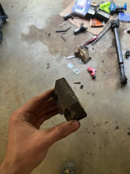

Anthi4078 Posted June 15, 2025 Share Posted June 15, 2025 I was putting a set of tow hooks on my truck today, and had to pull the steering gear to get access for a couple bolts. In front of the gear up against the core support was a big hunk of steel held down with 1 bolt through the bottom. It wouldn’t fit back in with the new bolts so I just left it out. I can’t find any mention of it anywhere online so I was just curious what the point of it is? Link to comment Share on other sites More sharing options...

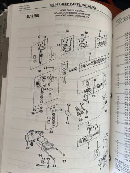

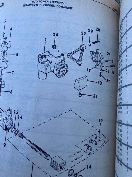

fiatslug87 Posted June 15, 2025 Share Posted June 15, 2025 It’s the steering box spacer, put it back. #30 Link to comment Share on other sites More sharing options...

Anthi4078 Posted June 15, 2025 Author Share Posted June 15, 2025 Ah so it does exist on paper! Mine does have power steering so I guess both types got it. Link to comment Share on other sites More sharing options...
fiatslug87 Posted June 15, 2025 Share Posted June 15, 2025 3 hours ago, Gjeep said: Stopped in HO era.. that's a piece of Renix history. Interesting, it still shows up in the 91-93 parts manual, #42. Link to comment Share on other sites More sharing options...

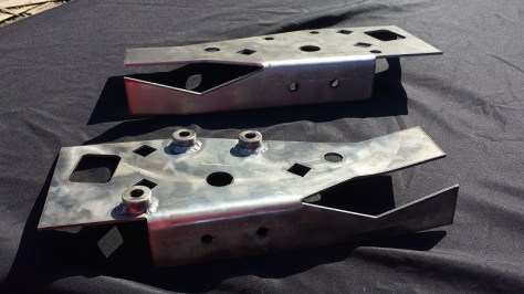

Htchevyii Posted June 17, 2025 Share Posted June 17, 2025 Funny, I just took that thing off when I welded in frame stiffeners inside and out. Although I've had the box out several times, I had never noticed it before, (it's a lot more obvious with the radiator out). It just has one small bolt holding it on, so I'm not sure what it could really be adding? I thought that it some sort of dampener like the ones that I've found in various places in 60's Chevys. Anyways, mine doesn't fit there anymore now. The T&M inner spacer/reinforcement looked like the best one to me. https://www.t-mfab.com/store-3/?model_number=4761900 Link to comment Share on other sites More sharing options...

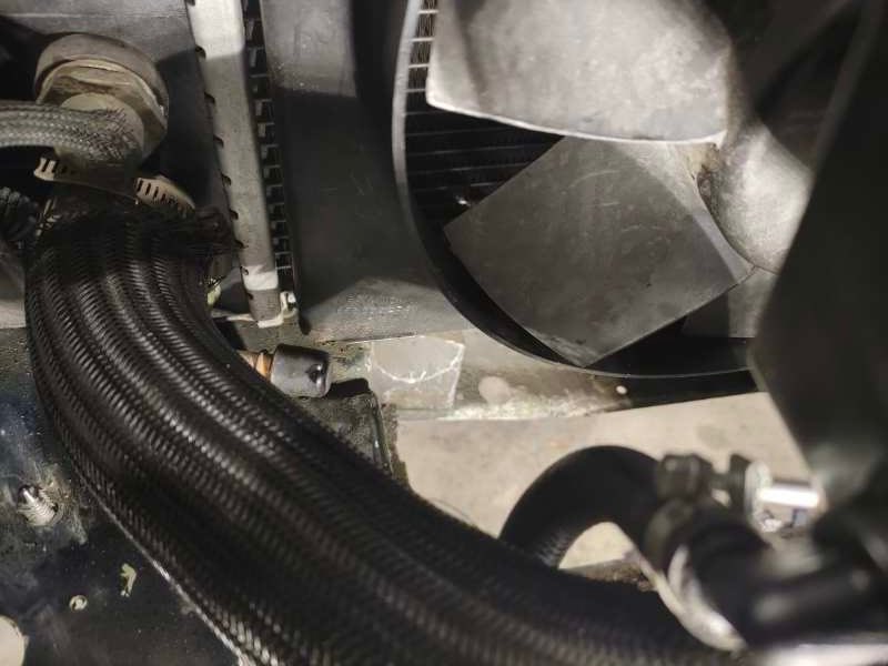

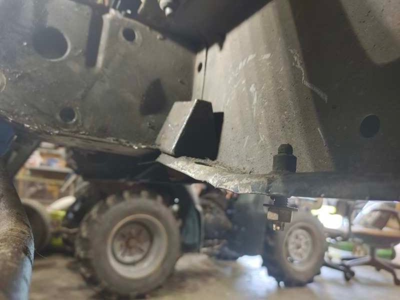

watchamakalit Posted June 20, 2025 Share Posted June 20, 2025 I'll look at mine again today while I pull out the leaky cardone unit to replace it with a lares..... Link to comment Share on other sites More sharing options...

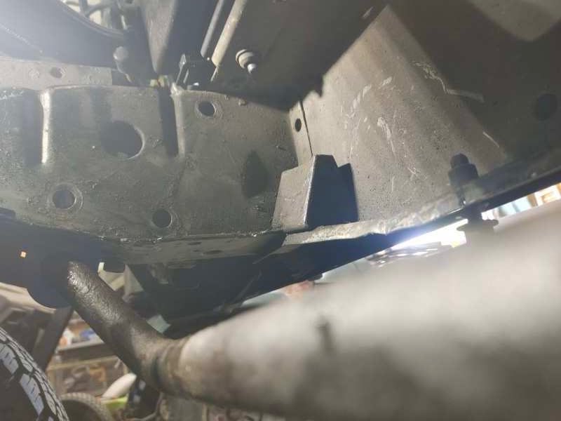

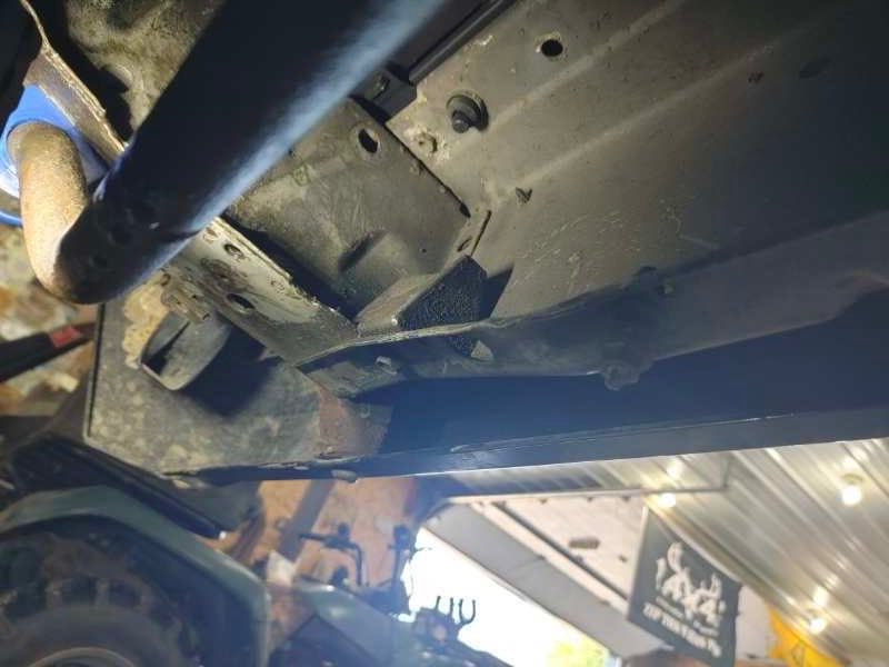

watchamakalit Posted June 20, 2025 Share Posted June 20, 2025 Look what I found..... I tried to document location and orientation for future reference. Link to comment Share on other sites More sharing options...
