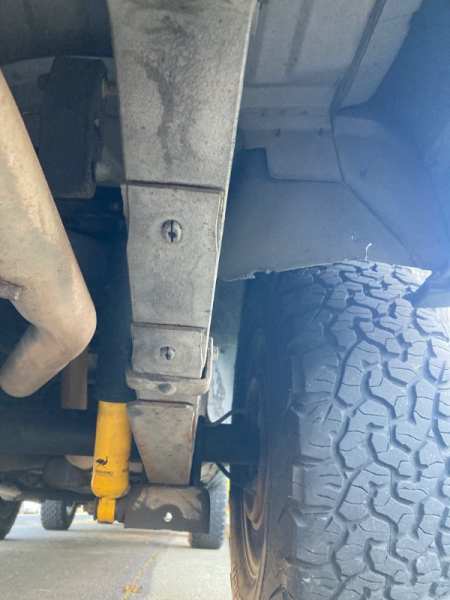

Ricky8227 Posted April 29, 2025 Author Share Posted April 29, 2025 Here’s a pic of the leaves from the bottom Link to comment Share on other sites More sharing options...
fiatslug87 Posted April 29, 2025 Share Posted April 29, 2025 Yeah, those are not MJ leaves, MJ leaves do not have those angled ends. Link to comment Share on other sites More sharing options...

ghetdjc320 Posted April 29, 2025 Share Posted April 29, 2025 Looks like a custom pack. No overload springs and all the leaves are about the same thickness. Good spring recipe Link to comment Share on other sites More sharing options...
