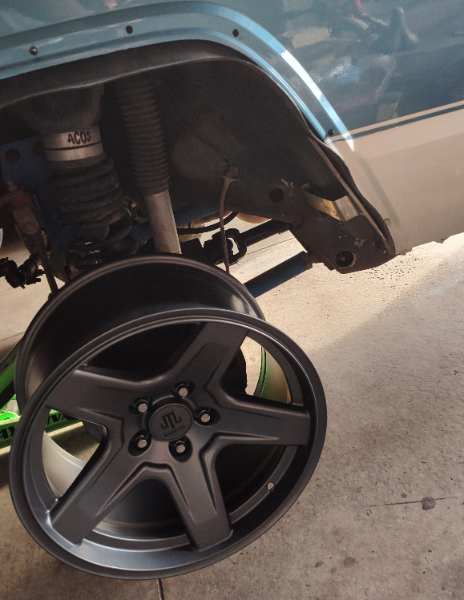

Eagle_SX4 Posted April 10, 2025 Author Share Posted April 10, 2025 33's here we come!!! Got some 17's that will go on once I get tires (285/70R17) and trim the fenders. The tires will not clear at the current ride height and I don't want to go much higher. I will probably end up going with the bushwacker pocket flares. The wheels are Mammoth Boulder's 17x9 5x4.5 4.5 backspacing. Link to comment Share on other sites More sharing options...
ghetdjc320 Posted April 10, 2025 Share Posted April 10, 2025 9 hours ago, Eagle_SX4 said: 33's here we come!!! Got some 17's that will go on once I get tires (285/70R17) and trim the fenders. The tires will not clear at the current ride height and I don't want to go much higher. I will probably end up going with the bushwacker pocket flares. The wheels are Mammoth Boulder's 17x9 5x4.5 4.5 backspacing. That’s a very wide wheel for the tire width. Looks nice though Link to comment Share on other sites More sharing options...
Eagle_SX4 Posted April 10, 2025 Author Share Posted April 10, 2025 58 minutes ago, ghetdjc320 said: That’s a very wide wheel for the tire width. Looks nice though I tried to find an 8 inch wide wheel but couldn't find one that I liked with enough backspacing. Most of the 8 inch wide wheels I found only had 3.5 - 3.75 inch backspacing. I am not worried about it. The new tires will have the same sidewall to rim clearance my 31x10.5's have on my 8 inch wheels. Link to comment Share on other sites More sharing options...
ghetdjc320 Posted April 10, 2025 Share Posted April 10, 2025 36 minutes ago, Eagle_SX4 said: I tried to find an 8 inch wide wheel but couldn't find one that I liked with enough backspacing. Most of the 8 inch wide wheels I found only had 3.5 - 3.75 inch backspacing. I am not worried about it. The new tires will have the same sidewall to rim clearance my 31x10.5's have on my 8 inch wheels. It’s the bead that can present a problem. But it should be fine so long as you don’t air down much when off-road Link to comment Share on other sites More sharing options...
Eagle_SX4 Posted April 10, 2025 Author Share Posted April 10, 2025 1 minute ago, ghetdjc320 said: It’s the bead that can present a problem. But it should be fine so long as you don’t air down off-road. I will keep that in mind. Link to comment Share on other sites More sharing options...

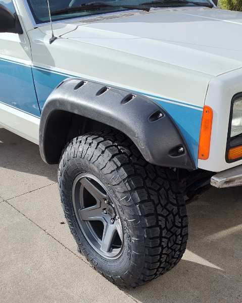

Eagle_SX4 Posted April 29, 2025 Author Share Posted April 29, 2025 I am impatient and couldn't wait, so I got some new 33's (285/70r17 on 17x9 wheels with -6mm offset about 4.75" backspacing) fitted with some bushwacker pocket flares everything seems to fit nice. I have 1.5 inch of lift in the front and no lift in the back. The tires would not have cleared the front without these flares. I think the rear may have been fine with the factory flares but I put the bushwacker flares on the back as well. Link to comment Share on other sites More sharing options...
