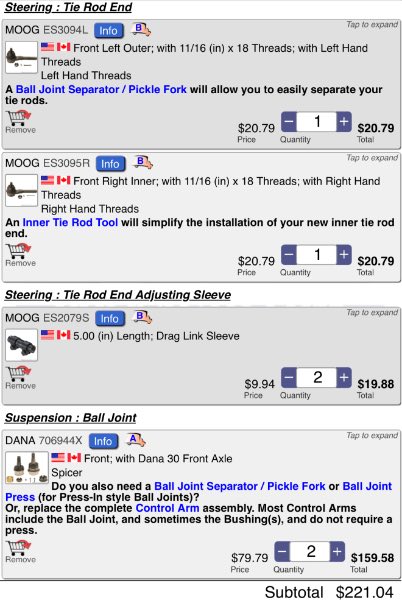

If you’re not upgrading the tie rod to the ZJ version then this is what you need (see pic). The parts below don’t replace the drag link which has a tie rod end integrated for the passenger wheel. If you need to replace that too than add Moog part number DS1238. Spray your ball joints with some PB blaster or similar a couple of times a few days before you’re planning to remove them (or have them removed by a mechanic). If you’re going to remove them, you’ll need a good quality ball joint press (OTC makes a great one) and the appropriate Jeep adapter cup. It can be done using other methods/tools but I’ve never had any damage to the inner C using the above tools and new stock replacement ball joints went right in place without issue.
you shouldnt need adjustable ball joints and you wouldnt know which ones you needed unless you went to an alignment shop and they said you needed them as thats the only way camber is adjusted on the jeep axle.

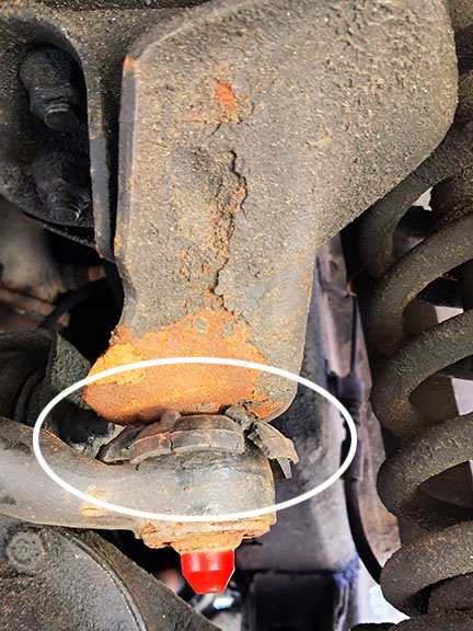

I did some poking around today and basically found nothing. Had the front end on jack stands, my son turned the wheel back and fourth and nothing seemed to be wrong. No clunks or creaks, nothing looked or felt sloppy. I have little to no movement with the ball joints using the "pry bar under a tire" method. The only movement I found is illustrated here:
No movement in the ball joints is good news. That will save a headache and some money. The parts that you took pictures of are your sway bar end links in the first picture and your sway bar bushings in your second picture. The good news is that those are fairly cheap and easy to replace. I don't think that I will be the source of your troubles though. The job of the sway bar is to control side to side lean in corners for the most part, so in the grand scheme of things, it isn't necessary.
You could pull the sway bar and end links off and then drive it a little bit to see if that fixes the issue, but be warned, the handling will be a little funky. If it cures your problem, then order the sway bar bushings and end links. If it doesn't fix the issue, maybe try the test again with the vehicle's weight on the ground.
Really, it looks like you need end links and bushings either way, but I don't think that it is the cause of your issues.
