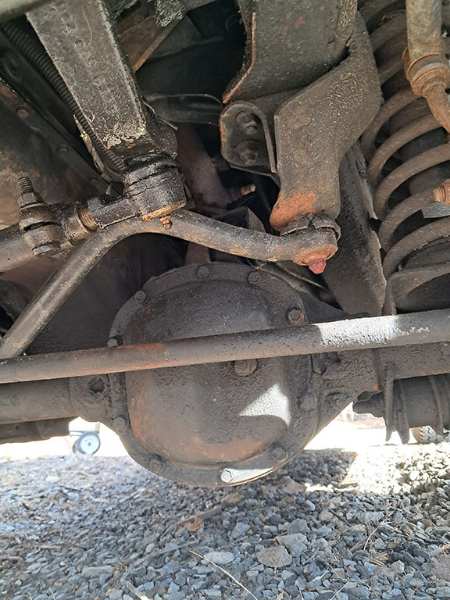

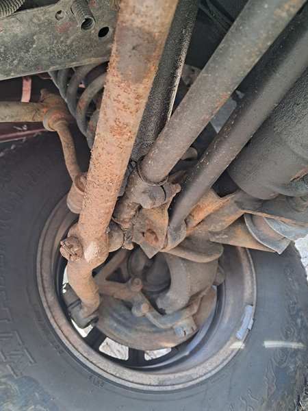

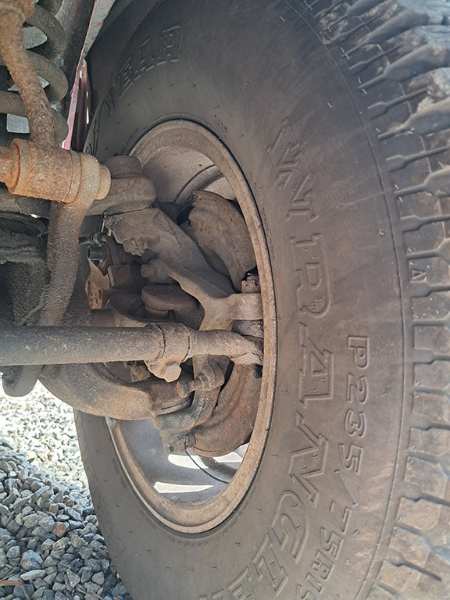

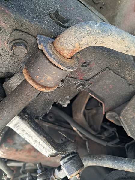

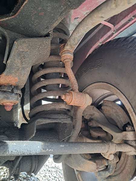

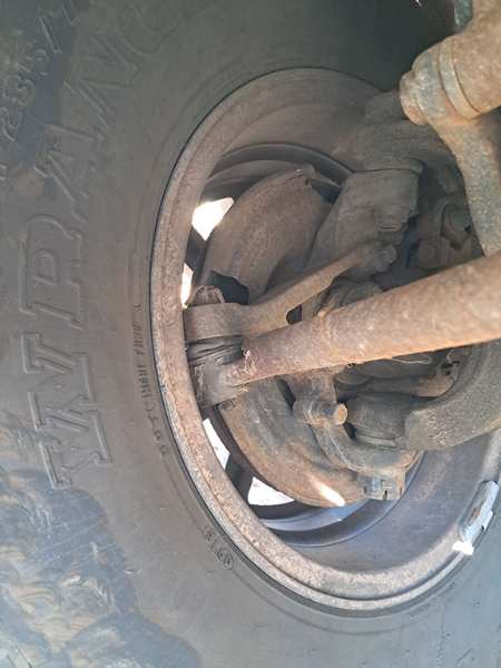

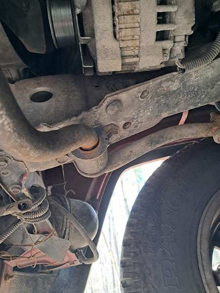

Okay folks. I'm going to be a lazy slob and ask you fine folks to look at these images and point out anything that looks suspect.
I would say a bushing kit may be in order.
Lots of this stuff needs a visual inspection while the steering wheel is being rocked back and forth or grab each suspension component and try to move it. There should be no play. These are just guesses, but it looks like you need tie rod ends, the body side of the track bar joint, and at least the steering box side of the drag link.

i can tell by the rust on the track bar joint thats bad.

It depends on how long they’ve been without grease. I’d say that you’re probably in need of all new joints. The sway bar bushings and track bar joint definitely need replacing though.
Based on the amount of fluid on your pitman arm you might want to make sure your steering box isn't bad. Check the fluid first see how much you lose over time.

I can see from the photos that the sway bar bushings where the bar attaches to the chassis need replacing.
the chassis end of the track bar is junk as well.
All the other steering linkage stuff cannot be ascertained without doing the “rock the steering wheel back and forth” test while holding/feeling each joint.
Contol arm bushings need a close inspection with a flashlight to look for cracks or permanent deformation.  Keep in mind that, unless those arms were replaced or rebushed some time in the past, you are rolling around on 30+ year old rubber suspension joints, and that almost guarantees that the bushings are just flat worn out.
