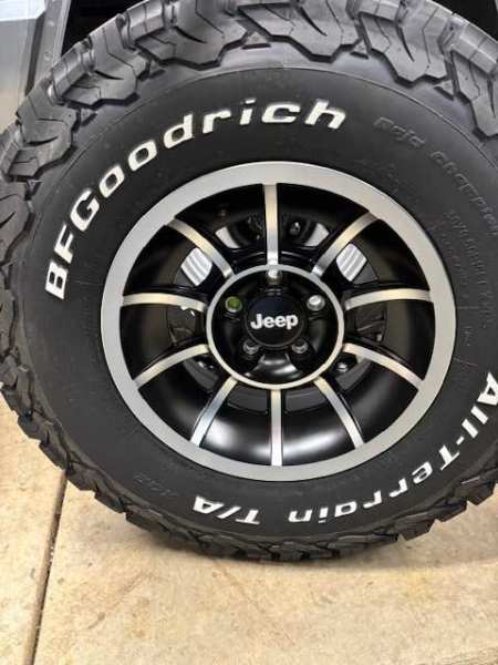

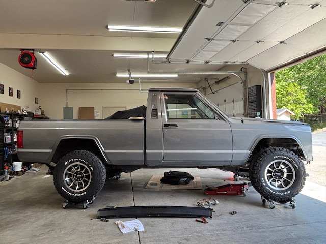

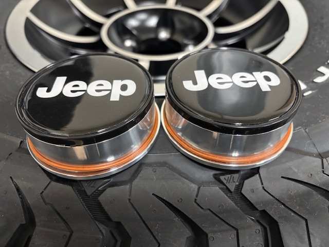

I’ve had a set of American Racing Vector rims since 2006, deciding if I wanted to go in the direction of a Comanche Chief for my now sold red ’89 Comanche. Indecision and the center caps were the problem... I’ve never liked the aftermarket center caps of old that stick out 3 or more inches like Pinocchio’s nose. Fast forward to present day and I unearthed these rims from the parts shed, dusted them off and decided to figure out the center cap issue as I’m going Chief on my silver ’91 MJ build. Lots of searching and buying various products brought me to this cobbled stubby center cap combination. There’s a ‘80s Buick GN repop company that makes new centers for the old Buick’s Vector-like rims, which thank fully have the same odd diameter as the American Racing rims (my guess in American OEM’d them for Buick). The 2004-2012 Nissan Titan/ Armada had an 85mm OD/ 78mm ID center cap that fit near perfectly into these GN centers, and the online 3D center caps vendor supplied the Jeep logo’d emblems (needed to be 80mm to fit the Titan caps properly). Finally, the original American Racing Vector rims supplied center cap rubber band-ish ‘bushing’ to properly seat the center into the rim without rattle. Done. Just took a little patience. Also decided to go with BFG 30's versus the 235's I had purchased for the OEM steelies.
The past month I’ve been buried in house projects with the latest MJ build taking a back seat. Hoping this weekend to paint the rocker areas the necessary matte black to match the Chief decals I recently purchased and trimmed-down from Graphics Express. Temps are rising here in Oregon which is a good thing. The aim is to lay the Chief graphics down by end of the month.

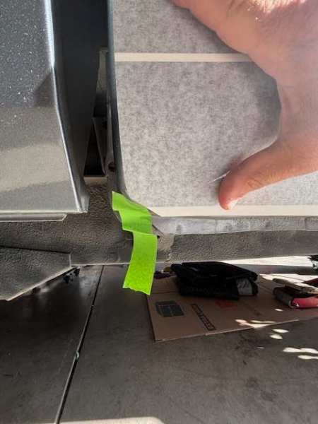

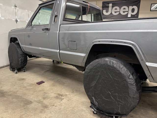

From all the research I’ve done going through photos on the internet of factory original/ not repainted Comanche Chief’s, the rocker area of the MJ was not painted matte black to blend in with the decals. The reason I got to digging is that I noticed when prepping the decal set on my other MJ, the decals land about 1/8-1/4” from the bottom of the visible rocker depending on the body panel. I just don’t see that looking right… as I’ve seen several redone Chief’s on the internet also that did paint that rocker area prior to laying down the graphics – and it looks more finished. Interestingly enough, the XJ Chief did have the rocker area painted matte black from the factory. So, I’ll be painting a soft line 1/2" up from the rocker area ending in-line to where the end lowest point of the decal falls. Currently working on the prep to get me there, degreasing, sanding, etc. Aiming to paint rockers this weekend.

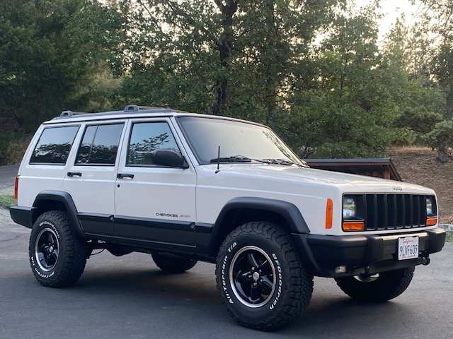

Back before I moved out of California, I was in an absolute tear to finish up my youngest’s XJ. I tossed the scab wheel/ tire combo that I typically used in paint, and needed to find some tire covers that would protect the good wheel/ tire set when I painted the lower area argent (Below’s a pic of the XJ since I never created a build on this site as I did with the others.)… and these covers worked great, fit up to 32” tires, and were $21 for a set of 4. Will be using them again on this MJ.
