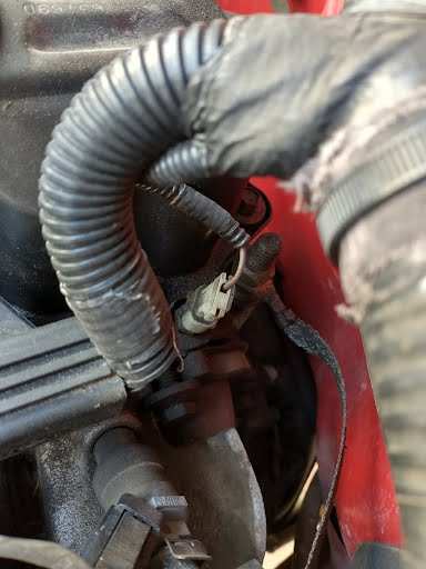

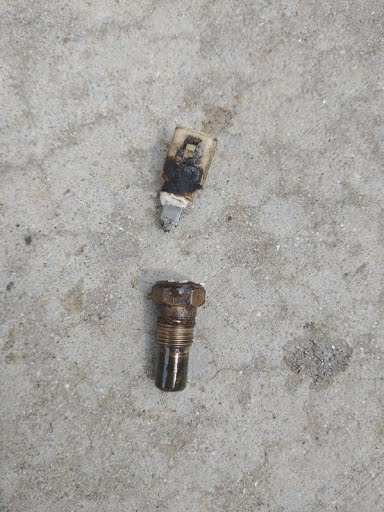

Temperature gauge on the dash hasn't worked since we purchased this vehicle. Tried replacing the temp sensor on the thermostat housing with no change and then learned that was the wrong one. So tried replacing the temp sensor at the back of the block. That turned out to be a surprising pain in the rear... and the gauge still doesn't work. :fistshake2: Should have been a warning sign when I read that the sensor is easier to install if the valve cover is taken off first. :(

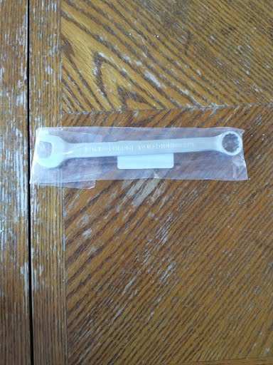

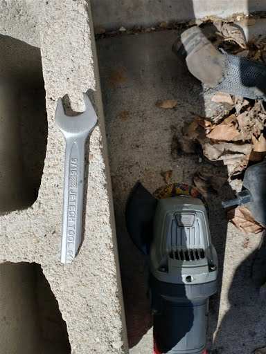

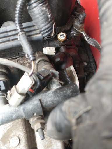

The problem is that the stamped valve cover on '96+ has a vertical lip around the edge that won't let a socket or wrench sit on the hex part of the sensor. I snapped the old sensor off, which was no problem because I was replacing it and figured it was weak, which was why it didn't work anyway. But I didn't realize the valve cover lip was an issue until I snapped the first brand new sensor in half too. :brickwall: Ultimately ended up buying the cheapest 9/16 wrench I could find on Amazon and cutting it up to make a tool that kind of worked getting on 3-sides-ish of the hex. I got the sensor about halfway in before the corners of the brass hex portion of the sensor started to round enough that I didn't dare to further. I got it in far enough that it doesn't leak, so I considered that victory enough and quit. If the part manufacturer made the brass hex portion of the sensor taller, then this wouldn't be difficult at all. Haven't checked to see if this is as big of an issue on older valve covers.
Location of old sensor at back of block
Old sensor broken in half
First attempt at installing new sensor. Broke it in half. Note the valve cover lip on the back side of the sensor. Once screwed in a little, a socket will no longer fit and are lucky to barely get the open side of a 9/16 wrench on it. But then the firewall and wiring harness get in the way.
Cheap 9/16 wrench that I cut up to make a tool to install the sensor.

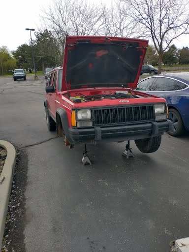

In other news, drove the Jeep to work, came out later and the starter had given up (at work). So got to replace that in the work parking lot the next day.

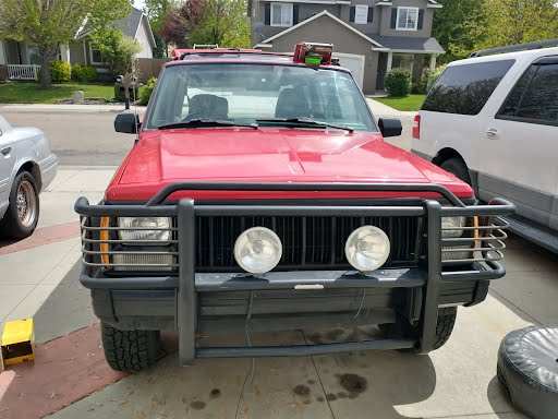

Then last but not least, added some Grille decoration this weekend. Bought it used with the Hella lights on it. Haven't hooked them up yet.
